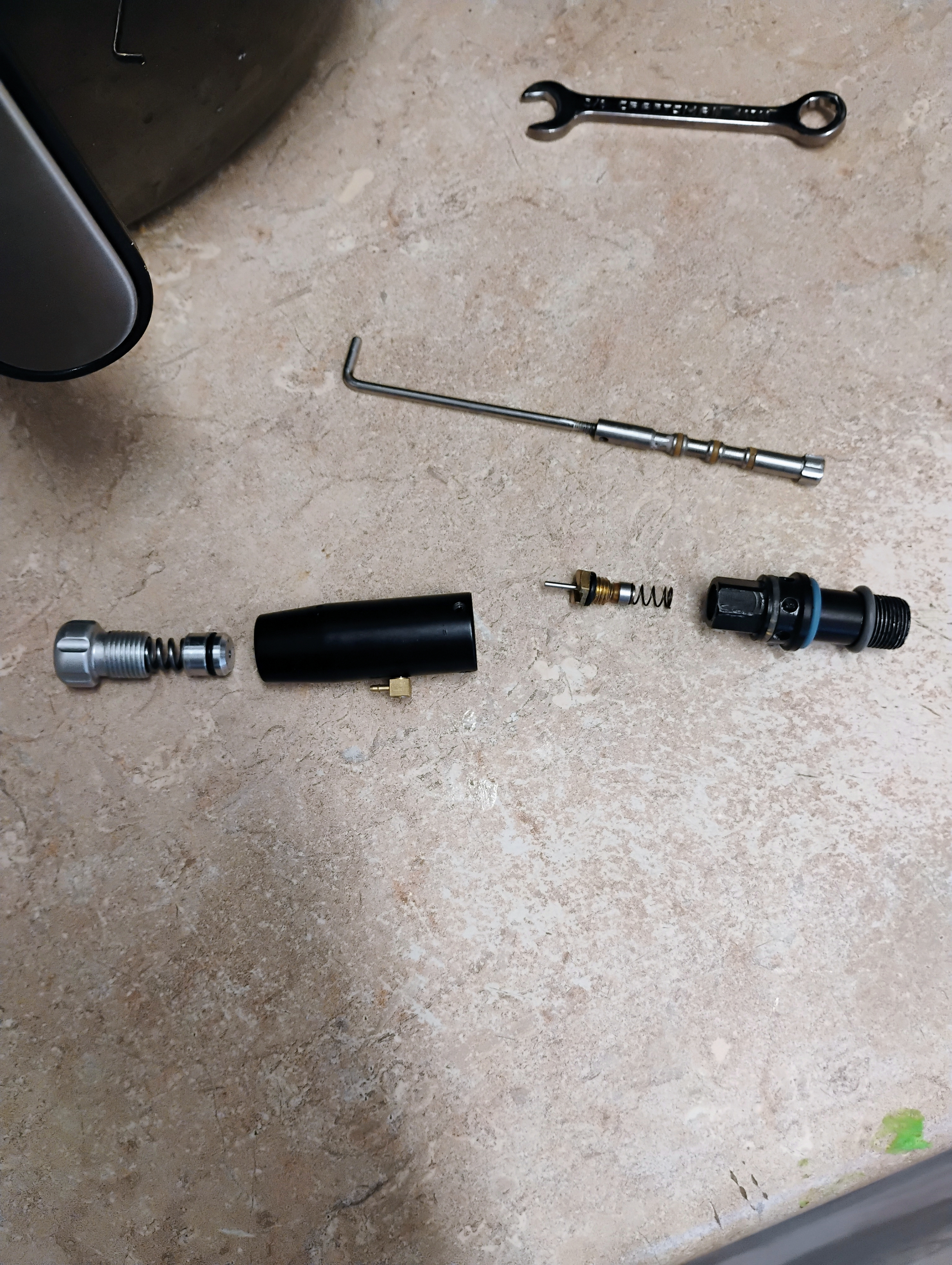

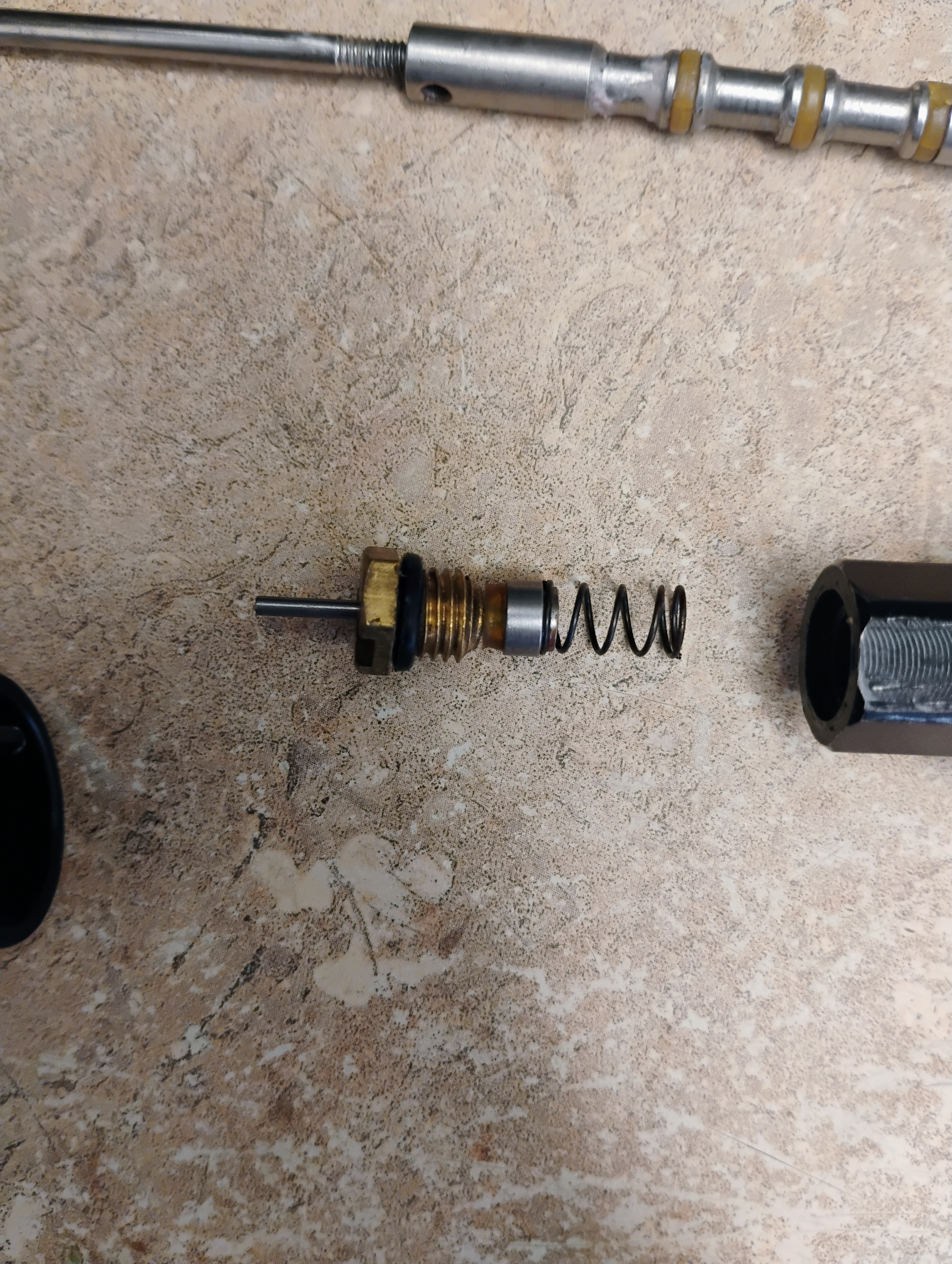

    • Psycho91
      • 1243
      • Lexington, SC

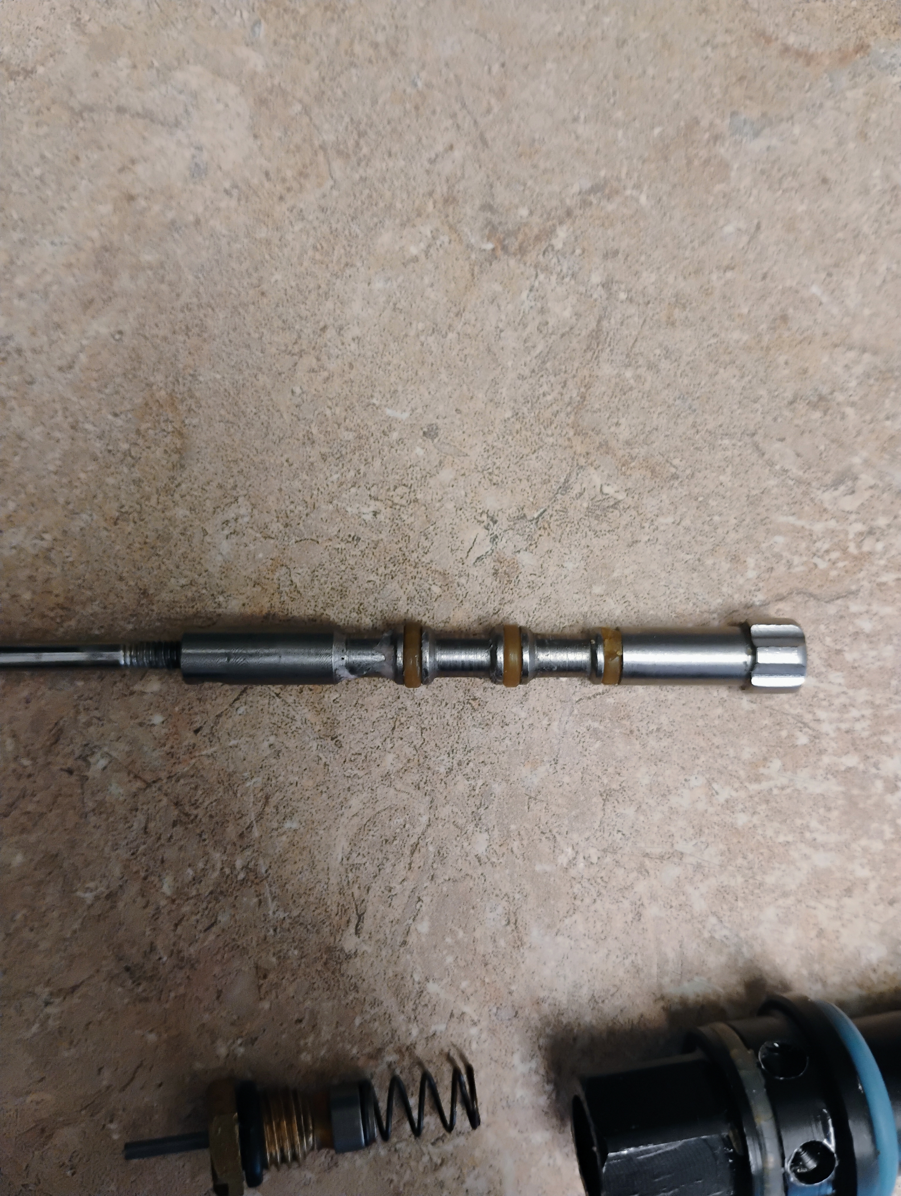

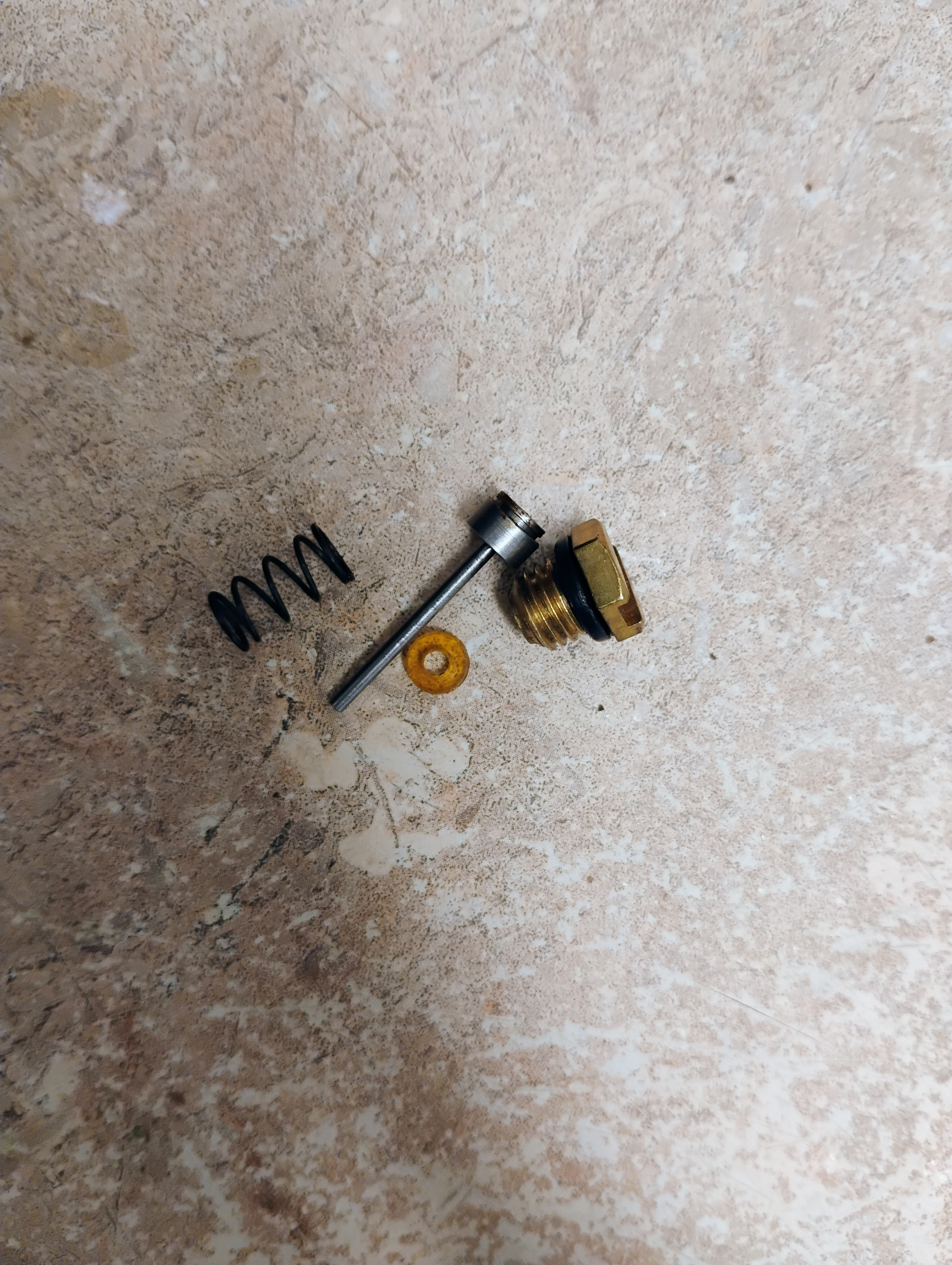

      This is what the guts look like, looks like a shrader valve kinda
      And the 3 way shaft is huge
      • latches109
        latches109 commented
        003 70d on 3way. The schrader is 011 and piston was 011 or 012 I forgot. It’s been a while but 010,011,012 should get the job done

      Looks like I might just have to get a tech matt with the oring sizes on it and order some for a rebuild the only thing I'm worried about sourcing is the reg seat
        Cdn_Cuda commented
        I use my oring sizer often. Very handy! I like the magnetic ones as well. Keeps thing from wandering.
      I. Am. Canadian. 🇨🇦
      • 3507
      The reg seat looks an awful lot like a Rock/Stab setup. Wouldn't surprise me if that would work.
      • Psycho91
        Psycho91 commented
        Thanks Jordan I'll go do some googling and take a look myself

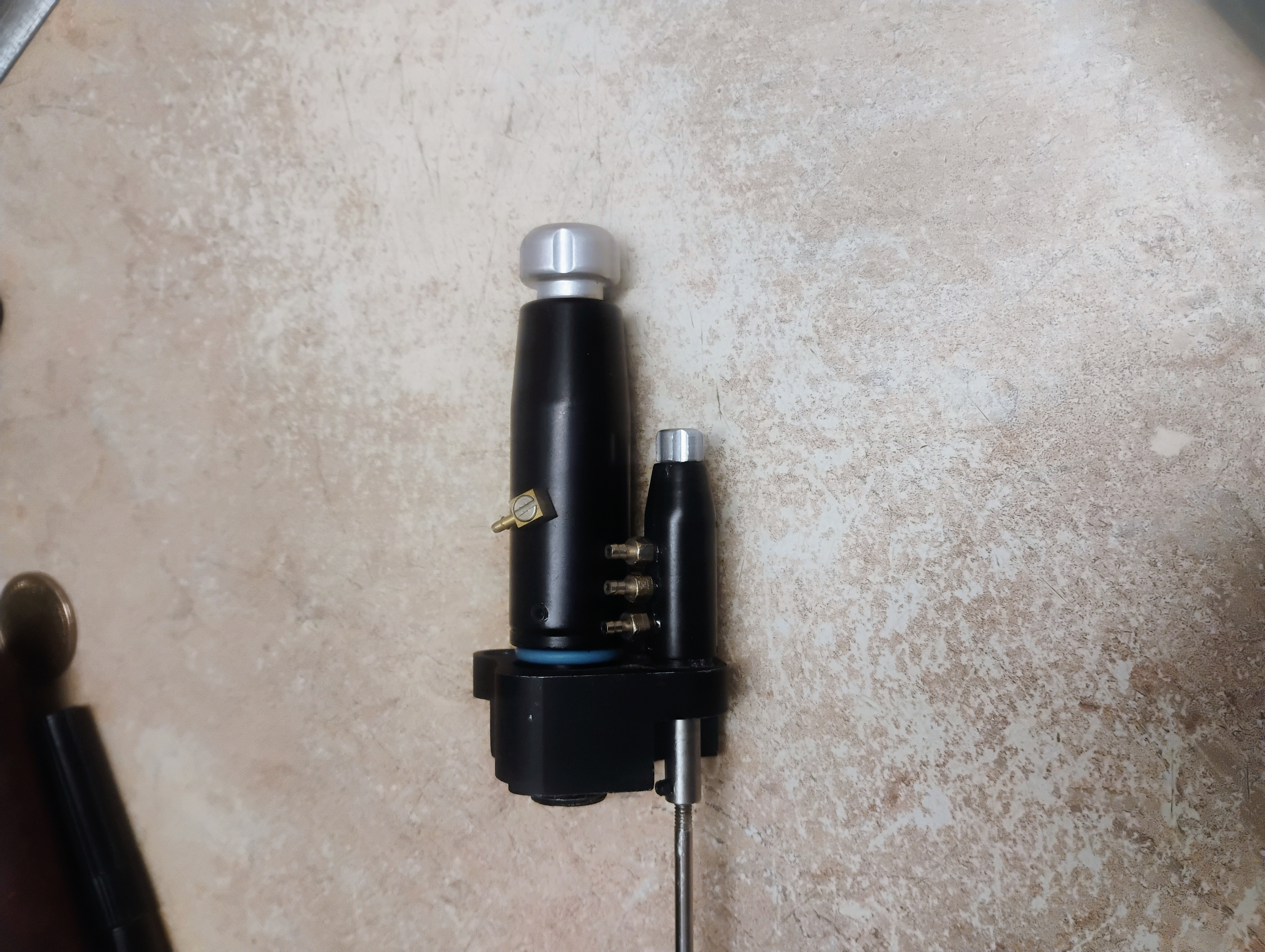

    • Blackmagic71
      • 906
      On a side note: I always thought the front of these three ways was a decorative design choice, but it looks like it was made to give a place to grip it and twist it on/off the actuator rod.
      Seems like a clever idea.
      • Psycho91
        Psycho91 commented
        Yeah I thought the same thing my self even if the thing is massive

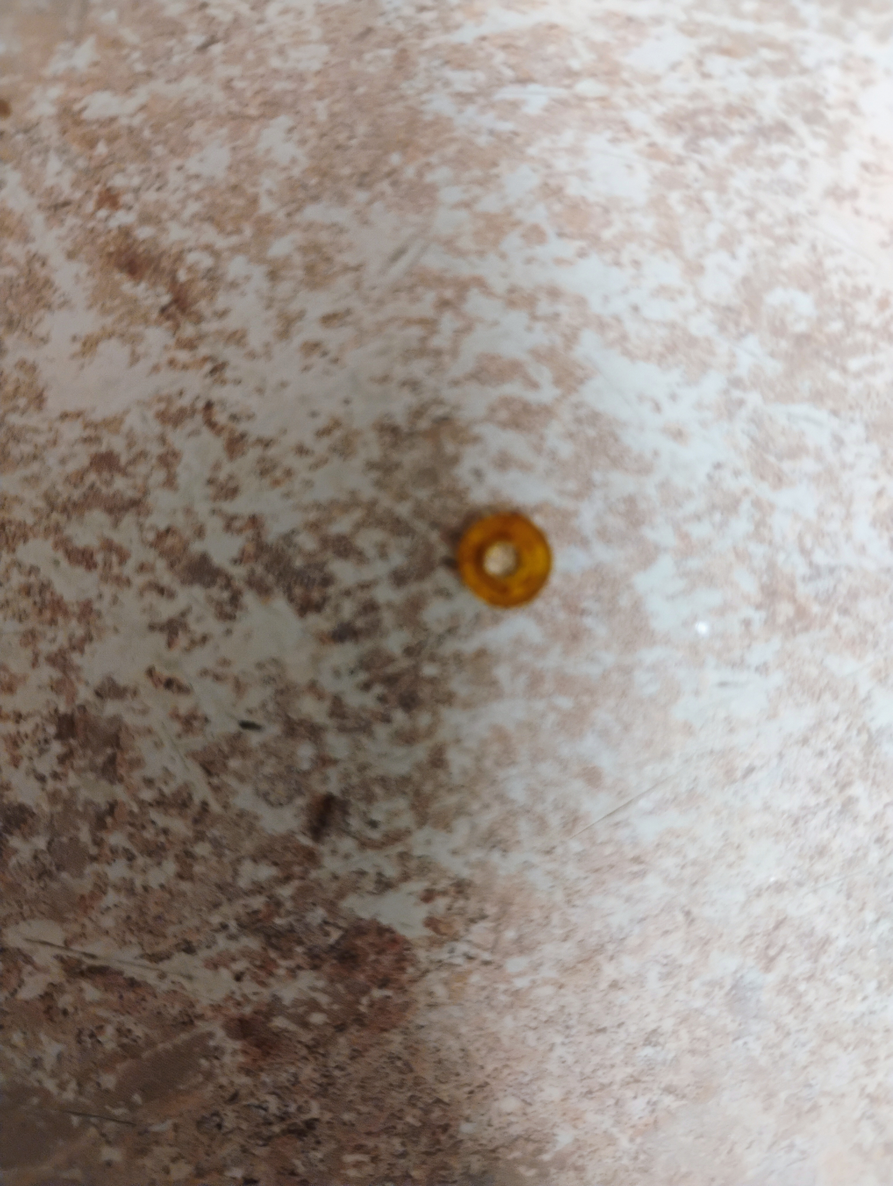

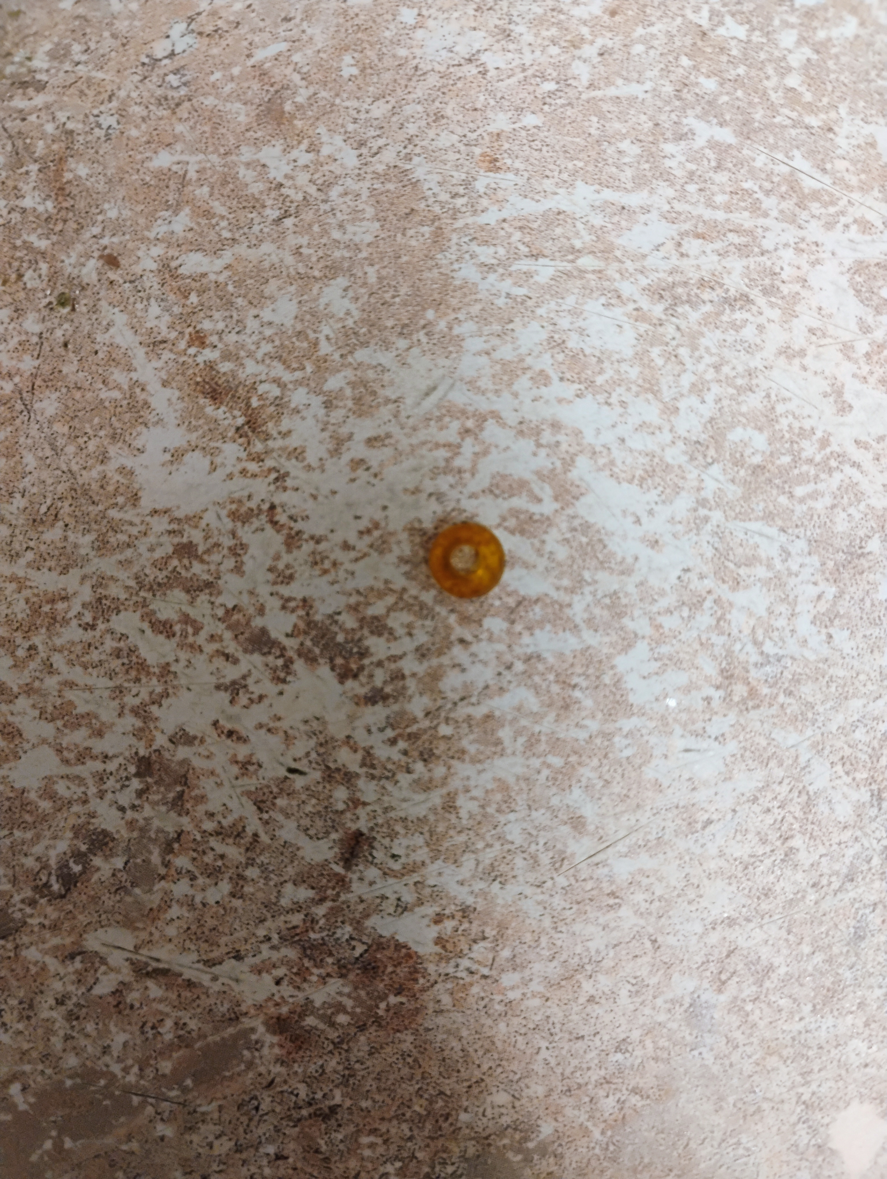

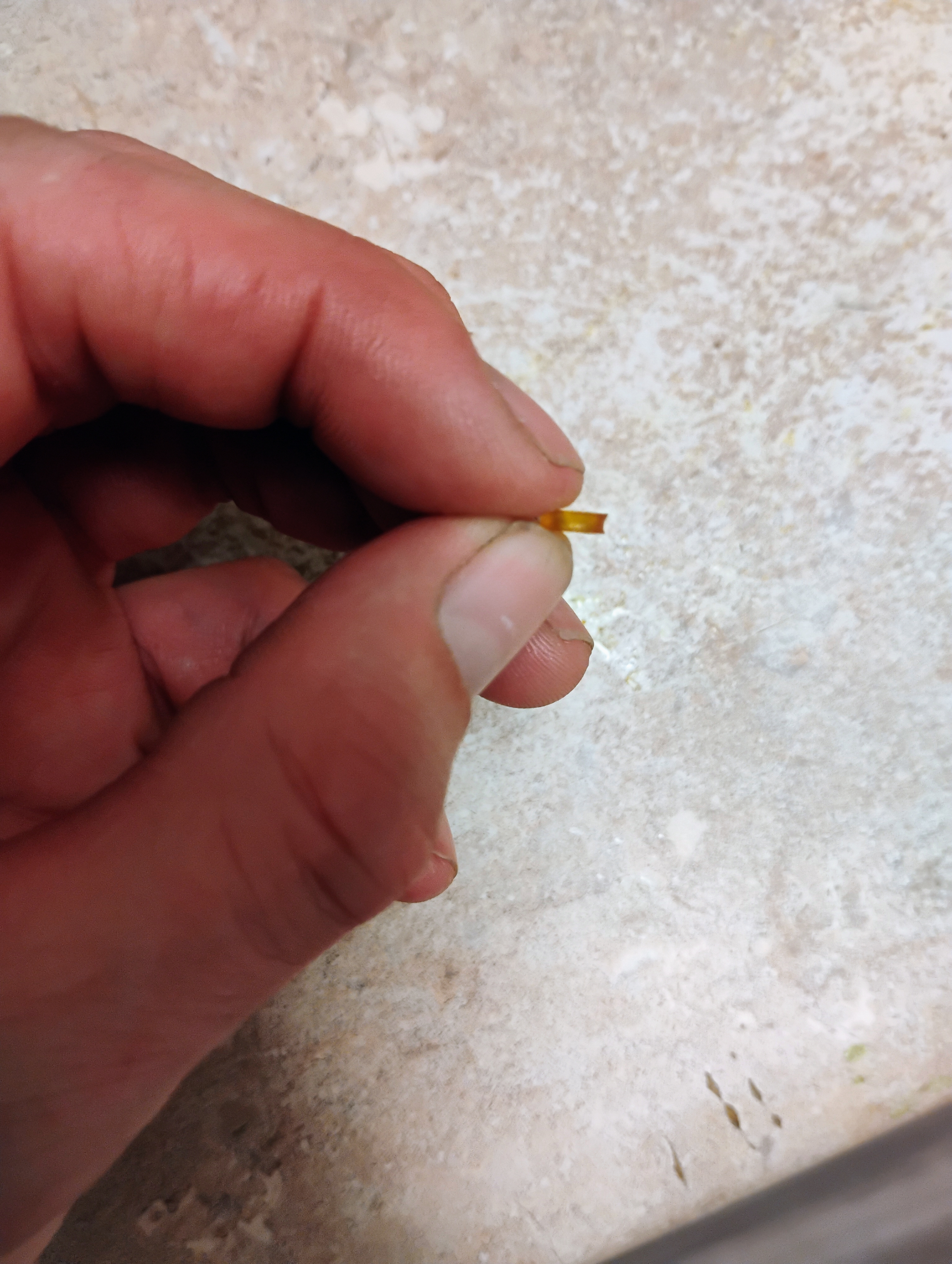

    • Psycho91
      • 1243
      • Lexington, SC
      This is what the reg seat looks like, it really just looks like a thick urethane 12 gram seal but I know its not lol
        Jordan commented
        Imagine that in black, and you've got a Rock/Stab reg seat.
        https://palmerspursuit.com/products/...e6a85426&_ss=r
      • Psycho91
        Psycho91 commented
        Thanks I'll try that, the one I have may be good but I just want to replace it for safe measure just got to figure out the oring sizes now
      • latches109
        You can use 006 in a pinch
    • Psycho91
      • 1243
      • Lexington, SC
      Well I hate to say it but ol cocker top goofball knew all the sizes and even said that ans reg seats will work in this so that means mag reg seats will work as well right
