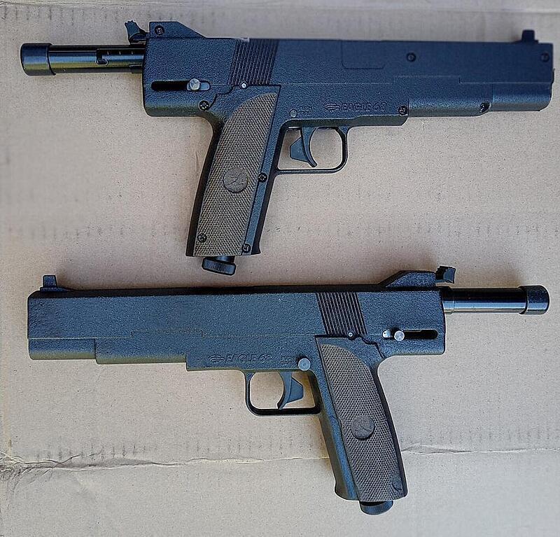

          Here is a bit of lubricating nostalgia for you, back in the 90's, Brass Eagle, for lubricating it's "Eagle 68", recommended Transmission Fluid!
          Here are my 2 heavily modified/restored Eagle 68 Pistols, not lubricated with Transmission Fluid!
