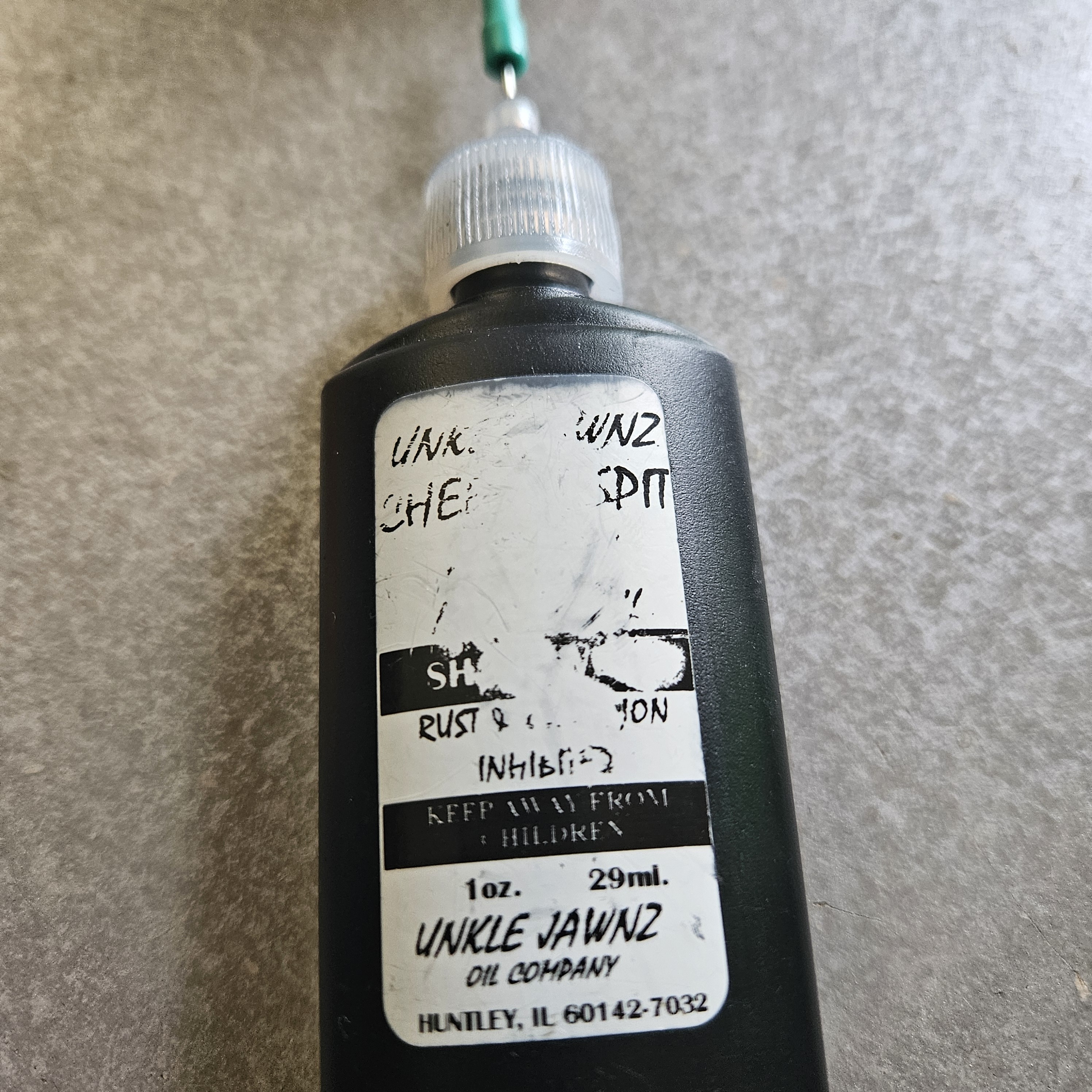

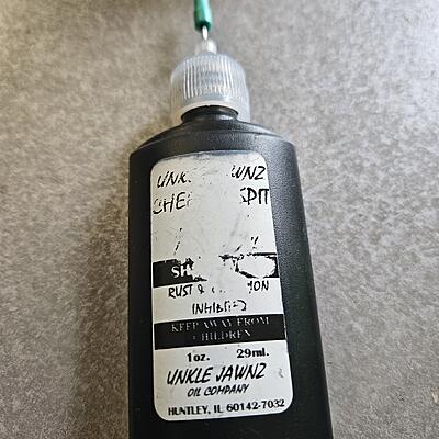

        I have a bottle of "UNCLE JAWNS CHEETAH SPIT" that I've been topping off for 10+yrs, with whatever extra oil comes in the mail with old markers.
        60% of the time, it works every time
