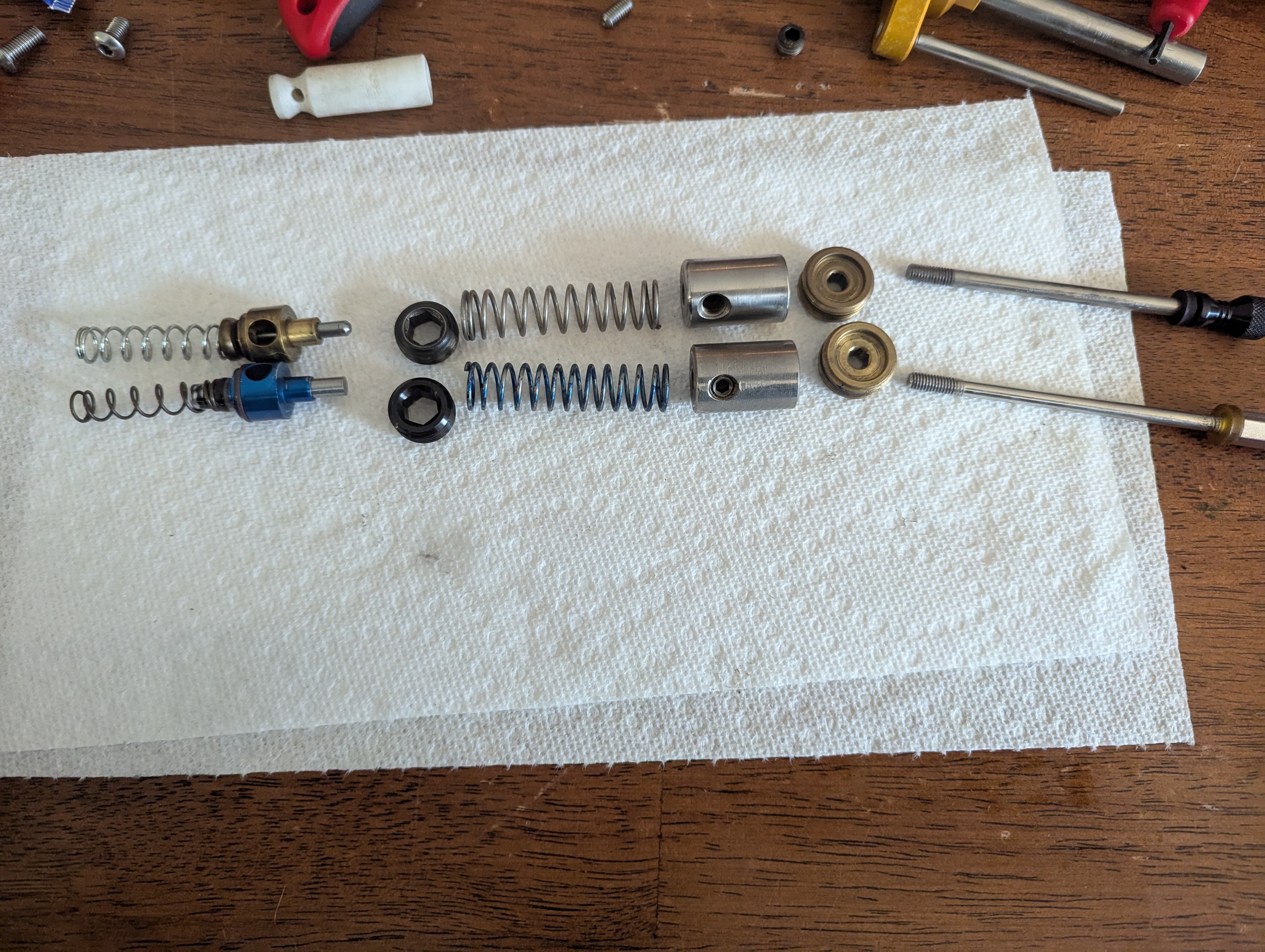

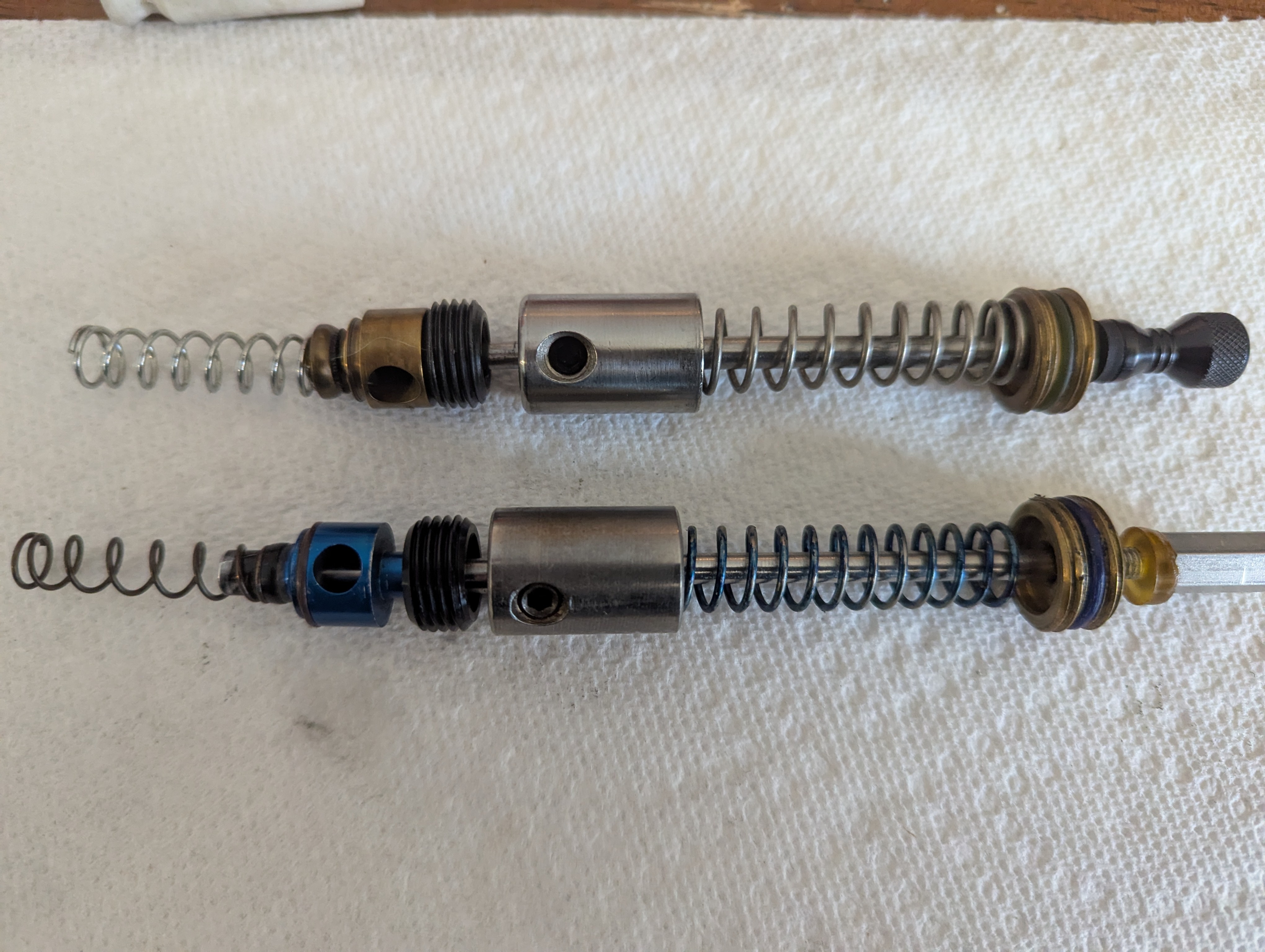

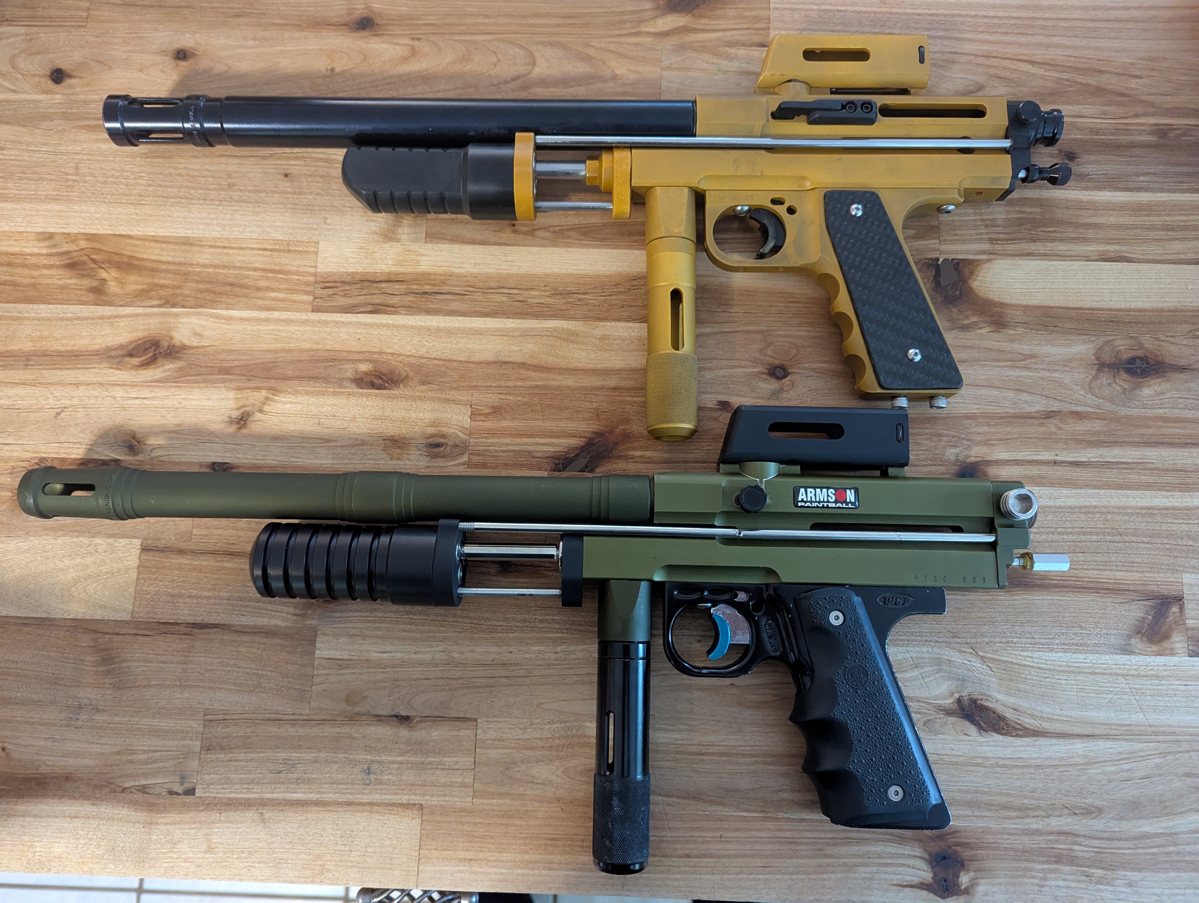

    After playing at Slim's I wanted to finish my PTSC with whatever parts I had. I want this to run on straight 12grams, no regulator. I am borrowing the prototype, Colonel Mustard (CM), which is now working perfectly. I would like my PTSC to work the same as the prototype. So I took apart CM and I tried to match the lower tube the best I possibly could. The hammers are same weight and nearly identical. The Hammer spring is same size and compression strength (I compressed both by half an inch on a scale and made sure they were the same weight). The valve springs are the same length and compression rate, but the one I have is definitely different looking, but again it functions identically. As for the valve, I believe I am using a shocktech valve, but the dimensions of the valve are very similar, although the pin is slightly different.
    I rebuilt CM and it is super smooth and very efficient. I replaced all o-rings and lubed up mine, and when I threw on the 12 gram, I heard it gas up, but when I pulled the trigger it was like there was no gas in it. I screwed the IVG way in, and when I fired it there was the tiniest pop. I degassed it, set my Ninja adjustable tank to 800 psi screwed it on and had the same result. So I kept lowering the pressure until I hit around 500 psi and it sounded like it was firing a reasonable loudness, but I didn't test it with paint. At this point the pump stroke is heavy and it sound violent when hitting the valve pin, so even if I got it working here I wouldn't want to use it like this.
    What am I missing... Even if I am off a little bit (valve pin?) I would think I would still get a little bit of function when matched to CM. The only obvious thing that is different is the valve and pin, but they are so close I feel like I should still get some kind of result. I feel the obvious next step is try lighter valve springs, but I am just wondering if I am missing something, I just feel like this setup should work... I could use some help!

    I would try to change your valve. Shocktech valves are low pressure and designed to run under 300 psi. Cant tell 100% from the angle and limited view, but CM valve looks to be a palmers valve.

      Blue valve does not look like a Shocktech.
      Appears to be a CCM.
        Agreed, I have had the best luck with direct co2 input with PPS valves. Hell I’ve had the best luck in general with them. CCM valves have given me more headaches

          blue valve is a ccm valve. gold valve is a palmers valve.

            Also CM had an air chamber spacer to remove some volume iirc
            • shooter311
              shooter311 commented
              Yes, you are correct. I plan to make one for mine, but I need to get a shorter VASA screw so it can slide in.

            That armson 🤩..that green

              You’re way too far over your sweet spot for that valve on unregged co2.

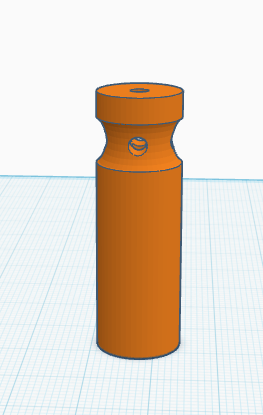

                      Thank you MCB Experts/Animals, I threw the WGP valve in and it is shooting perfectly! Efficiency was 22 b/12g which I would be happy with, but I just drafted up a de-volumizer (copied the one in CM) and I am printing it now, wish me luck on that one.

                      Next question, do you think there would be any negative issues with a 3d printed (PETG) de-volumizer? There shouldn't be any moving parts touching it, but given the pressure and air flow, could that cause issue?
                        Ecapnation commented
                        3d printed parts are porous it might cause some issues
