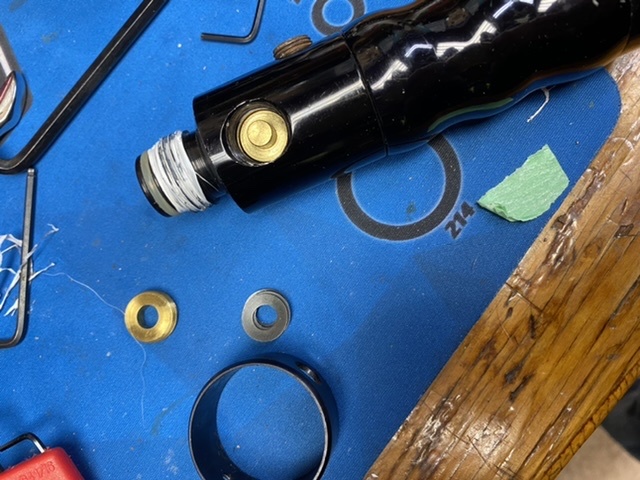

    Throwing together a gun if miscellaneous gear and went to zap slap this x-chamber on my gun. Under a collar I found a valve with shims. Can someone more knowledgeable educate me on what I have?

    While I've never seen it in person before my guess would be an over pressure relief valve
    My original impulse had one but it was a much different style
      • 4560
      Would make sense. Would bleed if over pressured. It does have a pressure gauge on it as well.
        • 4332
        That might be a regulator...... Looks remarkably like my cmi inline reg.
        • k_obeastly
          • 450
          that is a CMI regulator. They are kind of neat but I never found them to function very well.
            Cdn_Cuda commented
            Thanks! Seems like an odd design for a reg. Should be fun to mess around with

          https://www.dirtyworks.com/markers/p...gex-black.html
          this is it!
