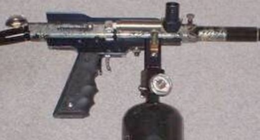

                • Hp_lovecraft
                  • 379
                  Welding, restaurant and industrial gas suppliers will fill co2, but not likely to have the adapter needed to fill a pin valve. But, worth a call. Some sporting goods store will fill, as well as some scuba shops and hardware stores. Locally, "plant" growing shops have been filling co2 tanks. But what I ended up doing is just getting a 20lb bulk co2 tank. You will find tons of places that do exchange programs like with propane tanks. When its empty, return it, and they give you a full one. You will need to get a fill station or build your own. and its generally best to get a siphon bulk tank, though you can fill tanks with a non-siphon.
                  I know thats all a pain. The industry made a hard shift away from co2. Partially for good reasons as it reduces fps spikes in the summer, and equipment troubles in the winter. Most modern guns can't run co2. But usually its just because HPA is accepted enough that fields don't want to pay for the extra staff and equipment for co2. But for me, using liquid co2 has been part of the fun. I love the cloud and frosting. I love the simplicity of it, and the fact that it because a "lost art" that modern players do not believe such a thing even existed.
                  That said, it shouldnt be too hard to fab up an LPC. Back in the day, there were 2 on the market. The NitroZ, and the NeelyZ. Both added an LPC and gutted out the valve. You can see below.
                  • IcyBarrel
                    • Jun 2025
                    • 4
                    Thank you so much for this incredible information, I had no idea that some of the places you mentioned could fill CO2, I'll check locally for those, also thank you for the pics of the lpc's. I never knew they existed. Again, Thank you.
