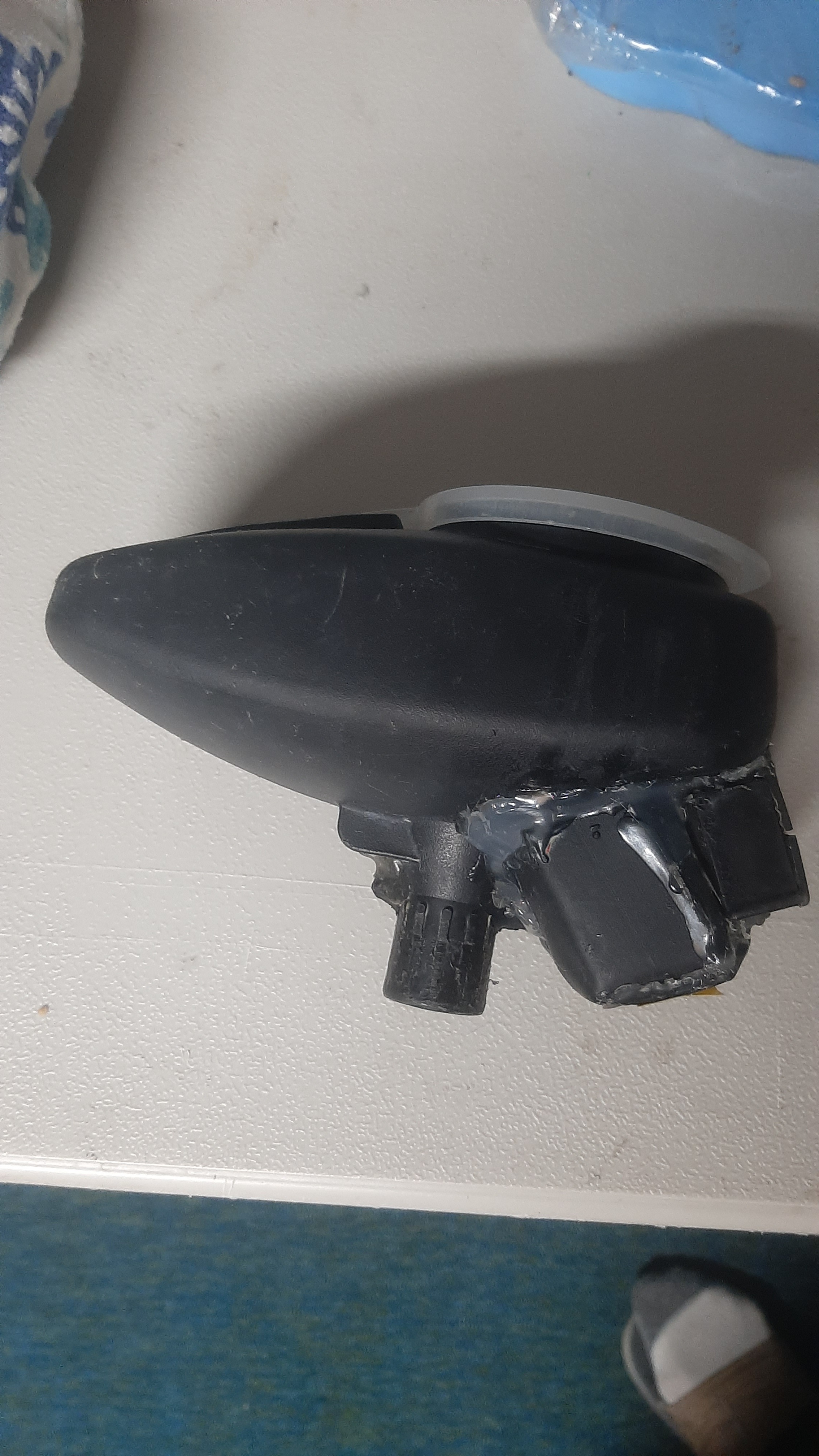

      20250615_071754.jpg 20250615_071716.jpg I have been running this xtreme rage 100rd for over a year. I put the motor board and eyes in it. Runs on 1 9v. Used the blade from an Eggy so it would just move aside if the balls are in the way. The "sides" are just plastic and hot glue. Taken many hits and survived with just re gluing. Its my goto hopper from pumps to electros.

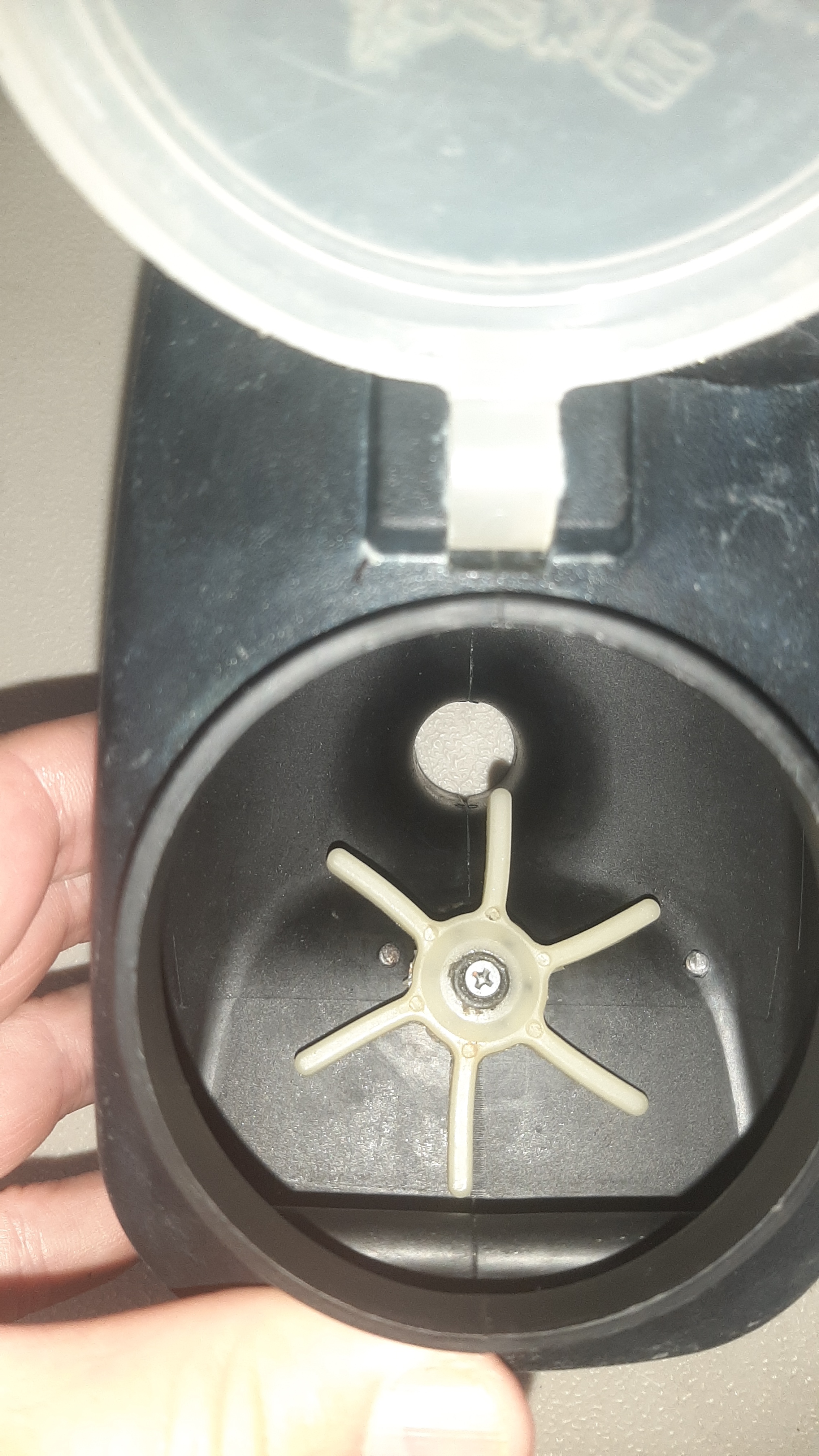

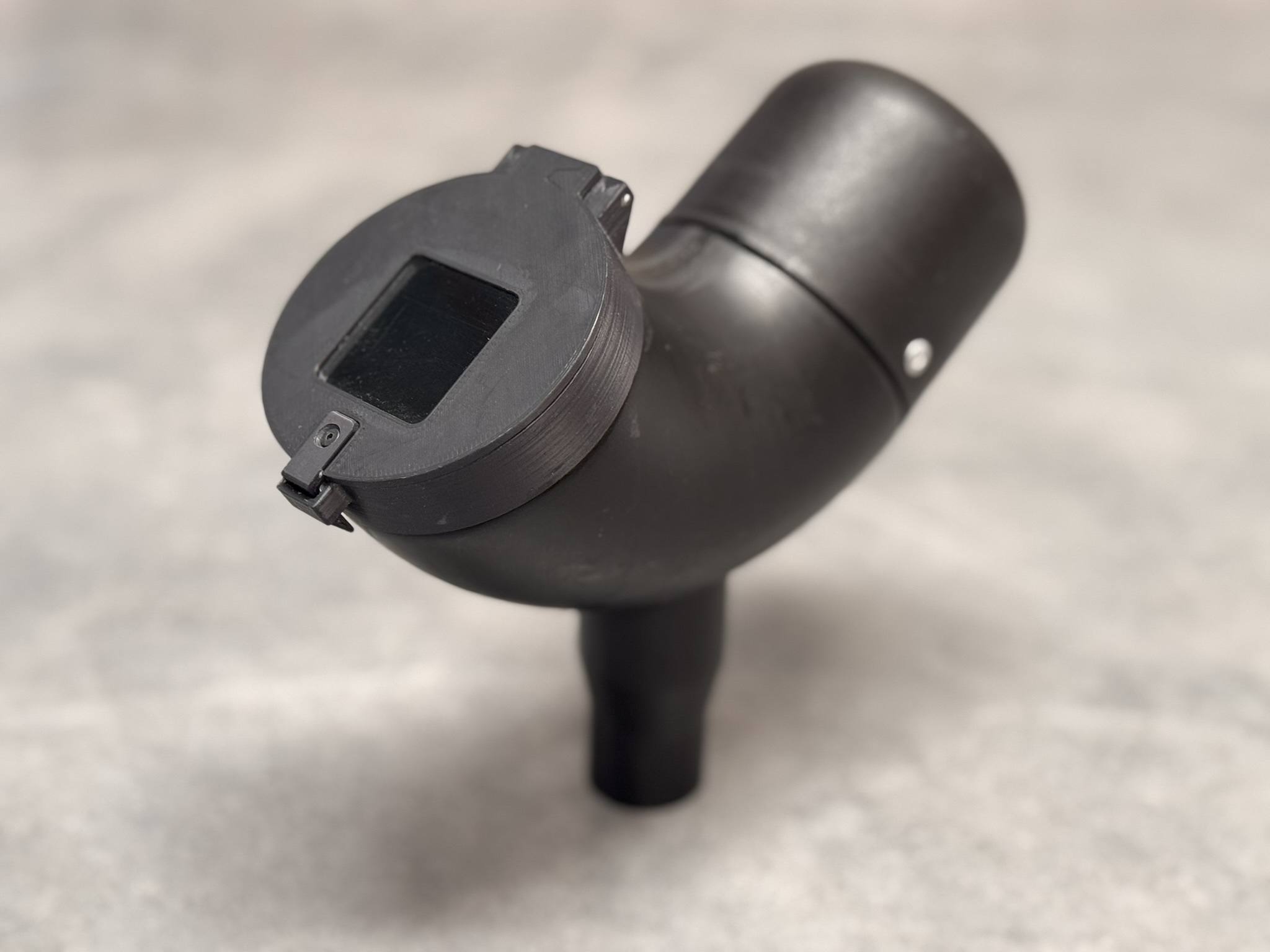

                    Welp, I have some good news. This thread gave me the push to finish up this project.... Behold: the VL-90 replacement lid! 35 years in the making!
                    These will be available in the dealers section so go there for more info, pricing and details. Briefly, while they may look like the same questionable design, the are vastly stronger and better than the brittle OG lids. Battle tested over about 5 weekends now and made from ASA (slightly more flex and better UV than standard ABS) I've even shot the prototype clear lid a couple times, I'm pretty confident this is a good product and am really happy I can use my Viewloaders without worrying about the 2 mint OG lids I still have. I you can move any questions over to the dealers thread that would be good as well to keep it all in one spot
                      Shut up and take my money! Is there some kind of 10 round tube speed feed for the window?
                    • Drcemento
                      Drcemento commented
                      No 10rnd speed feed adapter... yet, but i think that would be a fun and relatively easy mod. did'nt the really OG ones have a hole in the front piece?
                      Drcemento I'm uncertain, but I feel like they did. I didn't realize the hole in yours had a little window I thought it was just open, oops.
