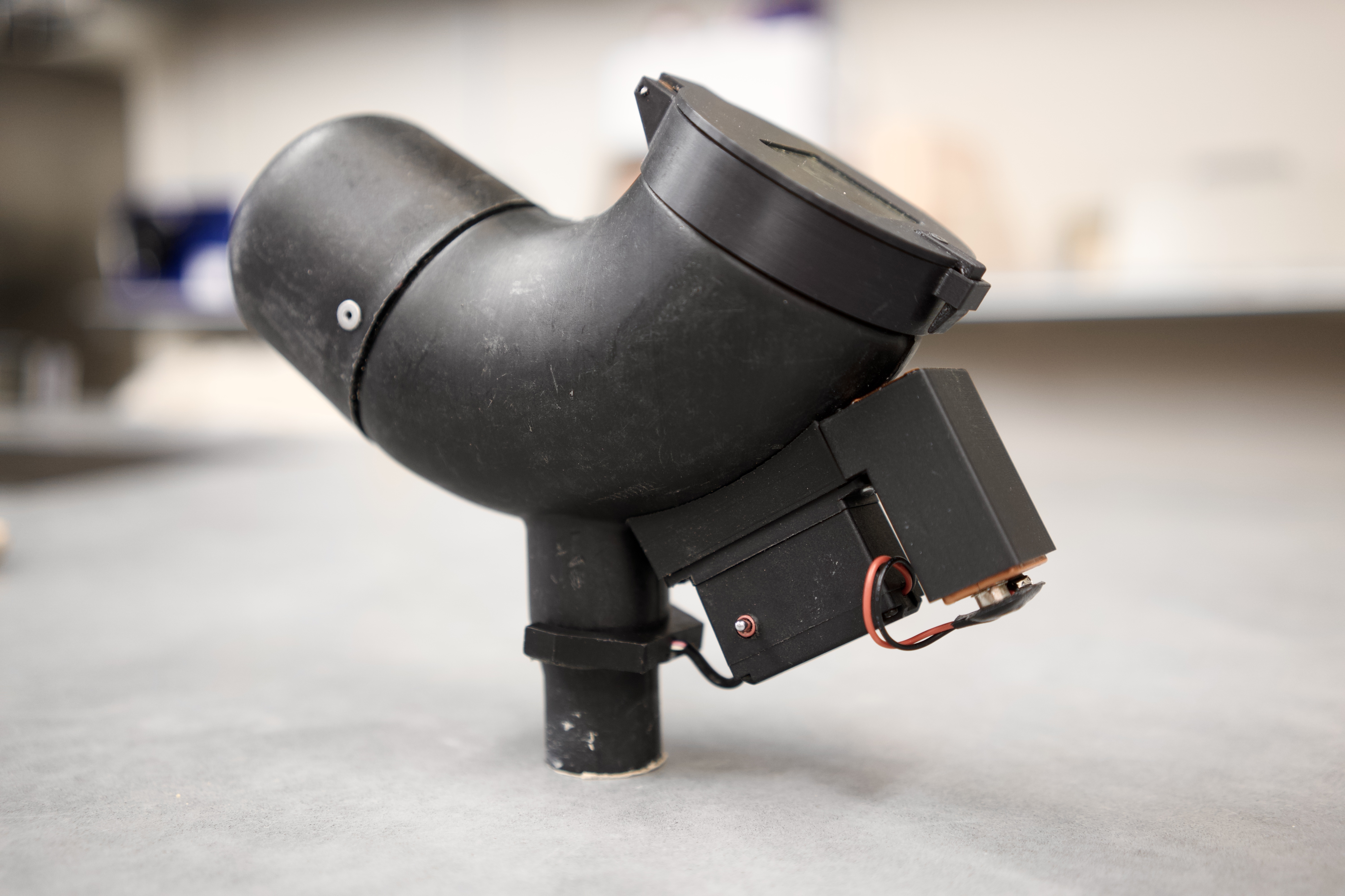

            Welp, I done did a thing, in the name of re- inventing the wheel and pouring hours of creative energy that would probably be better spent fixing up my house, or solving world hunger, or doing something that makes money, I present the VL-90 revy!
            • Drcemento
              Drcemento commented
              I did it for you Jonnydread, oh mighty appreciator of all things VL-90!

              That's sweet! I can't find my old VL-200. While I love my sportshot running while I play pump, I still get jams now and again. Was looking at homecooking something for the sportshot. Could this adapter be modified?

              I love it! You can make a bit of money with it, start printing and selling these mod kids
