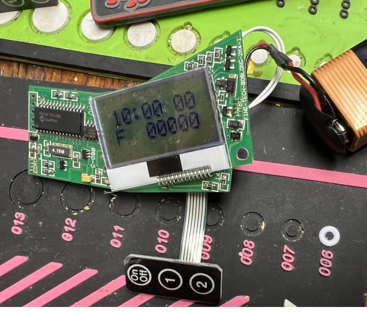

    • 4560

ID:	722664 Ecapnation. Board is a 2k4 LCD. I have another 2k4 LED board as a spare as well.
    I’ll get a photo of the boot up screen as well.
      Ecapnation commented
      That F indicates an eye fault
      Cdn_Cuda commented
      Manual said F is "FORCED MODE" but the manual is pretty bad. Says a * is an eye sensor malfunction. So maybe swapping the board is a good place to start.

    • 4560
    Trying to use the board again, but pressing the buttons only seems to start and stop the timer. I can’t get i to any options.
    board says Bob Long 116 and then states battery voltage.
