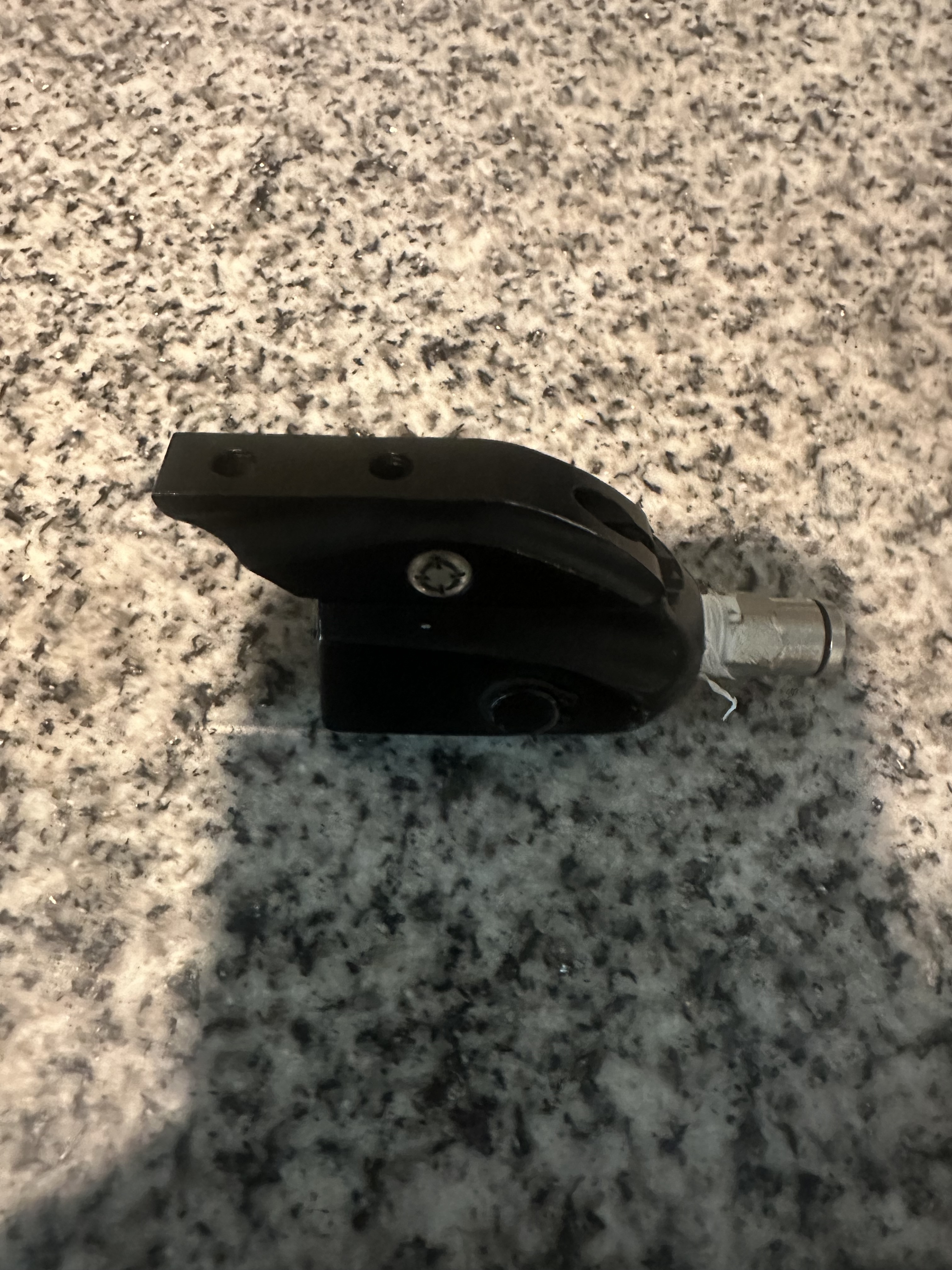

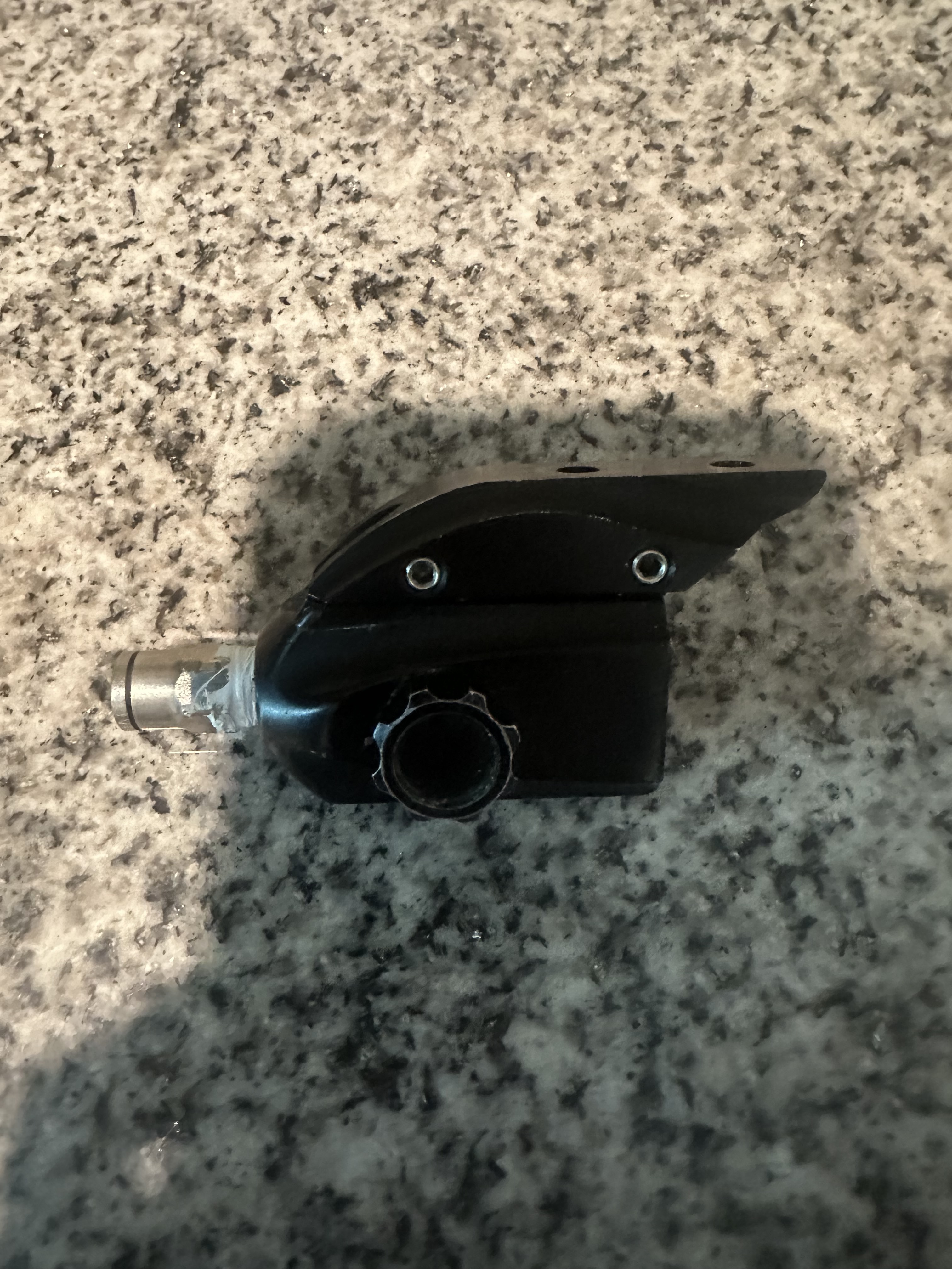

    I have an old Smart Parts on/off & rail combo but the on/off leaks when you turn the air on. Given how old this thing is I figure it just needs to rebuilt. Does anyone know how to do this? I don’t have the slightest clue how to disassemble this thing or even what size orings I need. Also does anyone know what size screws I need for the rail? Somehow I lost those when I took it back off the gun.

    Originally posted by OpusX
    You will need c-clip pliers to remove the knob. It has two orings on it (cant recall size). Thats about it.
    Thanks! Now I just need to borrow pliers and find the rail screws lol.
      • 6382
      All 2 hole direct mount (which is what that is) screws across paintball will be 10-32 thread. The length and head type will change depending on your application but 10-32 for attaching anything to a bottom line setup
      For your setup there, you'll have to loosen the two screws on the side which will allow the ASA to come off of the rail, then attach the rail to whatever marker you want (use lock tight!) then slide the ASA back onto the rail and tighten the side screws again. Use lock tight!
      If you don't use lock tight you will only find your ASA is loose in the middle of a game which is the the worst time to figure that out. Ask me how I know

          My apologies if you already know this @ThatDude812 ​, before you go through the effort of rebuilding this thing, this on/off is unlike most every on/off released in the same time frame, and ever since. It only cuts the airflow to the gun, it does not actually control the pin valve on the tank. Another feature it's lacking is a de-gas function. This on/off was meant to be used with a continuously connected tank (i.e. you fill the tank with the gun connected, you clean the bolt with the tank connected, etc). In order to properly remove the tank (without galling the threads), you have to back the tank out just a few turns (maybe 1-2 depending on your particular valve), fire a few shots until the gun doesn't cycle, then remove the tank. Otherwise, this ASA will destroy aluminum tank threads and steel threads will destroy the ASA threads.
