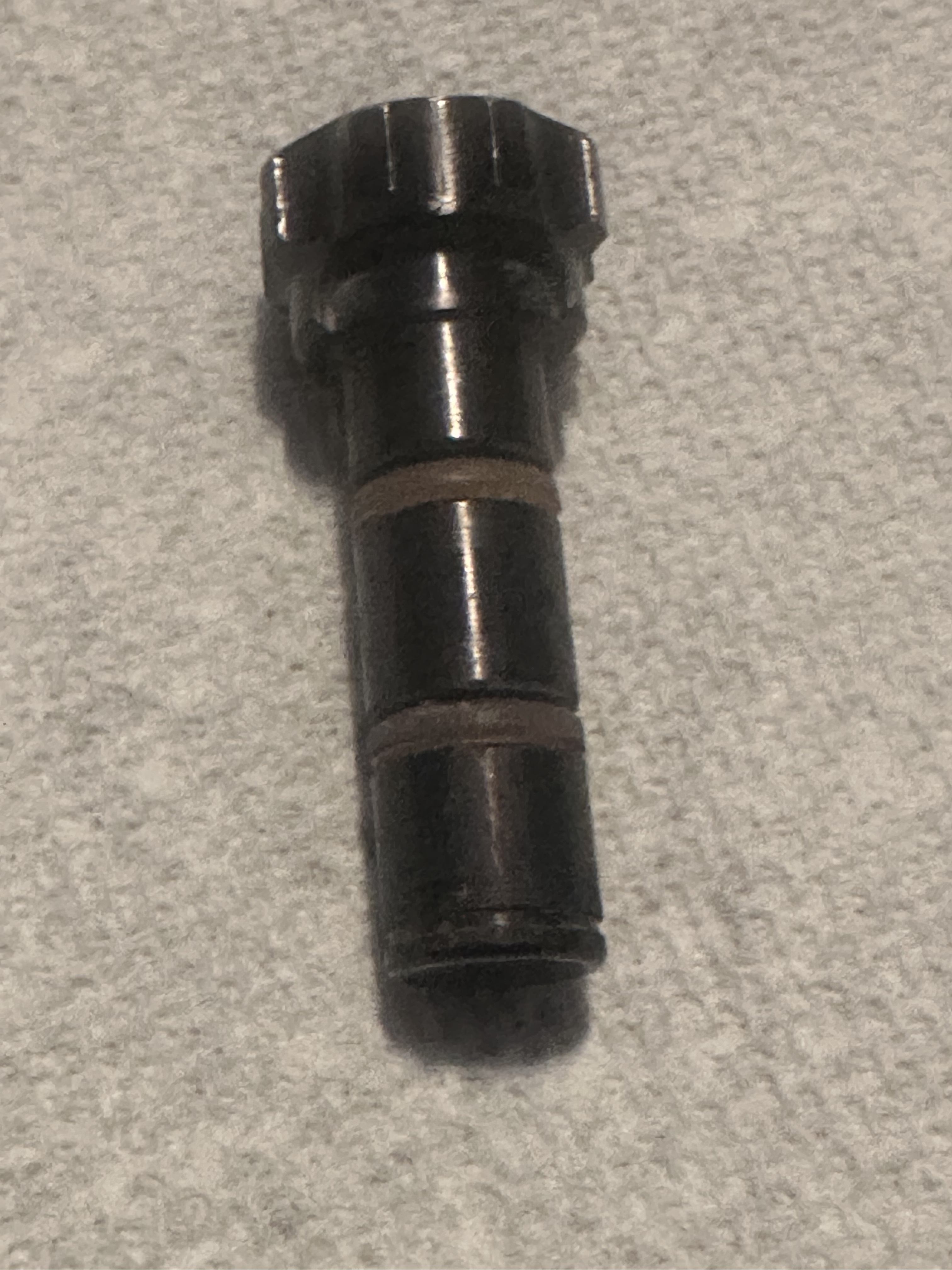

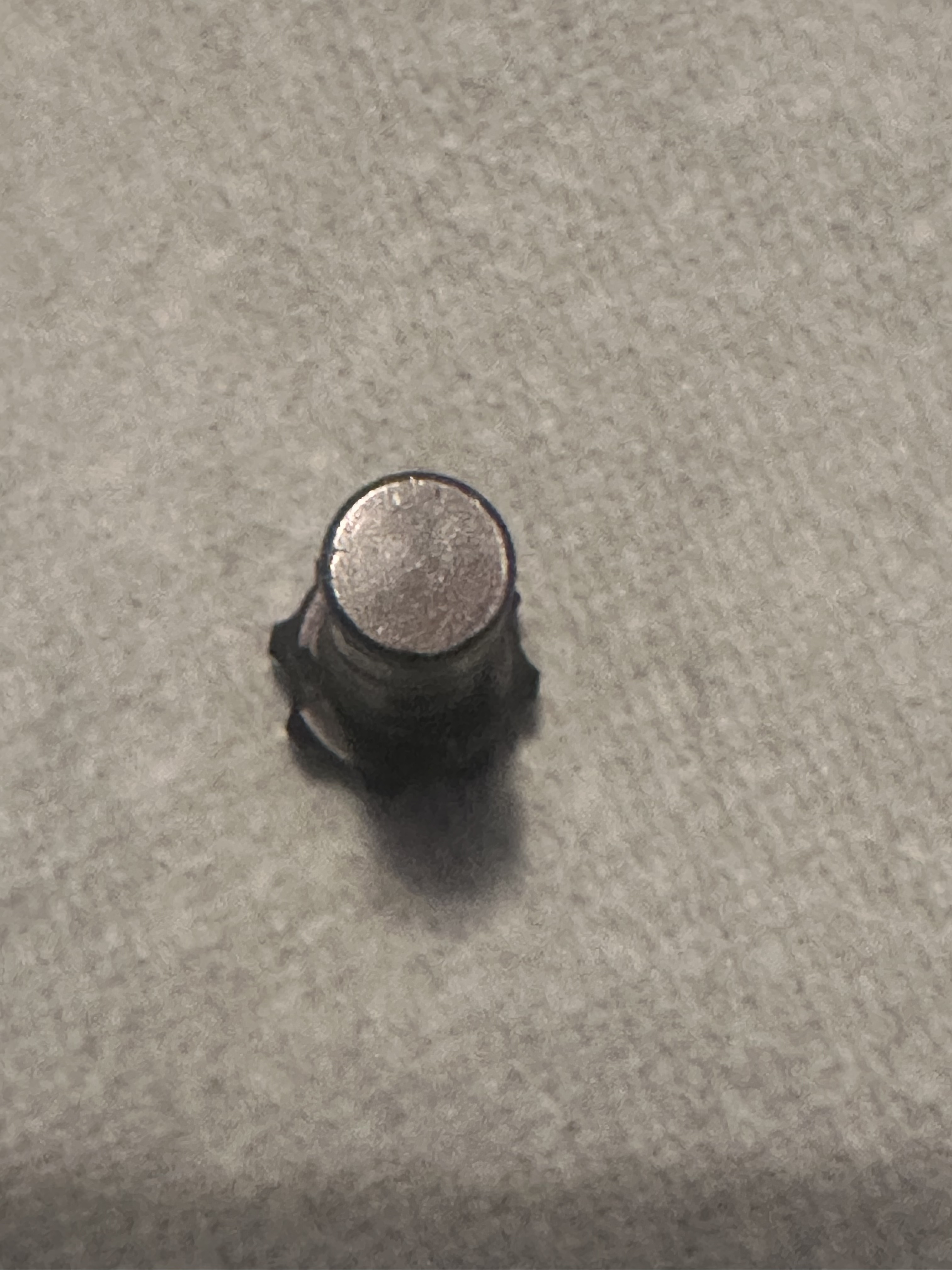

        Ok…so I got the pliers and got the knob with the o-rings removed. Anyone have a clue what size o-rings these are?

          #19
          It's a 009 or 010, I can take mine apart later today and make sure which.

            #20
            I am using 010 70 durometer orings in my Smart Parts 1/4 turn on/off
            There is also a small (003 ?) 90 durometer oring internally on the rear interior wall.

            • 6182
            #21
            Sounds like it might be time for you to build your o ring kit. Most of us here have done just that so we have everything we are likely to need on hand.
            If you are just starting out building your kit I'd recommend sizes 003-018 buna 70D
            111, 113, and I think there's one more 100 series that's common that I'm forgetting right now, maybe it's 112
            Figure out a case to hold them in though that will determine how many different sizes you can hold
            Theoringstore.com is where most of us get rings. AS568 buna 70 durometer will get you through about 95% of situations
