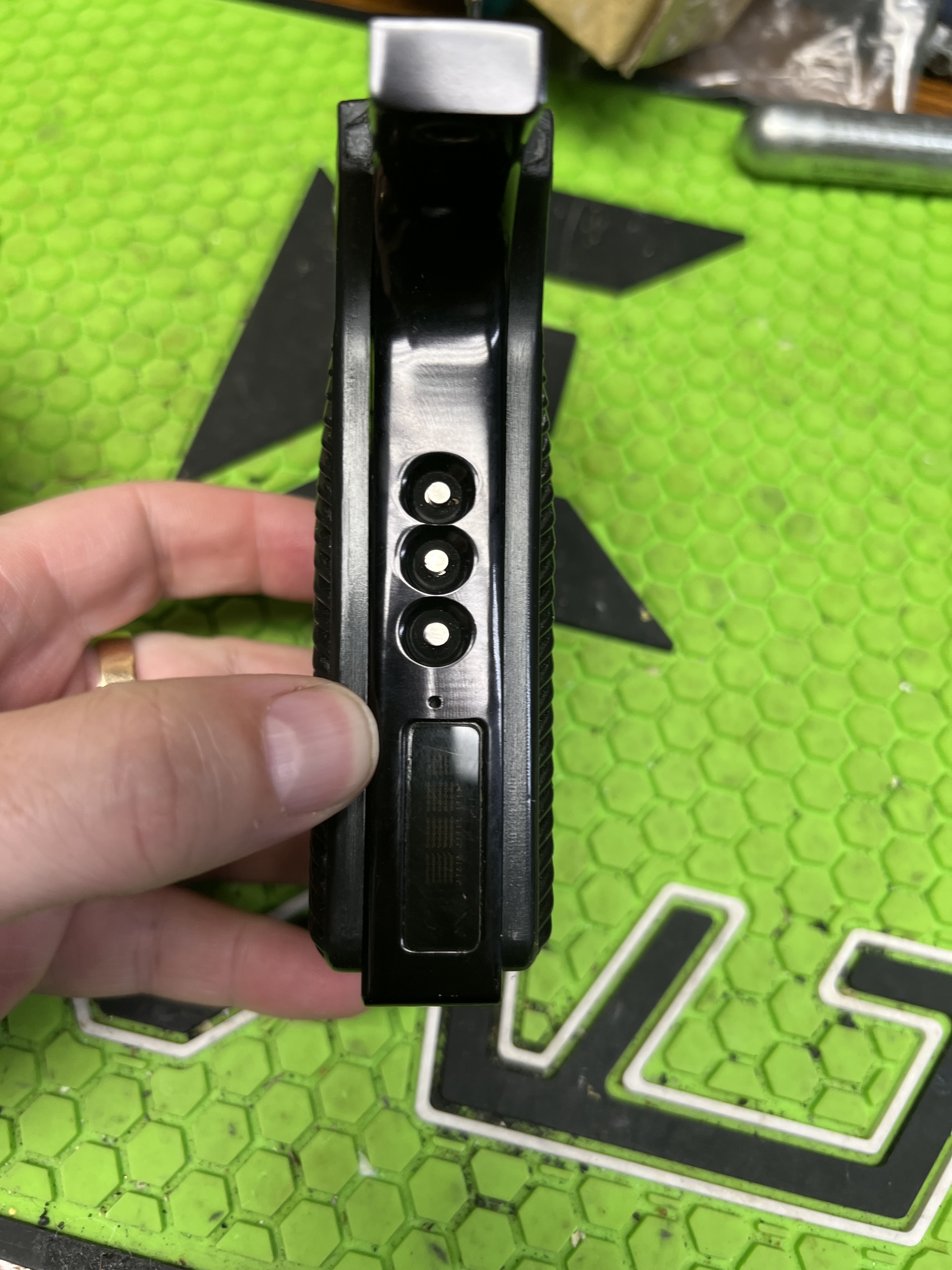

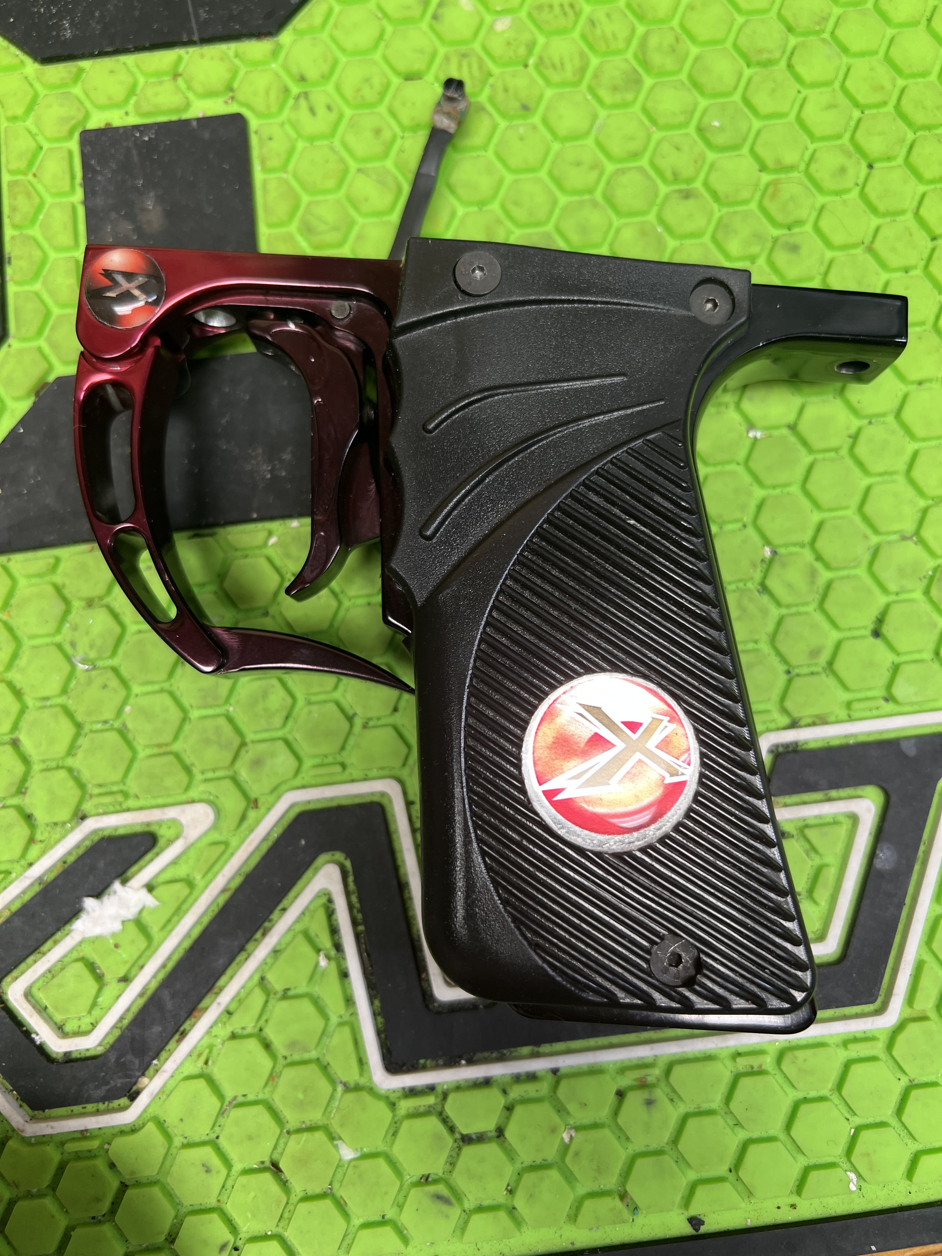

      Sorry to hijack this but can you post a pic of the back of your Xonik frame? And does it have the Xonik 4 button stock board?
        Cdn_Cuda commented
        Will do once I dig it out of the closet!
    • Junglepeanut
      I would rather be fishing
      • 1506
      No rush thank you. I am building a Xonik as well and wanted to see if there were differences in frames

          • 4560
          Junglepeanut
ID:	735838 Click image for larger version
          • Junglepeanut
            Junglepeanut commented
            Thank you.......

          I have the same frame. It works with an E1 board but the buttons don't line up quite right with the board buttons.
