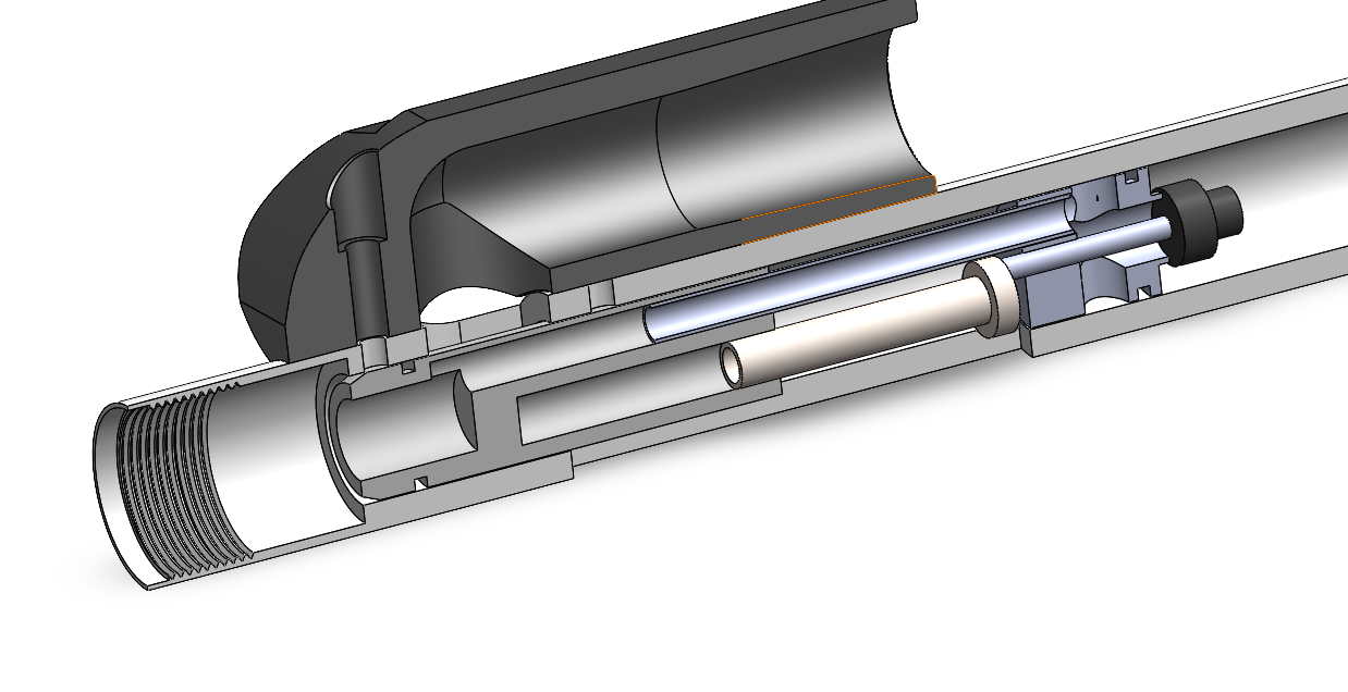

      Power tube finished for now, big old firing pin thingy started. Main spring may end up in the top of the grip frame.

        No update on the model yet, but I was pondering a few things. I could flatten the angle on the top of the firing pin and matching angle on the bottom of the powertube, and that would give me a place for a main spring. But that won't work. For one, the pump stroke would be really, really odd. Assume I have a sear of some kind for the bolt to catch firing pin, and a spring between the powertube and firing pin (give me a little slack, I just figured out how to model a spring like yesterday, they don't come up often in cabinetry), as you pump back you'd have zero resistance, which is good. But when the bolt catches the pin and you pump forward you'd get all the tension from the main spring, increasing the farther you push the pump handle. This would feel weird. And nothing to hold the bolt closed when it gets fully forward. You'd end up firing the gun, with bolt open, if you let go of the pump handle. Unless you add a second sear to lock the bolt forward.
        Nah, that's getting too complicated.
        On another tangent, I'm not 100% happy with the powertube. It's design is ok, I'm just wondering if I get get rid of it entirely. The top back half of it could be integrated into the valve body, and the front bottom half could be part of the bolt. The middle would be like two half cylinders overlapping. I may save a version 2 to tinker with that idea.
        • Jackson
          Jackson commented
          You said it yourself already that it's a single tube sterling type, so why not have the same kind of sear arrangement? Pump back compresses the spring and latches to the hammer, forward stroke pulls it all forward.
        • Fubarius
          Fubarius commented
          Oh, that was the intention from the beginning, but one of the main reasons I'm doing this is to experiment with different ways of doing things. I saw a spot were a spring "could" go and wondered what would happen and decided to share my thoughts.
          There will probably be a lot of dead ends on this project.

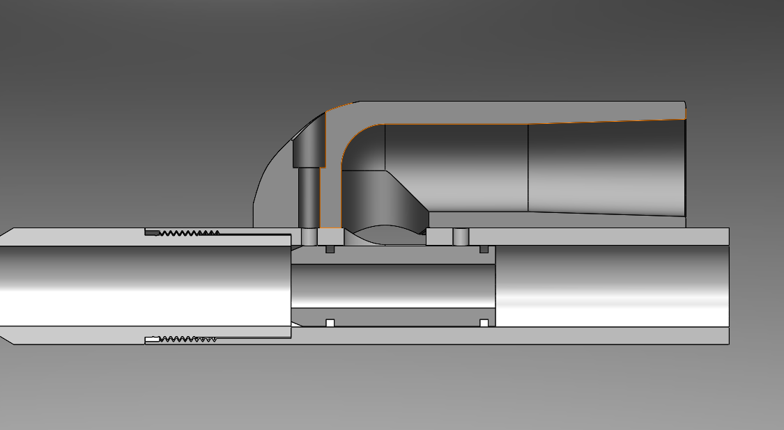

        Ok, just had to get the idea out of my head (speaking of probable dead ends from last comment). No more power tube, just really long overlapping valve body and bolt....
        Not sure I'm happy with that zigzaggy air route. And that's a lot of surface to be sliding against each other. Tolerances would have to be loose enough to not bind, but tight enough that the air blast won't leak all over and come out the grip frame.
        Also, from an ease of manufacturing stand point, I went from two easy parts and one slightly more complex part (I think), to two complex parts. Not sure if I'm saving anything here.
        • tyronejk
          tyronejk commented
          I think that zigzaggy air route will restrict flow enough to really choke down your velocity.
          Flow through a pipe decreases proportionally with length and increases with the 4th power of radius. https://en.wikipedia.org/wiki/Hagen%...uille_equation
        • Fubarius
          Fubarius commented
          I did have to shrink down the radius of the pathway quite a bit compared to the Version 1 design so I tend to agree. Not sure how big of an effect it would have though, considering how small a diameter many old pumps had on their powertubes.
          Now there is a different school of thought though. A paintball gun doesn't use a continuous flow to launch the ball, but a quick burst that then expands through the system. Too big of pathways and the burst will lose energy as it expands.
          I think solidworks can do some airflow simulations, but that's WAY beyond my intro class knowledge.

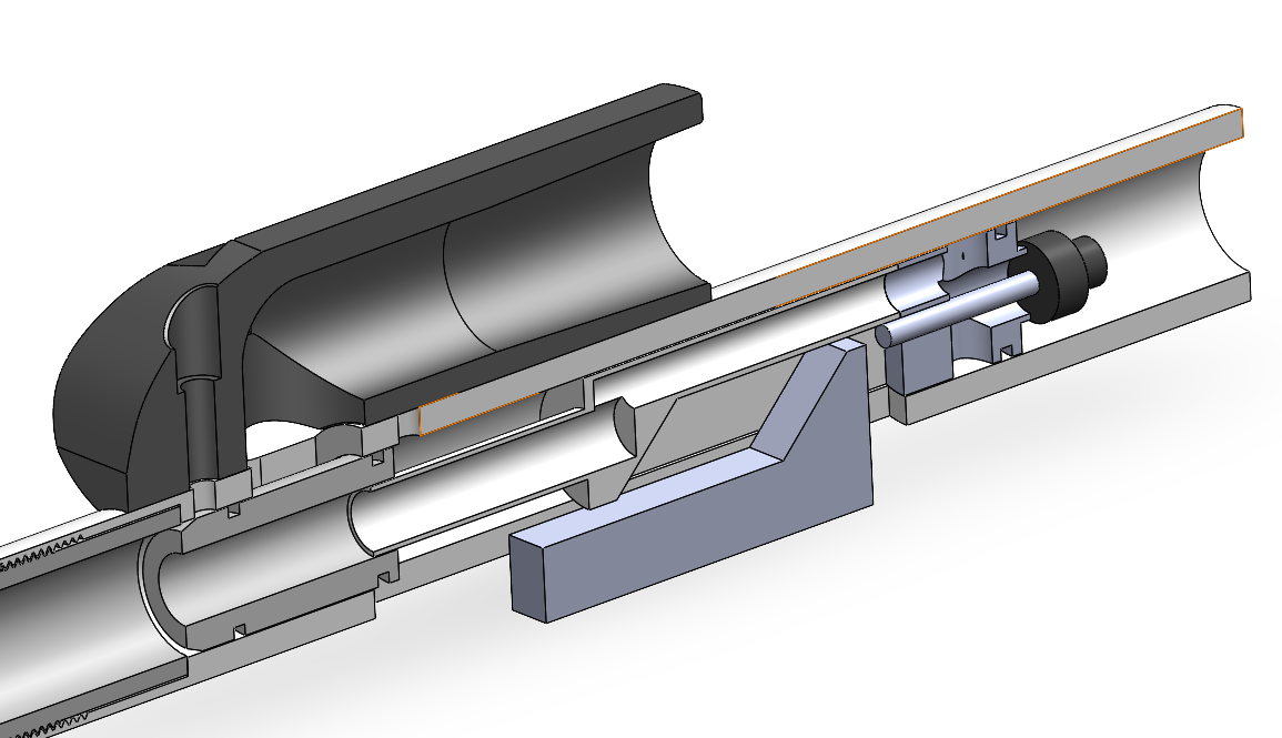

            #24
            Ok, we're now up to Version 3, though Version 1 may get revisited, and an external air path model would be yet another, but sticking with original concept....
            Simple press fit (and tack welded? Epoxied? Added set screw? Oh! Velocity choke screw holding it in place!) air transfer tube, going straight to the bolt. The bolt is now longer to have a fully surrounded firing pin, so no binding on lower tube on the forward stroke. The spring would be something like a Tippmann main spring in size.
            I really need to get a grip frame model started on this thing. With a firing pin design the sear is attached to the bolt. This tends to push the trigger forward, or necessitate the need for a sliding trigger. But that could be cool too.
            As a bonus, the whole mess got about 3/4" shorter.

              if you make that a balanced poppet valve, I think you're onto something
            • Fubarius
              Fubarius commented
              Balanced poppet compatibility was something I wanted to include, I'd have to research their design a bit more to decided if its something to include in the base model, or if it's something to open source and let an existing expert at it make an aftermarket.
              But something like a Neo Powervalve super simple balance (loooong cup seal going to the back of the valve chamber) would be easy enough.
