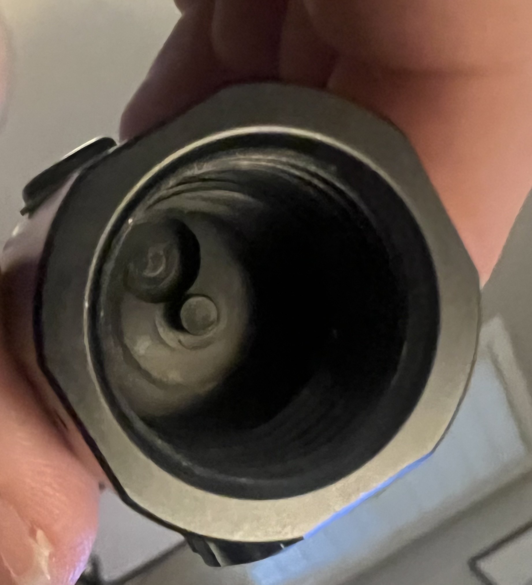

    I just got this in the mail from ANS and I’m looking at it and I can’t figure out where the air is going to go once the tank is hooked up lol. I can’t see a hole or anything. Is this defective? It looks like like air port was never machined. I thought I’d ask here first before asking for a refund

    did you ehh.... turn the knob then look again

      I did lol. It’s still occluded. I take it that the knob is supposed to open the port? If that’s the case it’s probably a simple fix right?
      When I turn the knob the air port doesn’t open but if I look down the tank end I can see the knob turning back and forth. So something isn’t catching

        The kmob should do a quarter turn. Pretty sure there should be a groove in it allowing air through at one position. So you blow through ot and turn the knob both ways, nothing??

          It’s moving air! I guess these old eyes aren’t seeing the hole.

        Screw with tank on and then turn it on
