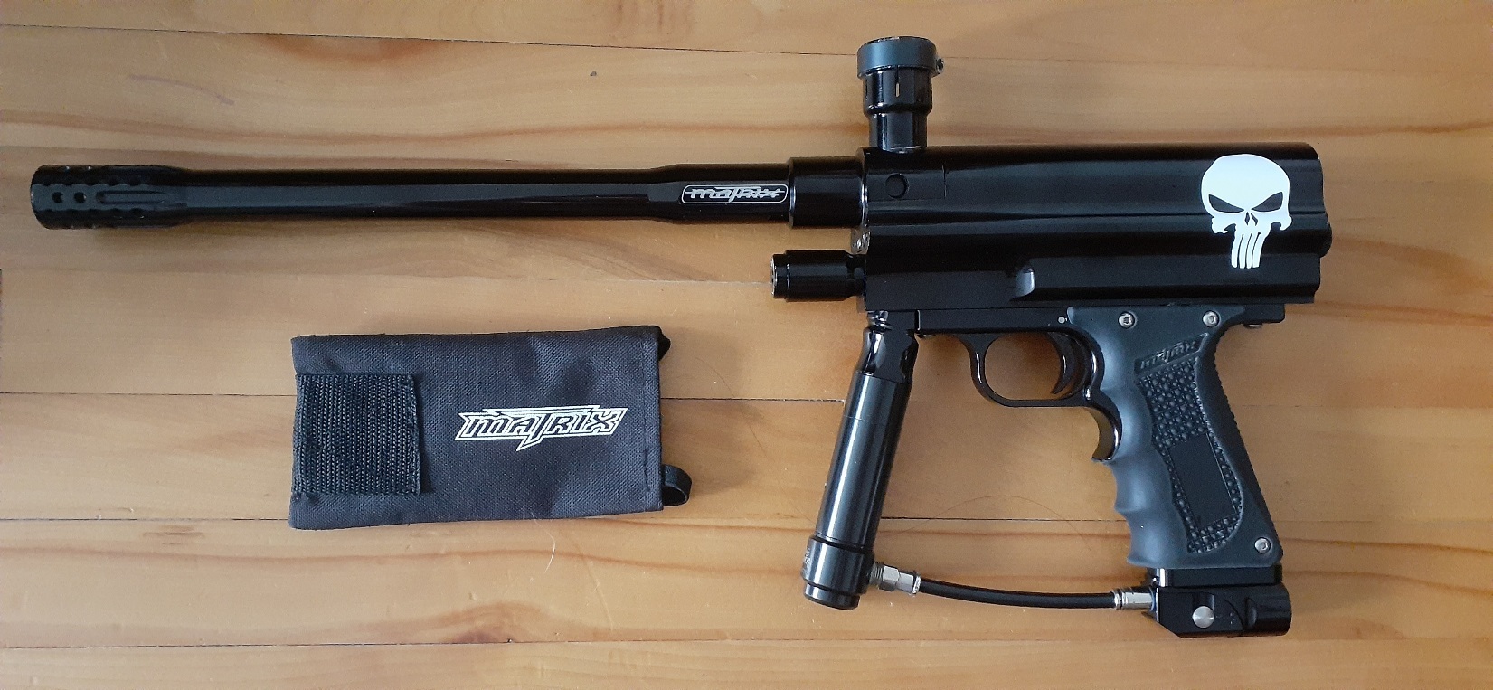

    Here is mine

      Yeah I know it's a bit of a loaded question here, lol... but I'm curious as to what people feel the differences are with respect to the shot quality/feel (or not, as the case may be). That's a beauty marker. Something about the blocky aesthetic and clean lines of the matrix just seems 'right', at least to me.
