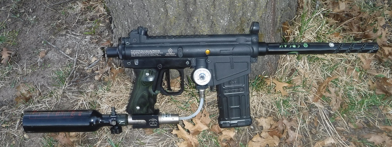

              Not AKA, but J&J. Has a built in RT ram, but I didn't bother to hook it up since I was building a mag fed and the shorty mags would just get used up too fast.
