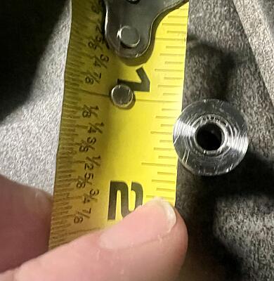

              I’m second guessing my eyes. I ran out of contacts so I’m using my glasses but my near sight is not very good at all with them.
              is this 1/2” or 9/16”?
              • MrBarraclough
                MrBarraclough commented
                Looks like 9/16" to me.
            • FlightMedic938
              • Feb 2023
              • 440
              MrBarraclough Yeah I think so too. Now I gotta find a 9/16” valve. Without the o rings on the stock valve there is a tiny amount of wiggle room. Like 0.3-0.5mm.
