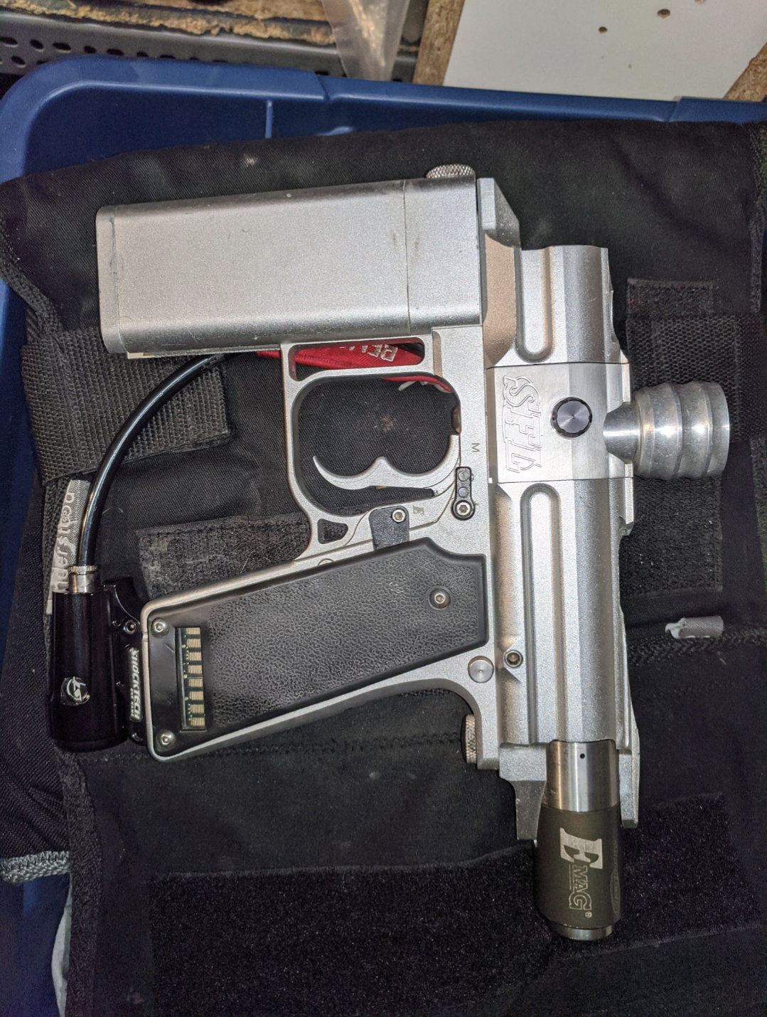

    I have an sfl emag with a long removed battery that's dead that doesn't shoot as a mech regardless of where the selection switch is.....
    I'm hardly a mag person am I missing something obvious?

        We need pictures, cannot move forward without them. Hahahaha

            • 4456
            It's a silver stock one very unimpressive TBH

            The man says "I'm hardly a mag person" and has one of the rarest and most sought after mags in existence.

                  It's part of a larger collection of guns.... Did I want the rarest mag? No not really but I did want to complete owning every non cocker shocktech gun made. Yes even the ion

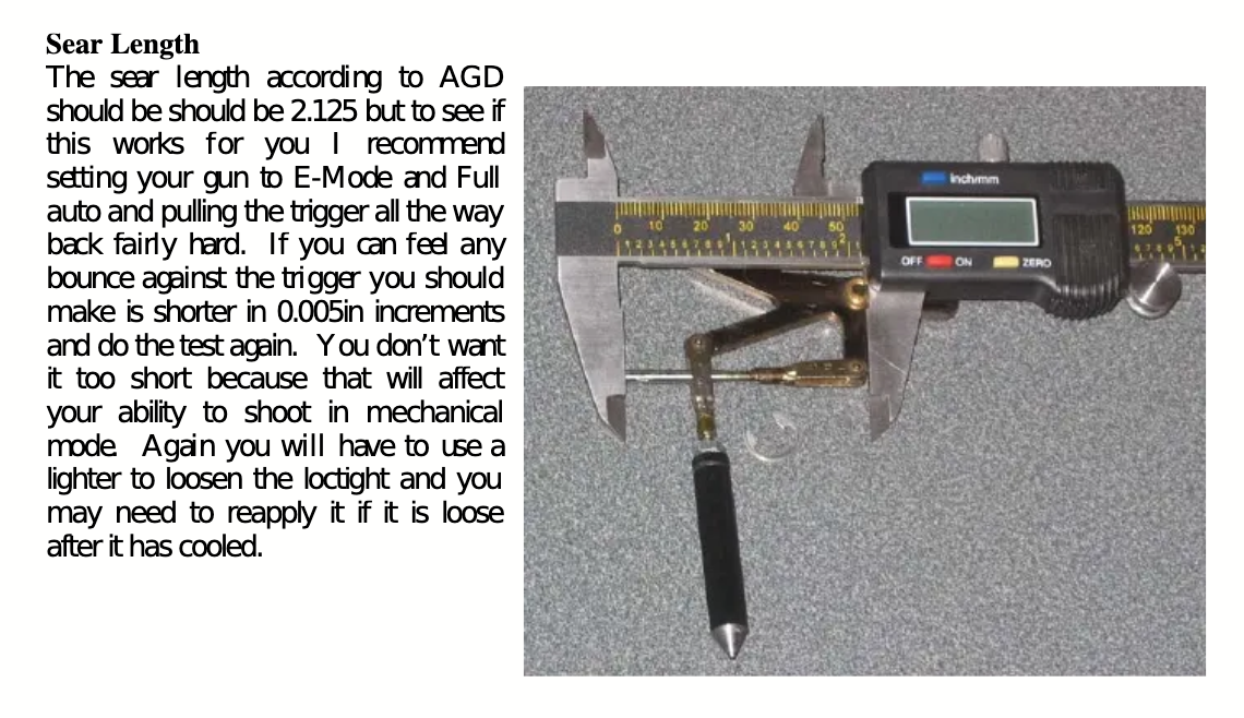

                    When it's aired up, what's the gap between the back of the trigger and the trigger rod?
                    But I can't remember if it's supposed to be the standard Mag "credit card" thickness or something else for E/X-Mags. It's been too long since I had one. superman or tunaman5 should be able to help with this.
                    Edit: Uploaded image from Xmod manual. Not sure if it's supposed to be different for an SFL.

                      Is the sear moving or the solenoid is frozen?
                      When you put air, what is the gap between the trigger and sear rod?
