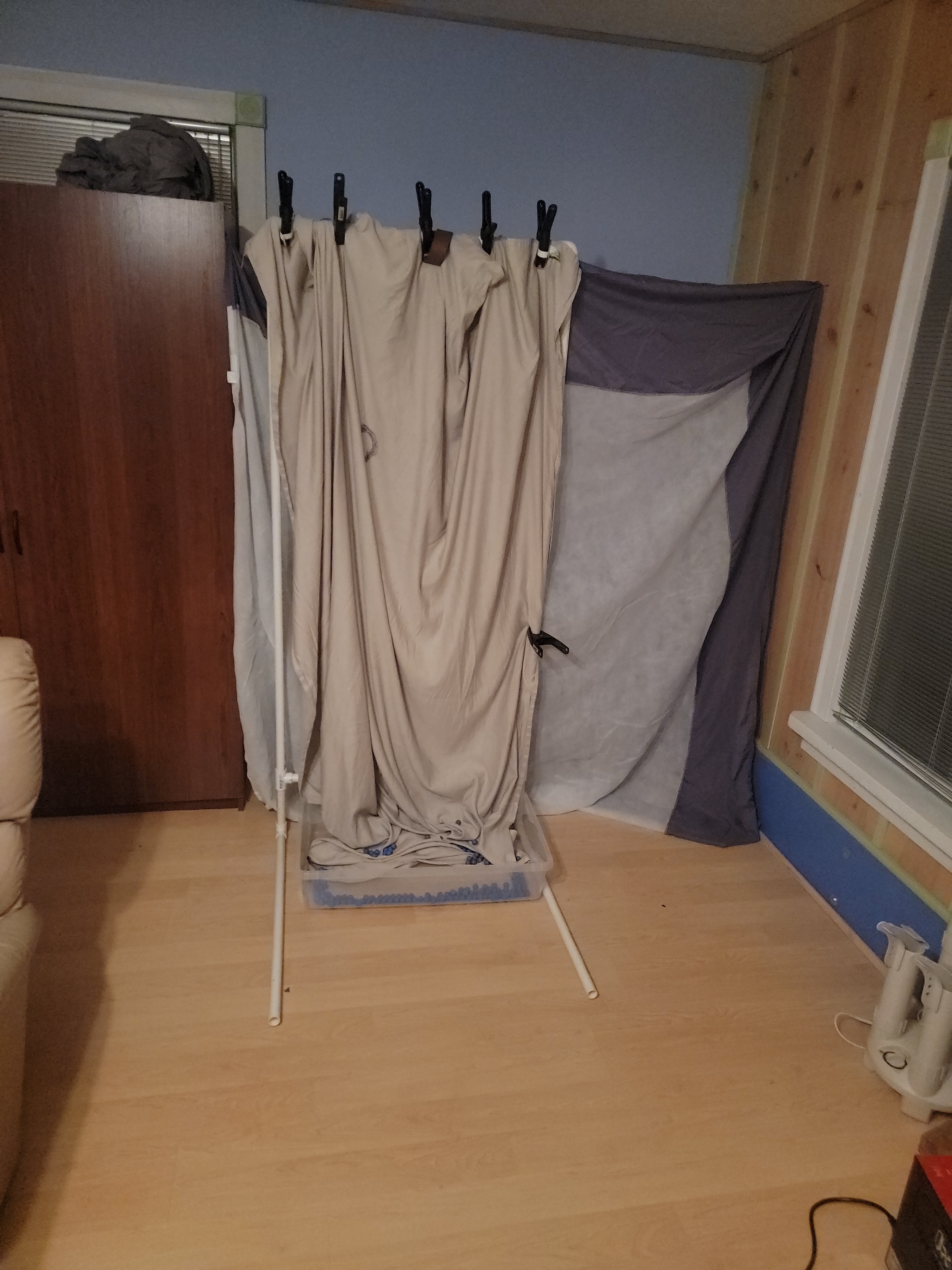

                    • Maxwell
                      Phantom
                      • Oct 2025
                      • 447
                      • U.P.
                      This is my home reball setup for snaps and run and gun drills. Unnecessarily large for most peopIes uses but the idea would work in a smaller size. I use the cheap eBay reballs and they shoot hot about 15FPS but it's consistent so I can tech and tune the meat and potatoes with them and finish up with some paint.
                      ​Feedback
                      I buy Phantoms, PM me
                      • trashcollector
                        trashcollector commented
                        The picture doesn’t come in on my end.
                      • Maxwell
                        Maxwell commented
                        Edited and attempted to fix
                      • trashcollector
                        I see it now.
