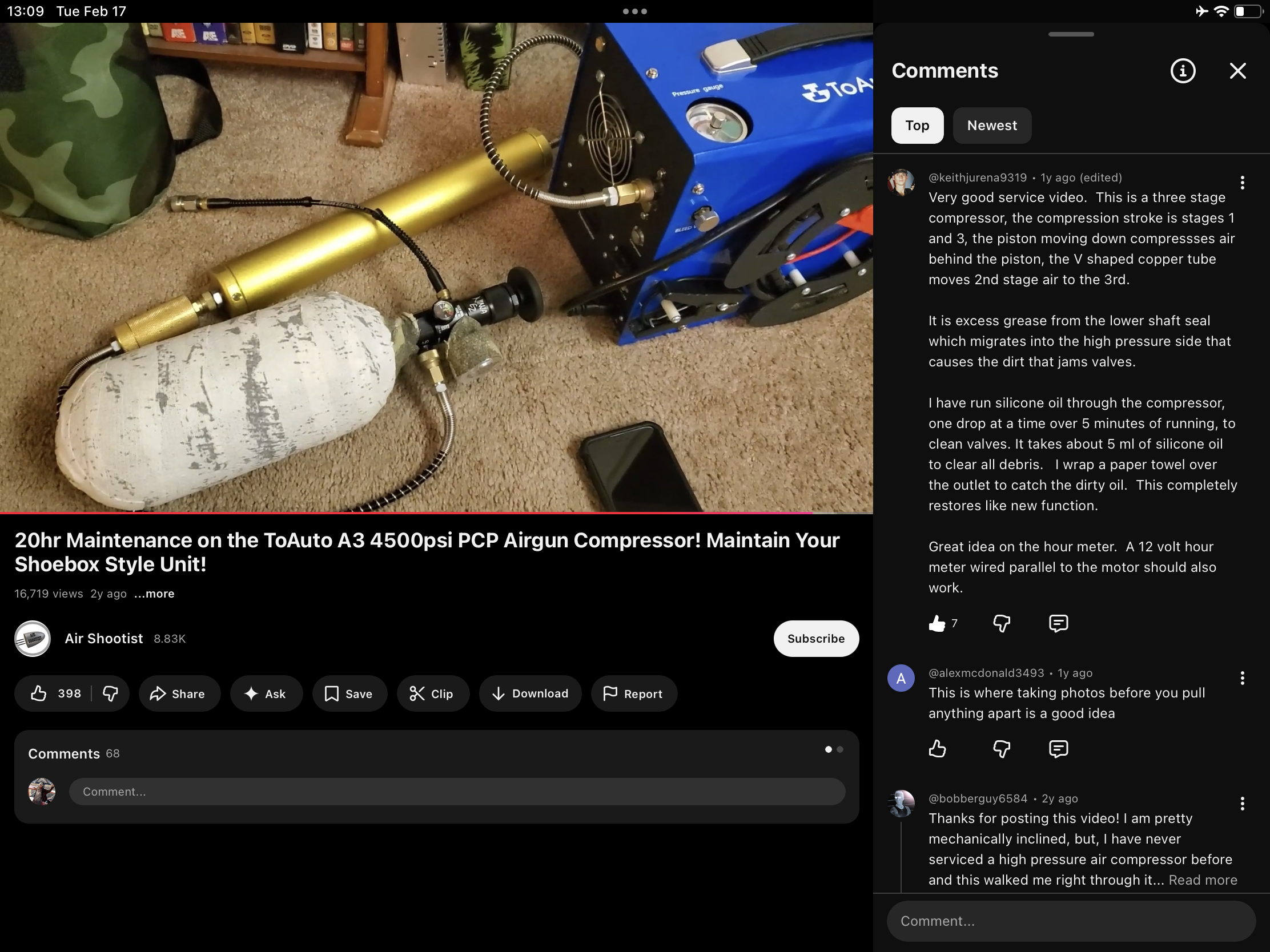

          I grabbed a Vevor that was on sale in December. I observed the fill capacity limits and did my best to warm and cool it properly but it started to lose its ability to compress about two weeks ago. One YouTube comment saved my bacon - silicone oil. I squeezed a bunch into the intake until it started to goop out the outlet. As the valves worked themselves free, the compression came back. Now it seems to work better than new and I’ll figure out an oiling schedule.
          I told my wife I’m going to grab a Hill when this pump dies. I guess I should have let it die..
          I used to limit myself to 3,000psi. After the cleaning, I run the tanks up to 4,500psi in increments. The temperature gauge has never exceeded 30°C.

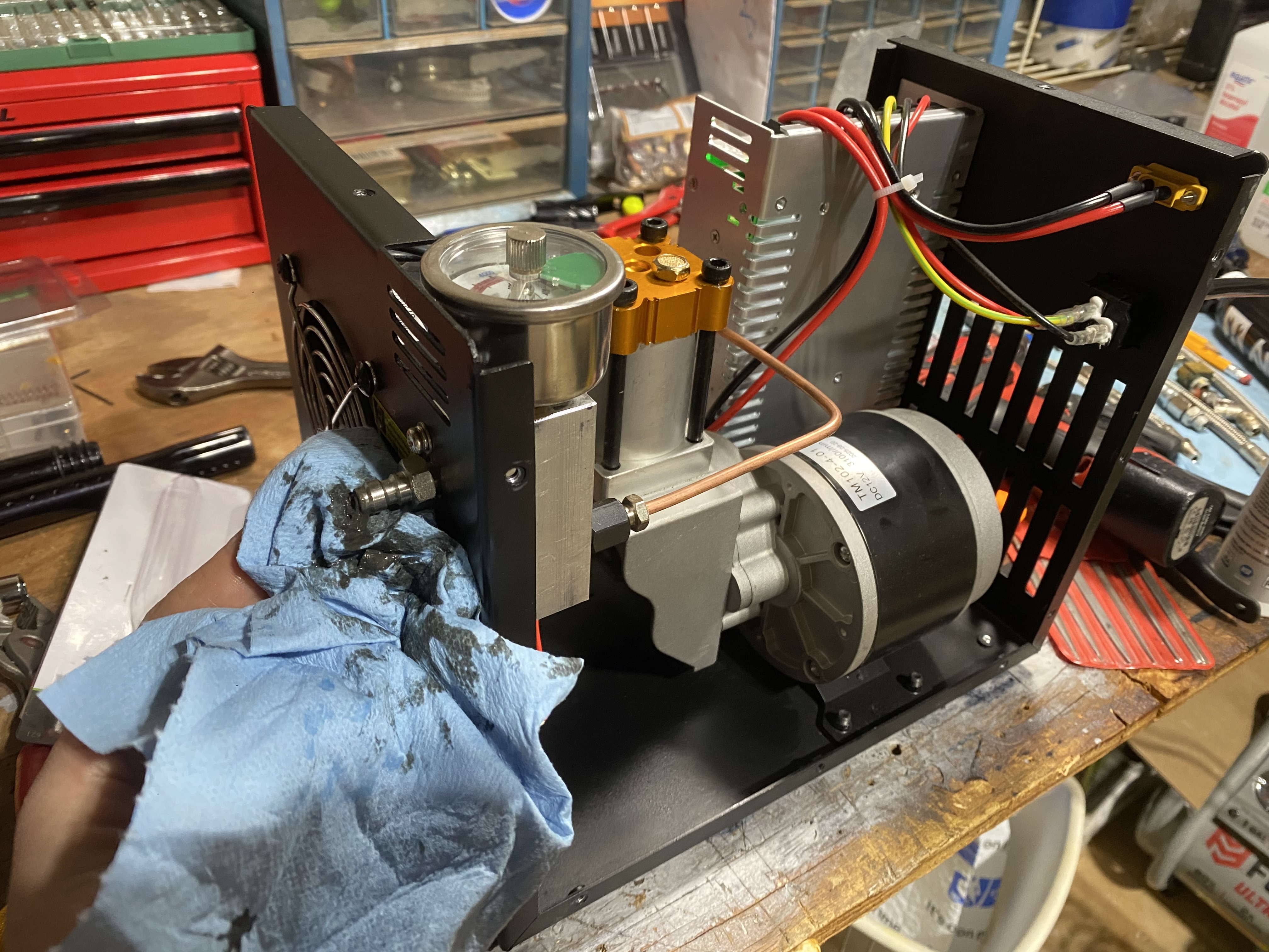

            I have the Spritech 4500 PSI compressor. I've filled my 48/3k tank about 4 times now and it's done a fine job.
            I did notice on the second to last fill that it was spitting out a lot of moisture at the pressure relief valve. I started pumping air without a tank attached and it was shooting water out. Switched out the filter inside the fill hose and that seems to have corrected that behavior.
            I'd imagine there is an uncontrollable amount of moisture accumulating inside the pump simply because there is no filter at the inlet, only the outlet. I plan on disassembling it after another fill or two to see what's going on and if it's causing any premature damage that will shorten the lifespan. It was a $160 compressor so I have my expectations set accordingly.
