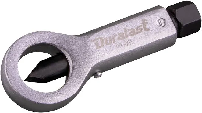

                      What if you rounded off the business end of a nut splitter with reasonably close matching diameter, and stuck an oak dowel inside barrel whilst cranking for good measure?

                        No. The "anvil" needs to be directly opposite the "punch". Trying to do that on an open tube will simply distort or even crush the tube.
                        Keep in mind that in this case, with slip-fit SL barrels, the OD needs to stay very round. Make it egg-shaped or have raised portions and it no longer fits in the gun.
