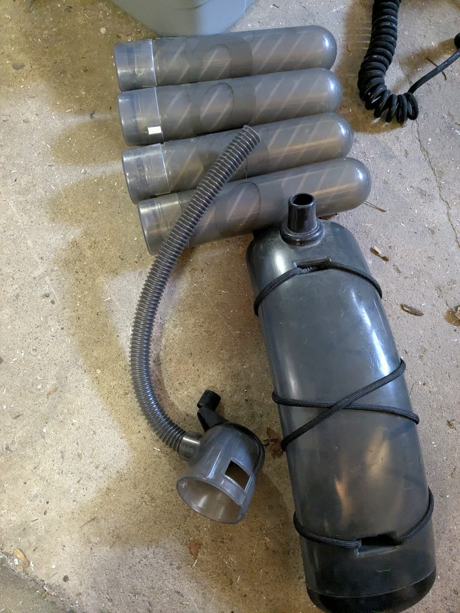

    Thinking about picking up a Q-loader.....
    It's currently mount3d to the bottom of a tippman A-5. What would I need to mount it onto an Automag Classic RT?

    Thats not an a5. Thats a loader branded marker in and of itself. Basically a tippmann, but in a nicely machined body.
    Id honestly just rock that thing. What's the seller asking for that kit? Id be interested in the marker if it was cheap enough. I think they are anodizable.
    But to answer your question. You would likely need to fab a new mount tab to work between the mag vasa mount, and rail. Or a clamp mount that grips the vasa itself. Then a new power feed plug assuming you have a power feed body. ( like a warp plug) and or associated elbows to get into the feedneck.
    On that note, and member here rutz777 bought the old stock of q loader kits. And he sells them on his website. You could buy a new kit and affix it to the mag rather than take that q loader and disassemble it.

      That is an Qloader SSI paintball marker, it uses A5 internals and is essentially a body kit made to direct feed the Qloader pods from below.

      He is asking $150 CAN for it. I was just thinking on using the q-loader and parting out the marker itself, but now that you point out that the q-loader is part of the marker, I am going to have to rethink it.

        I wouldn't frame it as the qloader being part of the gun. The socket and pod could be moved to another gun. It's just that the gun is designed from the ground up to use the Pods. So, whoever buys the gun either needs the pods or, has another idea in mind to feed the gun.

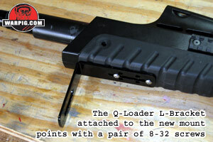

        I was able to mount one to a pieced together Longbow a couple years ago. Cant find any photos at the moment, but I used the same bracket as seen here:

          That's the mounting bracket that comes with the Custom Mounting Socket.

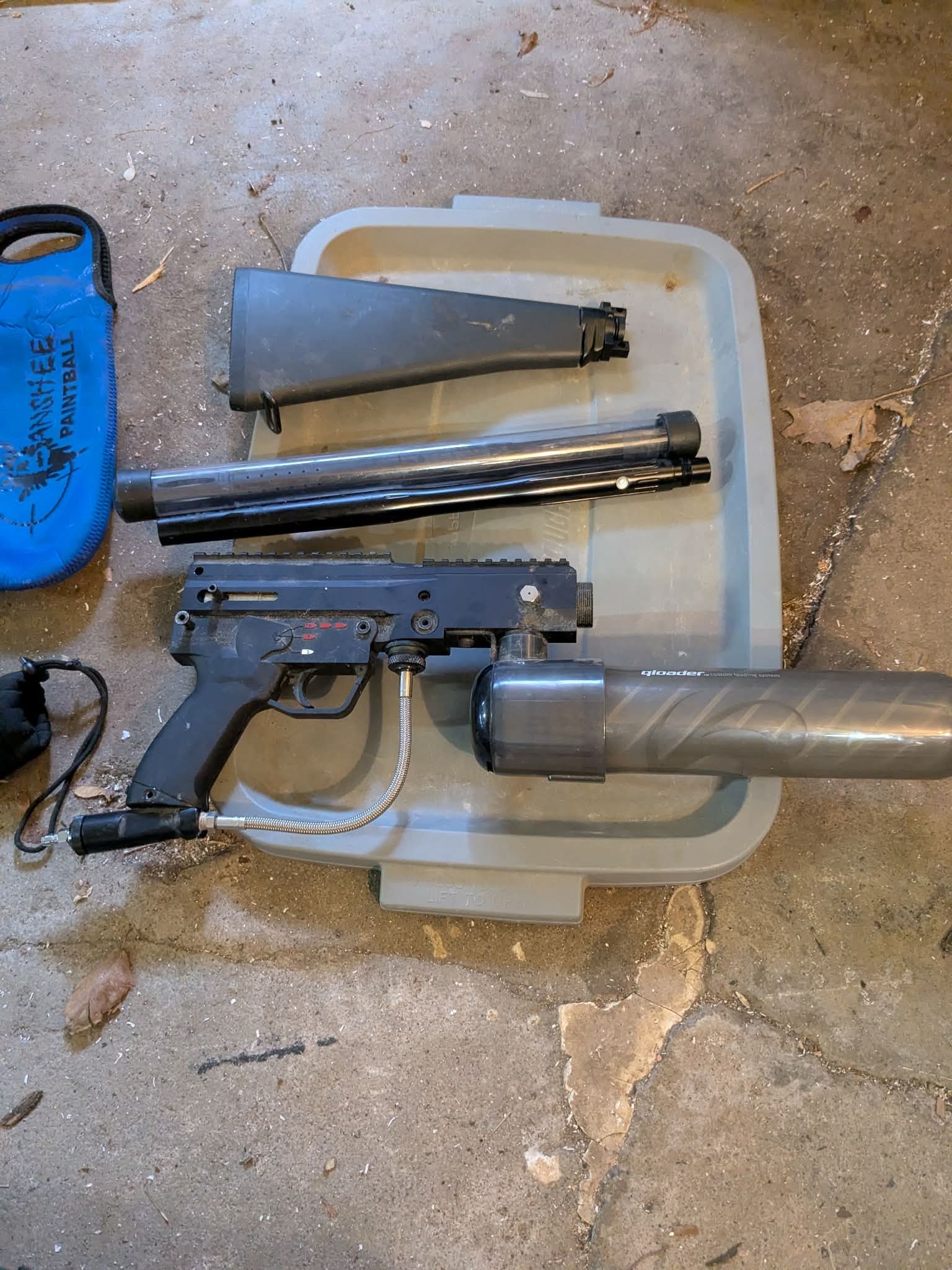

          Well, I grabbed it. Needs a little love but in amazing condition for it being as old as it is. Even came with an extra Smart Parts barrel that is just as long as the stock one. Now I just gotta figure out the E-Trigger and stuff as that why he sold it.
          He said he bought it, it worked for 1 game and the trigger stopped working, so he replaced it, played another game and again, the trigger stopped working. He put it up after that and there it sat. So it's possible that other then some potential dry firing. It's only seen maybe 3 games.
