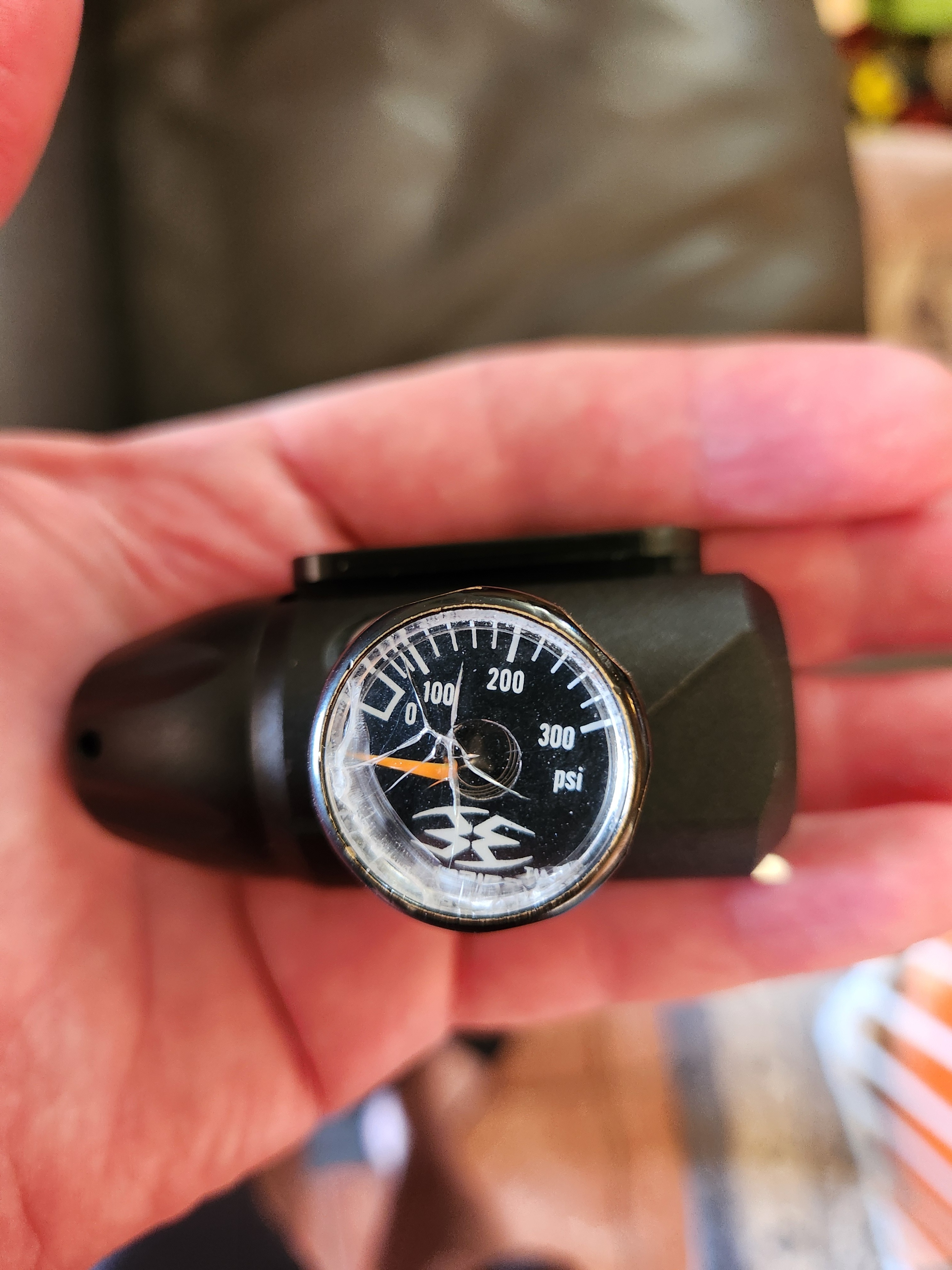

    I need to get a friend's mini running again, it was given to him broken and he doesn't know its history. It has a major leak from the regulator gauge that seems to have been over pressurized and broken. My question is, would a spare parts kit and gauge be all the parts I need to rebuild the reg or should I get a whole new reg assembly and hope nothing else is blow-out farther up the line?

    Should be fine to rebuild; you may need a special reg tool for those or a flathead with a notch in the middle. You could try another reg if you have one handy to troubleshoot, but I always heard they were good rebuildable regs minus the special tool

      Same as above. I think the GS specifically has a later gen reg that's easier to disassemble than the first minis

        Like tyronejk said, the later generation of Relay regulators can be taken apart with basic tools.
      • 6185
      If it's leaking through the gauge, replace the gauge and go from there.
      The regs were never meant to be user serviceable . Replace the gauge first and see if that fixes the problem. The rebuild kits for minis will NOT have any rings or parts for the reg because like I said, they were not intended to be serviced by the players.
      I had a g2p4 mini back in the day and tried, I did get most of the way into the reg but it was not easy. I certainly couldn't find any info on what size rings were in there at the time.
      If it were me, I'd replace the gauge first assuming you have one around, see if it will hold pressure. If it will give you a steady 200 psi then move on. If it won't, it might be worth getting a cheap reg off eBay first (one of the ones without the on/off for the ASA. ) to then diagnose any issues with the marker itself. If successful there then down the road you guys can replace the cheap ASA with the on/off version

        The later generation of Relay regulators are user serviceable and can be taken apart with basic tools. Parts are available for them (and most work in the older Relay regs).

          Not sure what his plan is. Hopefully he wants to sell it to me! I'd be willing to put a little money into it as a loaner. I might have a spare gauge to throw on to test Trbos theory.

              Just so you know, those gauges can be a real pain to get out! They are loctited in with something far stronger than needed! Try using some heat, but honestly, just expect to totally destroy the old gauge to get it out.

                Good to know. At least the old gauge it totally trashed already.
