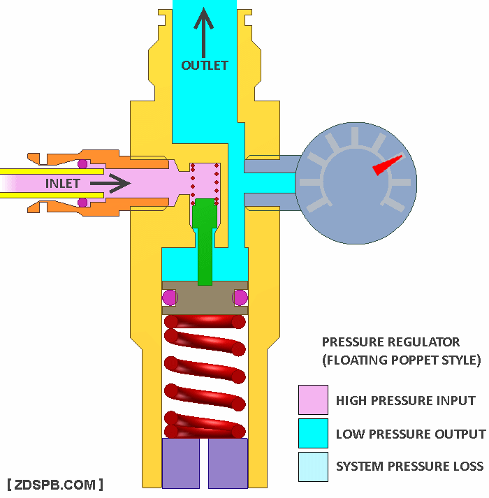

      https://www.zdspb.com/tech/misc/animations.html
      Near the bottom there are several different regulator animations.
        • 6185
        All the animations are based around macro line regs, he is wondering about the gas routing not the base design
        • Buff_phroggie
          Buff_phroggie commented
          Well they all fuction more or less the same, and the routing is different. He also said he doeant fully understand a cocker reg in a comment.
      • tyronejk
        • Nov 2023
        • 383
        This animation is 90% the same as the hoseless Bob Long regs, except that the outlet is the inner channel shocker_monkey posted above and the inlet is the outer ring channel (I'm also not 100% sure, could be flipped).

        Thank you guys for the diagrams and images - it's helped things click a lot!
