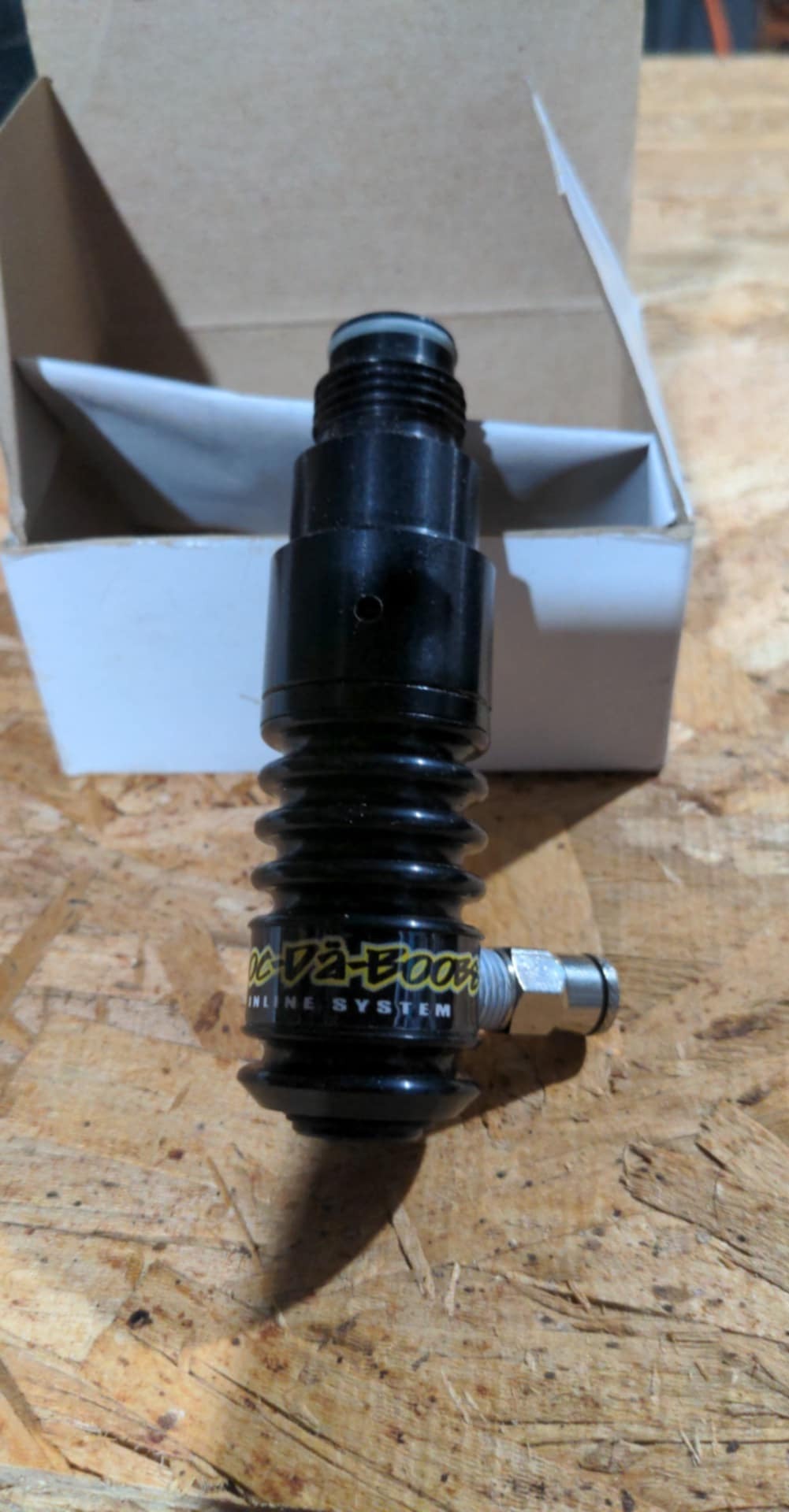

    There's quite literally hundreds of regs out there.....hell some people don't even remember anymore that were crazy hyped
    Pi regs? No? Nobody?
    How about a rocdaboobs?
    Then theres private labels.... .

        • 4456
        Too my rocdaboobs reg comment...
        Yes it was a thing
        • gnarlynick
          gnarlynick commented
          Does it do what it says on the tin?
          Ecapnation commented
          Can't say, never used it. This was given to dealers to test ultimately I don't think crossfire chose to manufacturer these.
        • coyote
          coyote commented
          They manufactured them.
          The actual retail model was "rock da bomb".
