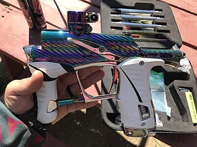

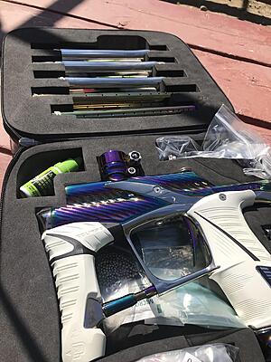

                      • 6378
                      Owner of AG Paintball won this. It was plated by someone else. It’s perfect to. Ballsy if you think about how much theses are worth without the finish work. Probably my favorite one I have seen done.
