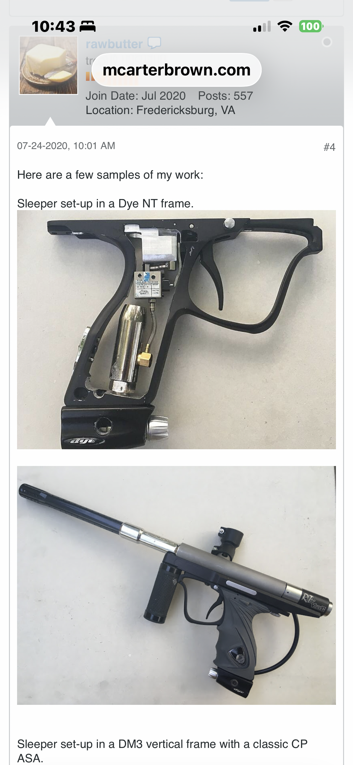

    For this build, I’d really like to use an Inception EZ ASA to keep the look cleaner and more modern. The challenge, of course, is that it uses a T‑slot instead of a flat mount. I found a build here that used a Dye frame and what looks like a T‑slot ASA (photo attached), which made me think this might be possible.

    Man...I haven't check MCB in months, and then I log in and see someone posting about a frame I made years ago. Wild.

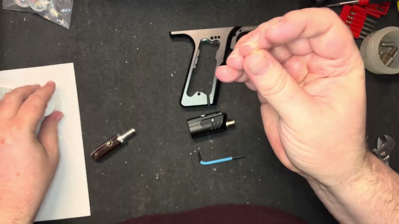

    Anyhow, I made that frame. It's not a T-slot on the bottom, it's a dovetail. But I have made frames with T-slots before. I have an unlisted video on YouTube I can link here. Just ignore all my rambling and try to focus on how the ASA is installed. With most sleeper set-ups (like Luke's), there's an o-ring between the frame and the ASA that gets squeezed to seal in the air when you screw in the ASA. But with dovetail or T-slot ASA sleeper builds, the o-ring is between the ASA and the LPR, not the frame. As you screw in the LPR from the top, it moves down and seals against the o-ring.
    In that video, you will notice that the base of the LPR looks different. That's because I had to make a replacement part myself. The original part isn't long enough to go through the bottom of a stock frame. But most other frames don't need that replacement part. You can use the bottom fitting that comes with the LPR. You just need to thread the 1/8 NPT threads from inside the frame towards the bottom. Not very fun.
    I've also made sleepers with Gear Drives. Those are a lot easier to do because they work more like the CP ASAs. You can just sandwich the o-ring seal between the ASA and the frame. The only tricky part is drilling an air channel in through the top of the Gear Drive. You have to make sure not to come through where there's usually an o-ring.
