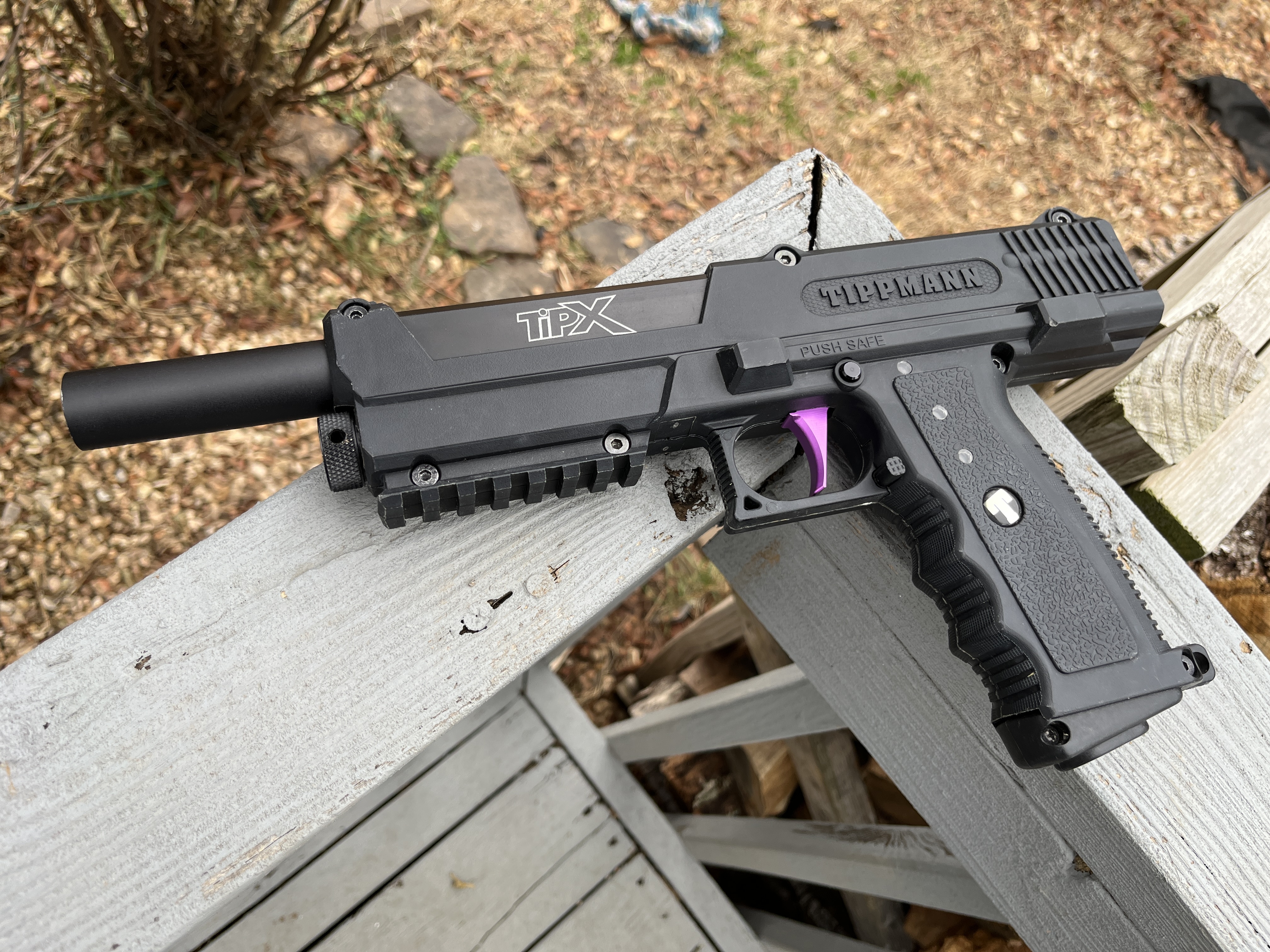

    So I have myself a tip X paintball pistol for cheap and it’s my first mag Fed, but I want to customize it to make it a short rifle. I know MCS The website has plenty of options though they are a bit pricey seem to be solid picks.
    so here’s my questions
    - for those who run mag fed how many mags do you carry?
    - there’s a lot of mag options for the tip X Standard, tippman 12, zeta 20 and alpha 26 rounds 3d printable which do you recommend?
    - should I run this on a tank or line i’ve never played with a line before so I don’t know what exactly would do differently?
    - are there any internal upgrades I should do on the my stock tipx ? (before I do all the other things)

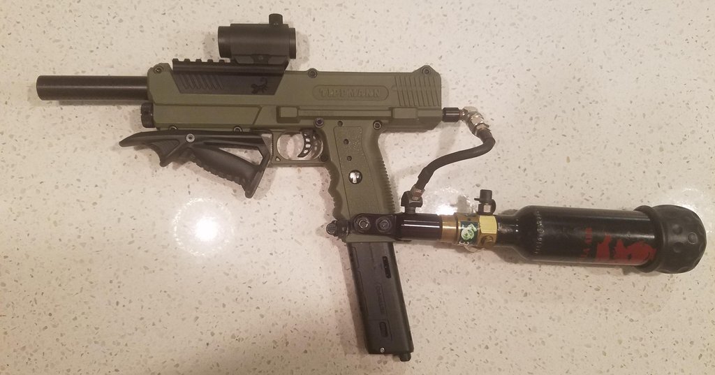

                  I have a lot of fun with mine and have enjoyed customizing it. The appeal for me is it being a pistol but I’ve considered a stock/foregrip/longer barrel before. The 12rd Tippman mags are my favorite. Have mag holsters on a vest that sit the mags upright so I can release one into my dump pouch and then slam it onto a new one. Always makes me think of a Lara Croft reload and it feels cool. 😎
                  I started breaking paint more often in mine but it was due to brittle detents. Keep those fresh and you should be alright most of the time.
                  Here’s some gameplay of me running one.
                  Here’s mine. Looking to get an extended Co2 knob since I only run it with 12grams.
                  https://stanchy.com/collections/tipx...o2-knob-medium
