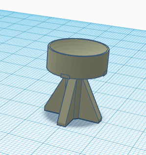

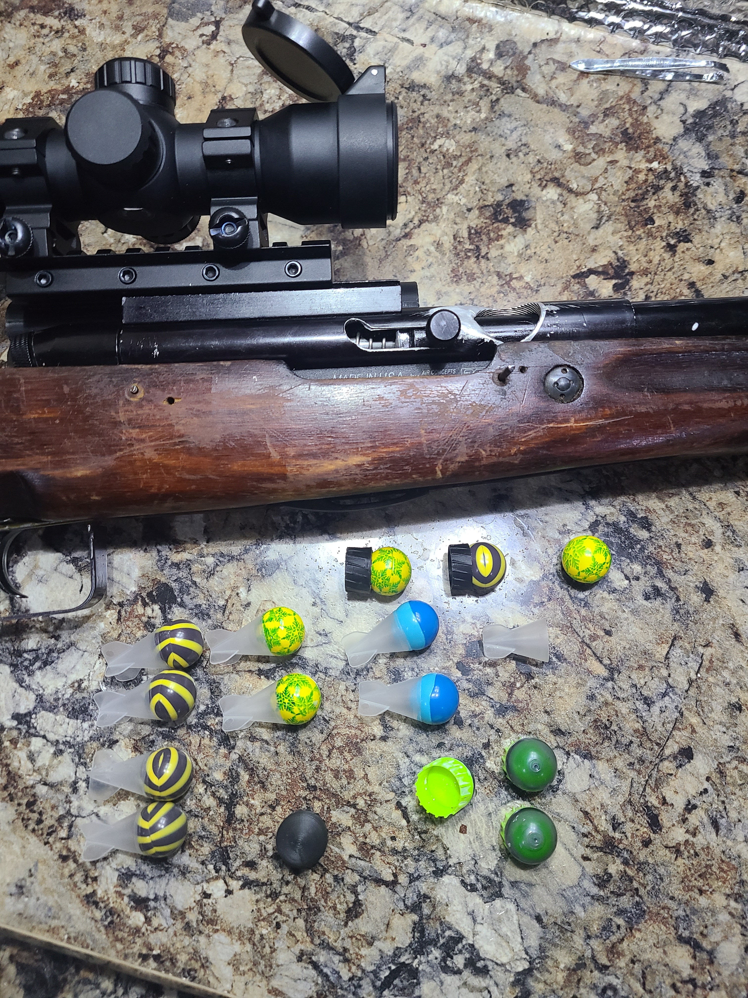

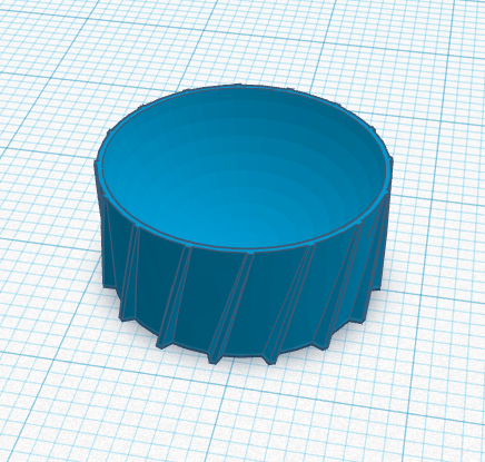

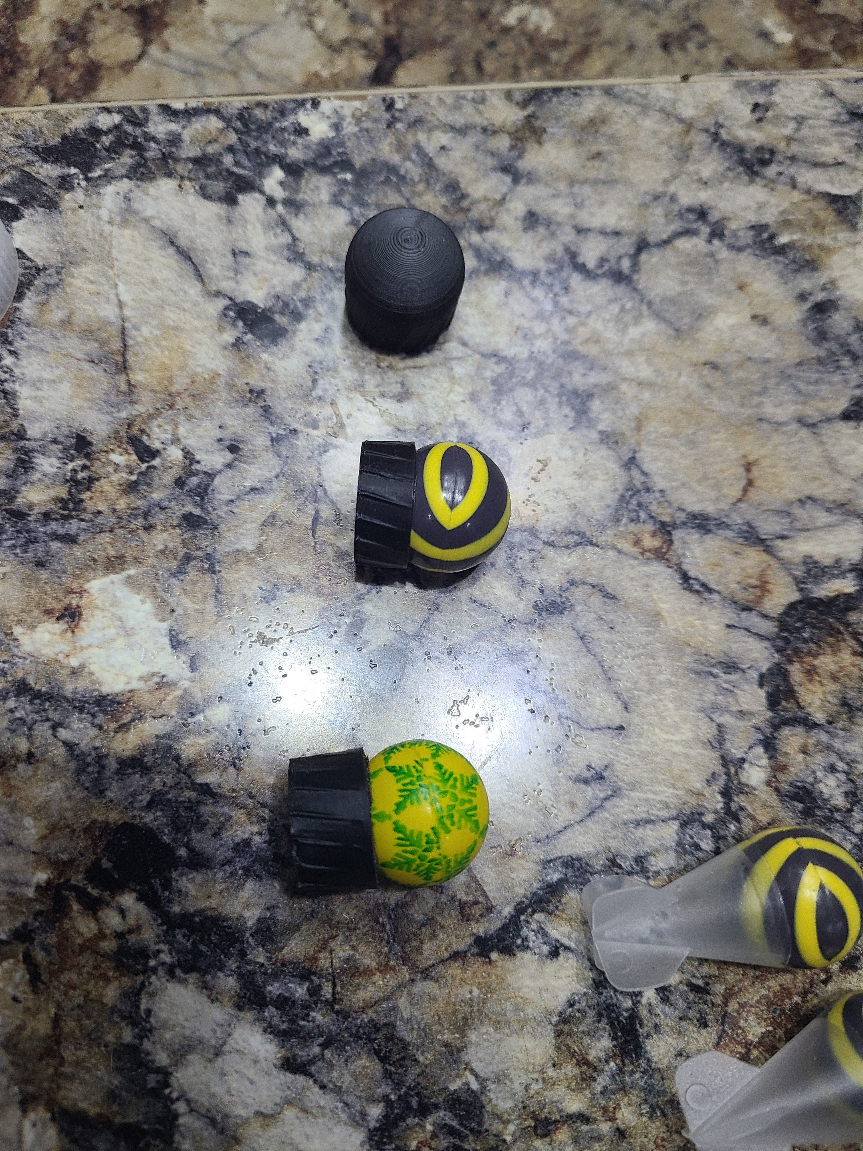

    Shaped projectiles

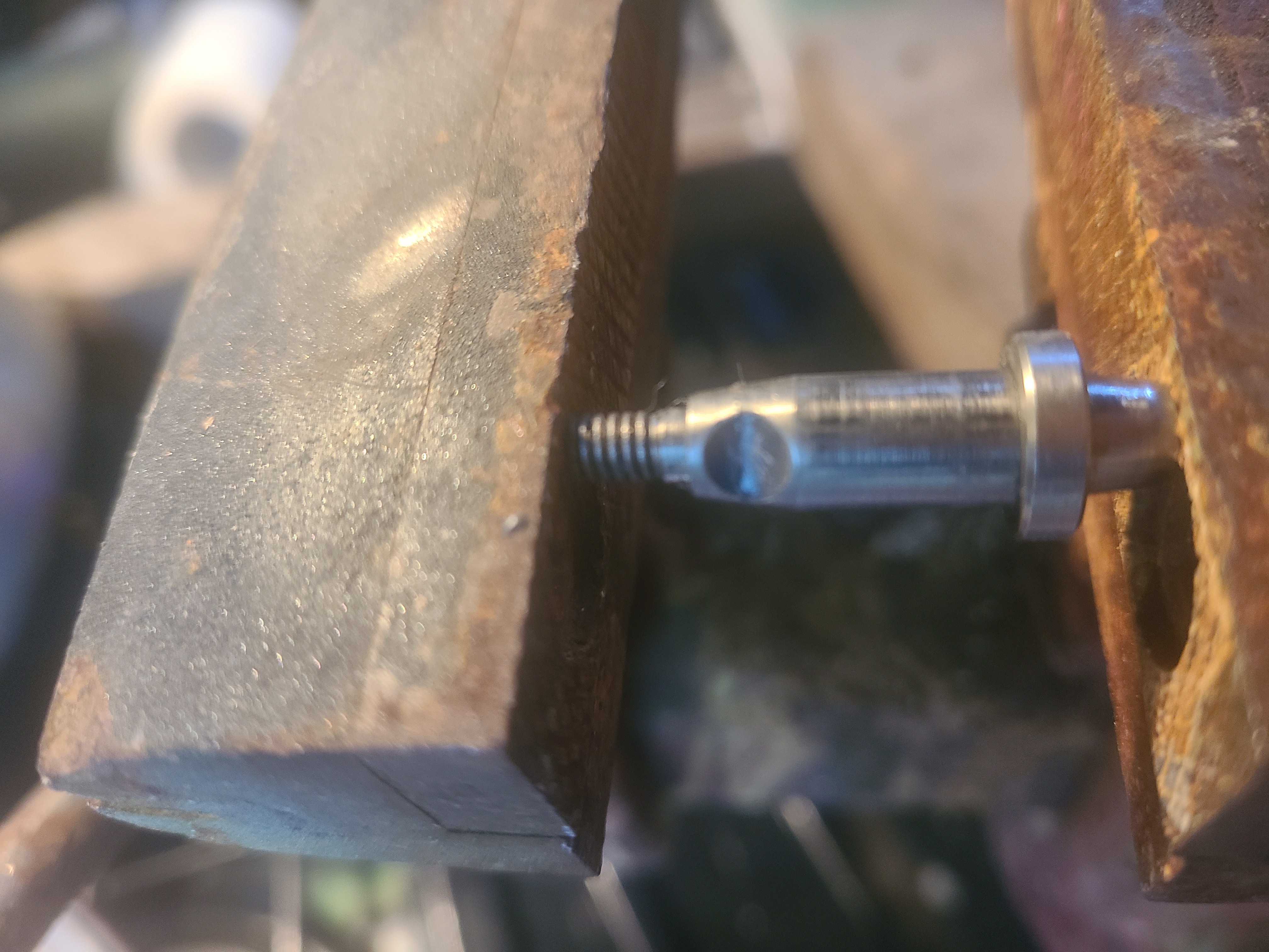

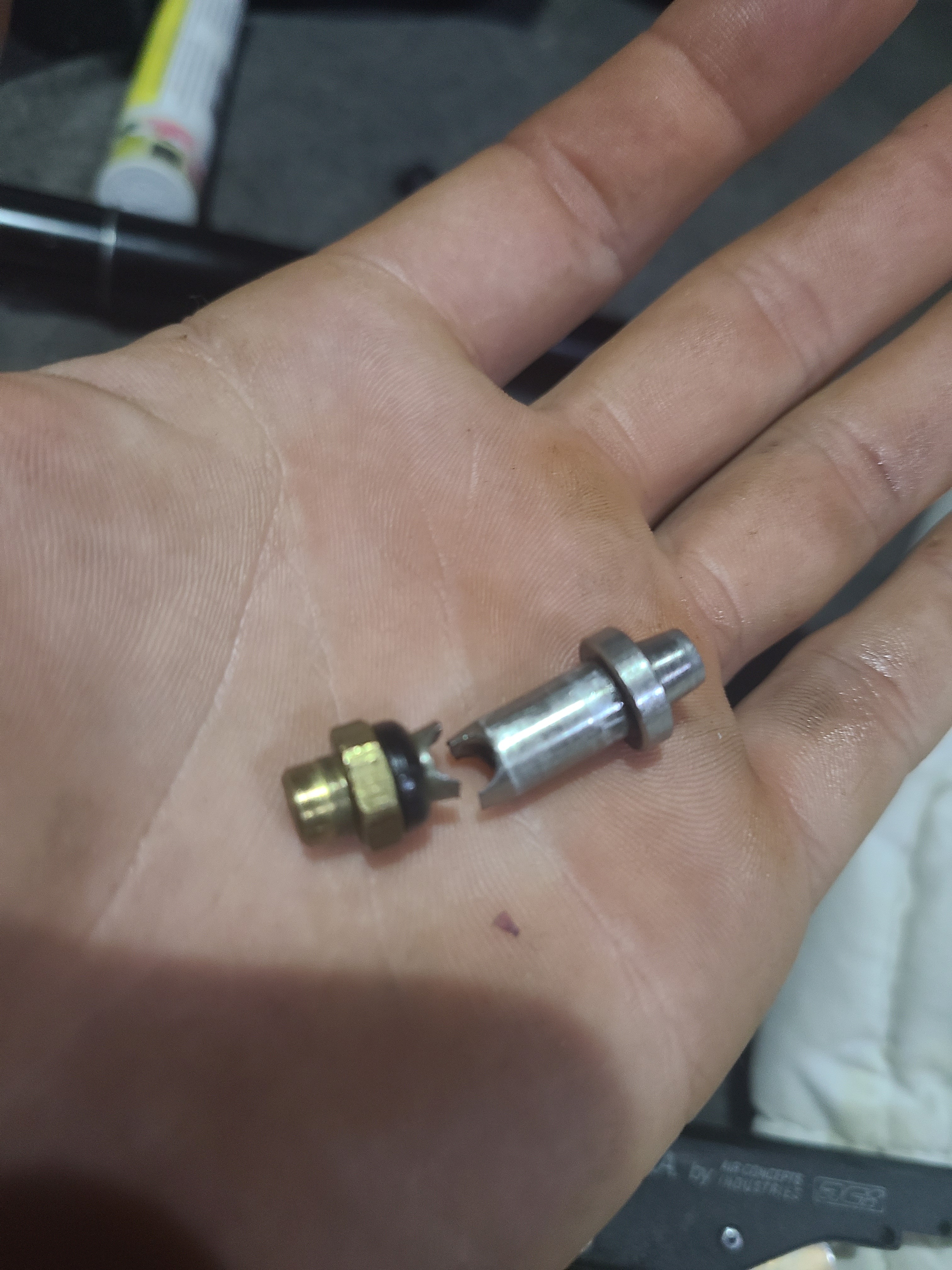

    Any one try different shaped projectiles? , I was going to but I broke my tracer dry firing it lol.

    Yeah that stainless steel work hardens over time and snaps at the thinnest part. Just one of the few things that needs a redesign for this to be the greatest Nelson of all time.

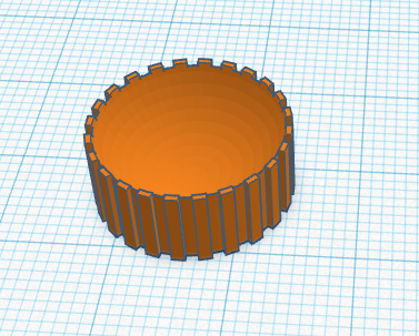

      I'm working on designing some myself. I just recently started shooting FSRs and wow I'm blown away! But theres no way I can pay those prices. We need an open source alternative. These look nice are they your design?
      • Snowpuff
        Snowpuff commented
        No the white ones are form like 15 years ago from scenario dreams I think they are called and the second picture I printed first strike fins and glued them on in 2 diffrent lengths

        Glued fins tend to rip off when they exit the barrel, sometimes tearing up the ball ...

          Very cool. I tried something very similar several years ago. I didn't have any luck, I tried a bunch of different designs and ended up on three that worked okay, the "dart" fins worked the best, they improved distance somehow, but accuracy was noticeably worse. I didn't have a marker that would properly shoot them, I would just unscrew the barrel put it in and shoot it, so it got very annoying. Keep plugging away though, I'd be interested to see what you come up with. If you want any of my designs to work off, pm me, but yours look better to be honest.

            The biggest problem with this approach is that if any of those fins actually worked (i.e. stayed attached to the projectile) they add additional to the mass of the impact. This is why the 121 rounds used .50 rounds.
            • Snowpuff
              Snowpuff commented
              Well ya just need to drop the velocity for object with slightly more mass
            • uv_halo
              uv_halo commented
              Snowpuff Sort of. An object with a higher sectional density will benefit in a similar way to First Strike rounds. It will retain whatever velocity it starts with, better than a paintball. Being more aerodynamic on top of this, magnifies the effect. Depending on how much lower you set the velocity, you will likely end up with a specific distance (and further) where the better flying projectile will still hit harder than the paintball at the same distance.

            Do people in general consider the newer (ha) style power tubes in Trracers to be more or less durable compared to the early ones? I only have had the original style and no issues.

              I jb welded it until Dan at baccipainttball gets back to me for a replacement. I'll try to post some videos
