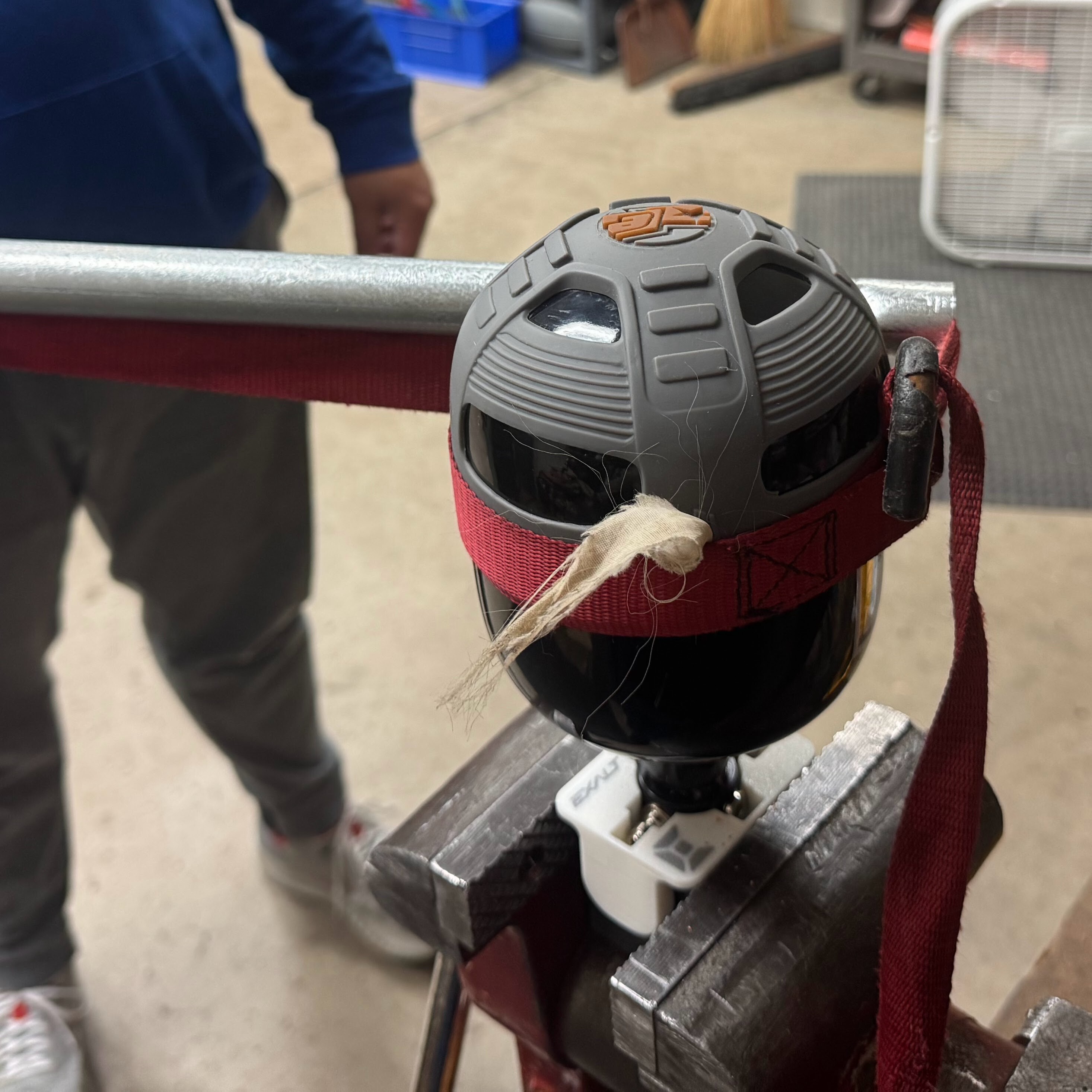

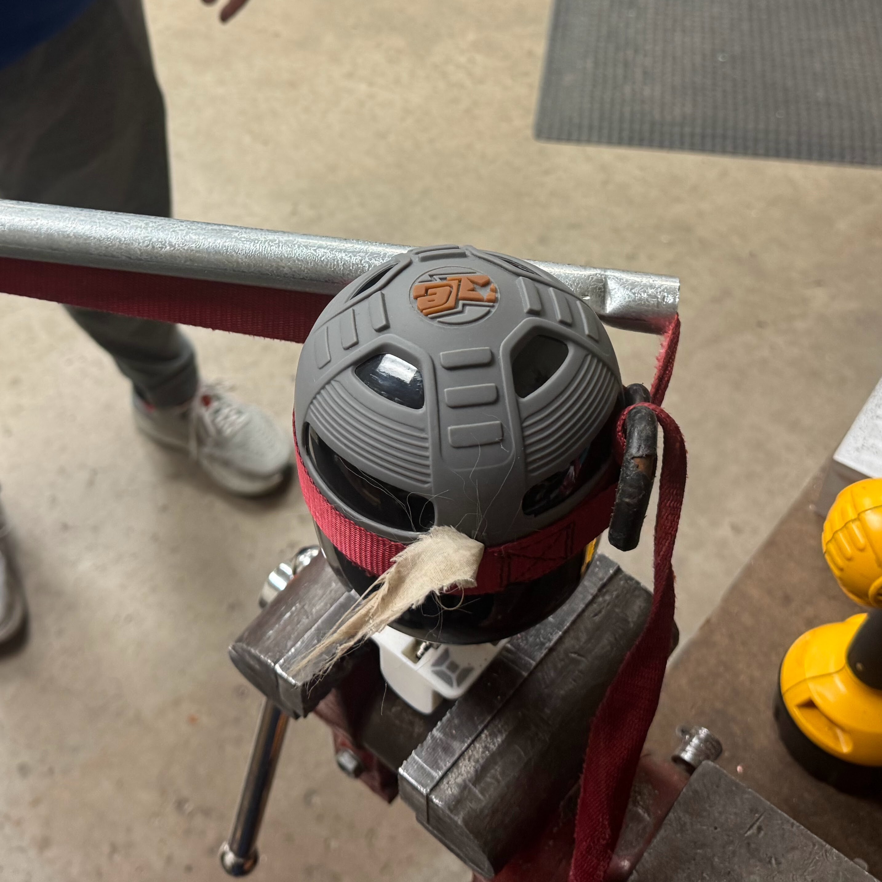

    Another coworker noticed the tank on my desk, and I lamented the issue. He was hellbent on a resolution. Used a 2½ ft. hollow aluminum pipe & a cargo strap to make the most redneck strap wrench I have ever seen. BEHOLD:
    So much red loctite. Whoever assembled these for First Strike should be ashamed of themselves.
    So, uh, in conclusion, the Exalt reg removal tool worked?

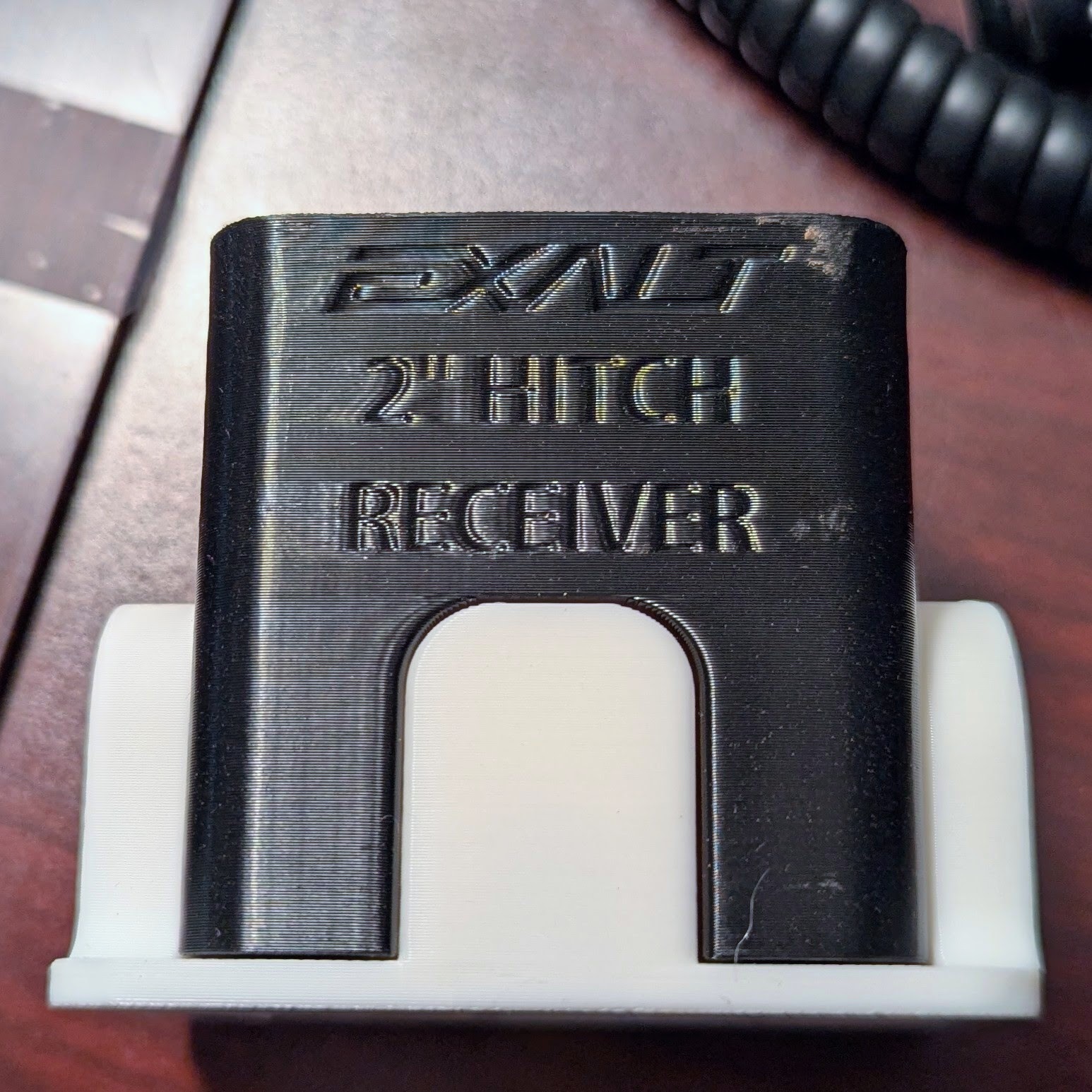

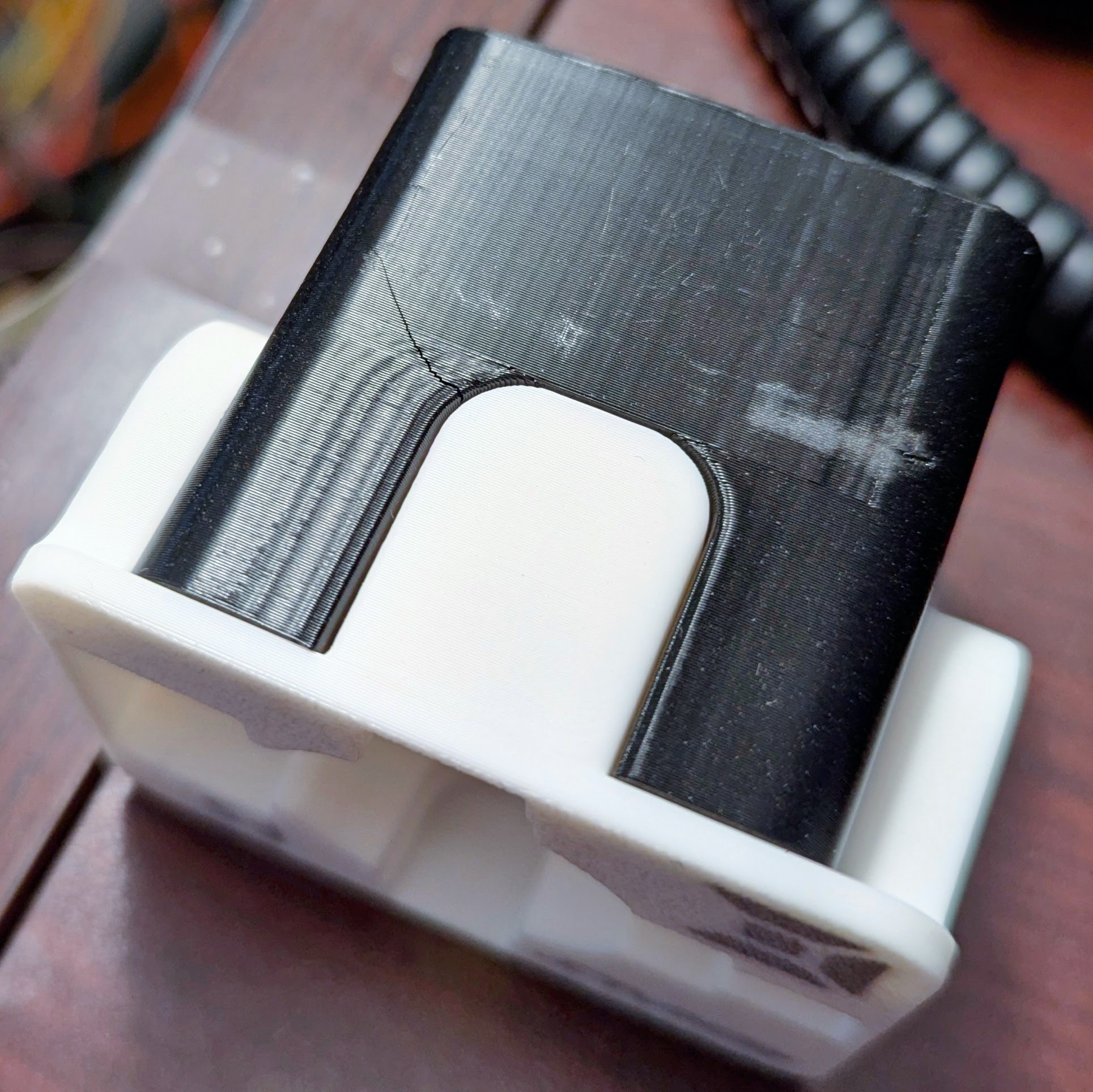

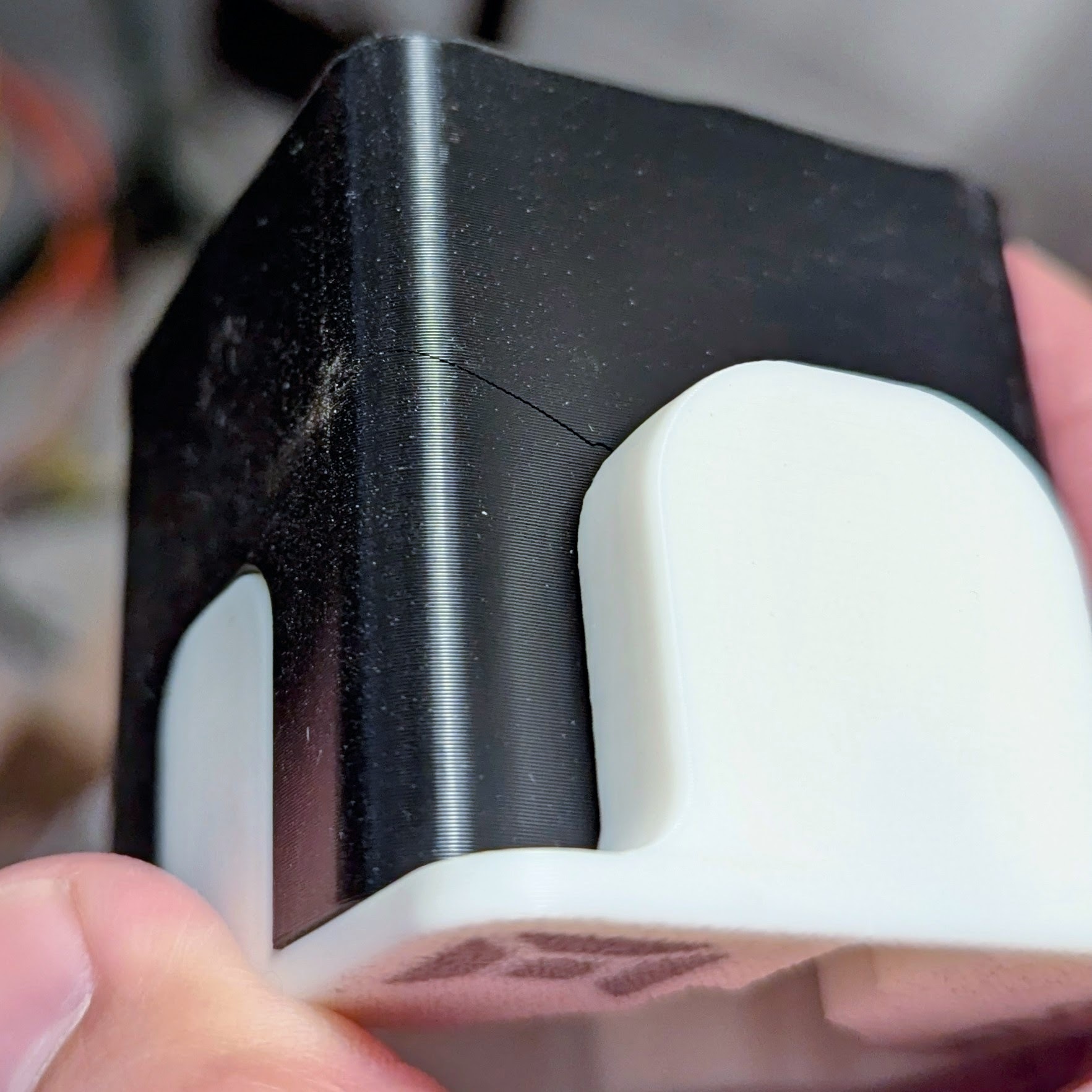

    So, I half-expected this tool to work fine, despite being 3D-printed. But this is the result of trying to unscrew a reg from a bottle, placing the black adaptor part into my truck's trailer hitch, and turning the bottle by hand. The problem, probably, is both the white and black parts need to be recessed into the hitch receiver, not just the black part.
    The reg did not come off.

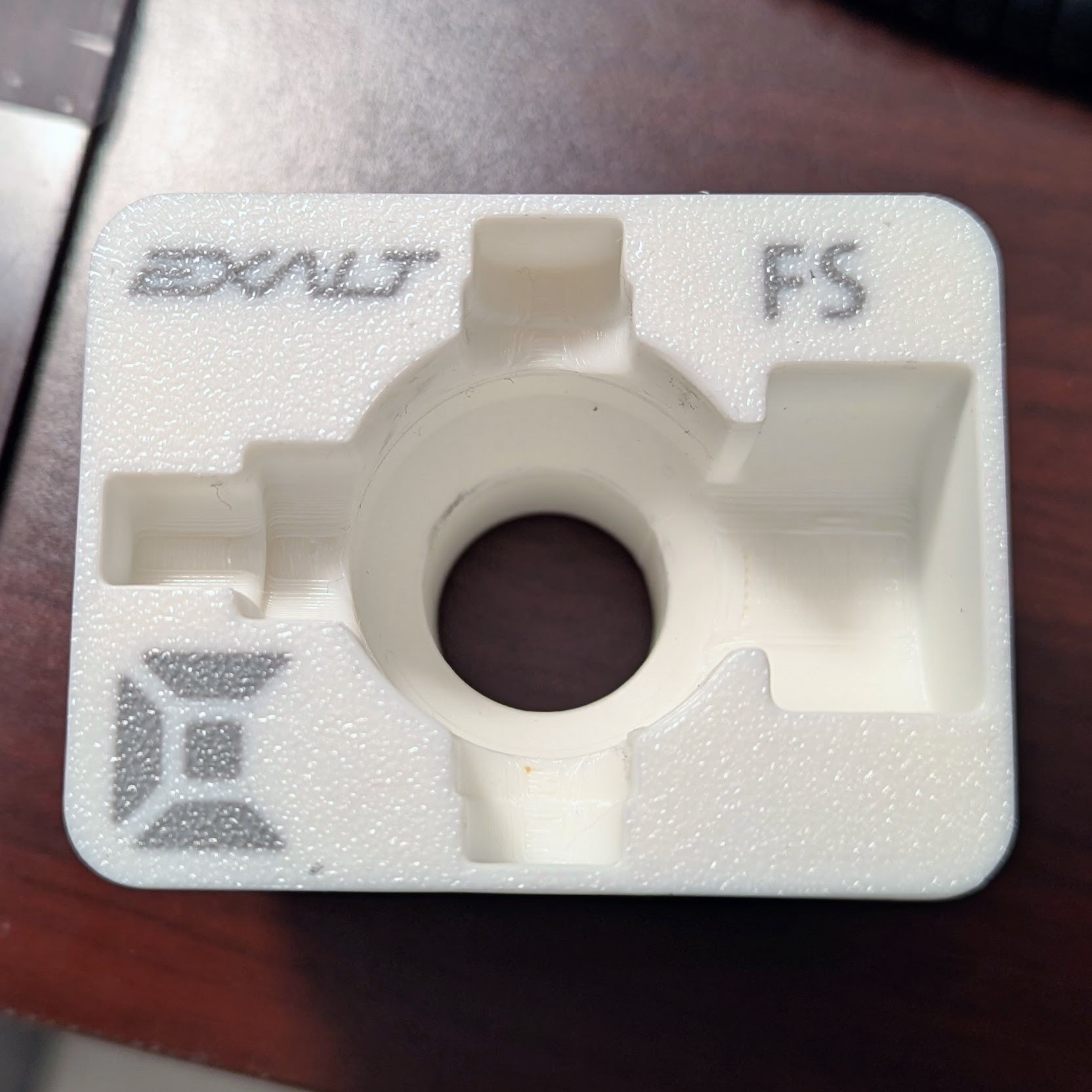

            Placed the Exalt tool in a vice between wood, still can't unscrew this reg, but at least it didn't crack the tool any further.
            Also tried a dead blow hammer to the nipple (we have one at work, apparently). Didn't budge.

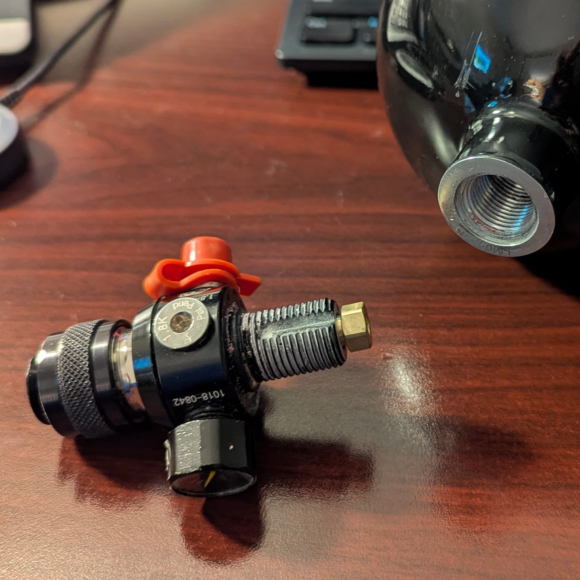

            This is beyond my understanding, i may actually have to send this off. The bottle itself needs hydro but i don't plan on using it - i really just want to use the reg on a newer bottle (this bottle is a peanut tank for my kid, but she doesn't play anymore).

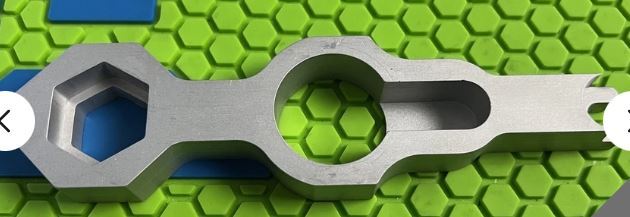

              dont remember who made these or when but it's been great for me. I clamp it in a vise and use a large strap wrench on bottle in the hardest cases.
              HK tool looks almost similar but it's trying to allow you to leave parts on and that's where I feel a lot of these devices fail / are incompatible.
              I wanted to leave parts on too at first, but it's really just faster to pull everything off and get it over with most of the time

                I ordered an UNDR Bear Claw, which has spots for different tools to gain leverage (hex neck for crescent wrenches, slots for shoving rod things like screwdrivers).

              Well. Refer to first post for an update. Success.

                I used one of those over the weekend at supergame. I'm not a fan of pulling off everything to get the reg off the tank but I do have to say that tool is well thought out at least
                • mercpb
                  mercpb commented
                  yea on-the-field it's definitely more of a PITA to pull all hardware. I'm usually using this at-workbench and probably rebuilding the reg anyway, when I pull it.....

                I'm impressed that that 3D printed part withstood the forces from that big cheater bar
                • nerdcore
                  nerdcore commented
                  There are spots where the burst disks & fill nipple dug into the white plastic portion, but instead of cracking, the plastic is just dented or smooshed. A vice is definitely the best use for this particular tool.
