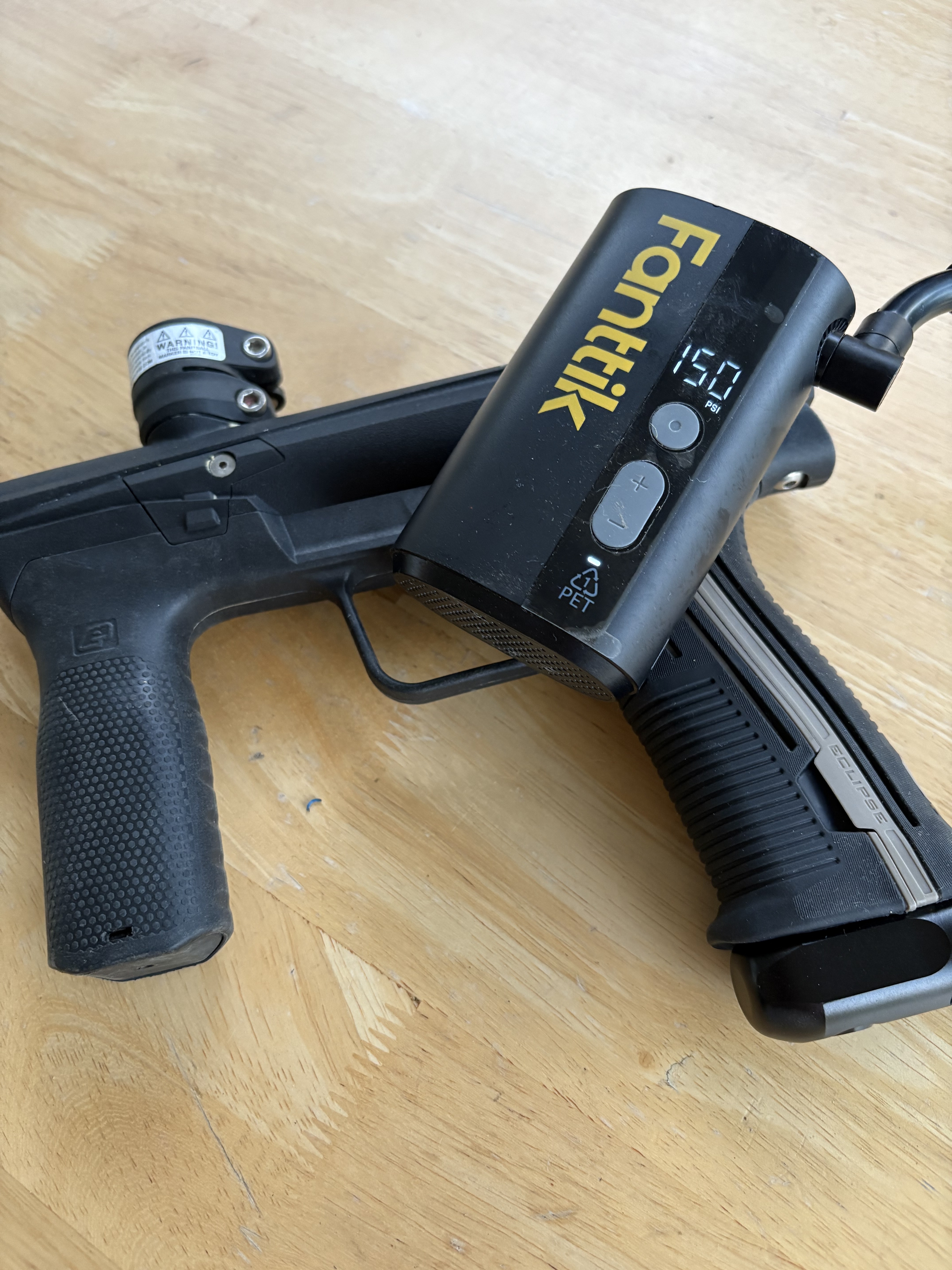

    IMG_0811.jpg Greetings, I’ve been seeing these portable tire inflator appear on my Amazon home page and observed the advertised max. pressure increasing. At 150psi, I was certain I could get a paintball out at a decent fps. Decades ago I ran an SP Ion off a Harbor Freight air compressor with velocities in the low 240 fps. So I ordered a portable air compressor (under $50) and was able to find Schrader to 1/8” fittings, and made an easy connection to an EMEK.
    Here are my insights:
    Pumping an EMEK (with short 6” hose direct to ASA) up to 150fps takes about 7-8 seconds.
    With the EMEK velocity adjuster all the way out (max setting), paintball velocity was 260fps. A second shot was not possible, the portable inflator showed a pressure drop to 80-100psi.
    Fittings were sealed nicely, I think a leak is around the Schrader area. This meant a shot had to be taken as soon as the portable compressor reached the 150psi max.
    Future experiments:
    I’m thinking an old school expansion chamber can act as a reservoir. Portable air compressor reaching the 150psi max will take longer yet follow up shots might be faster.

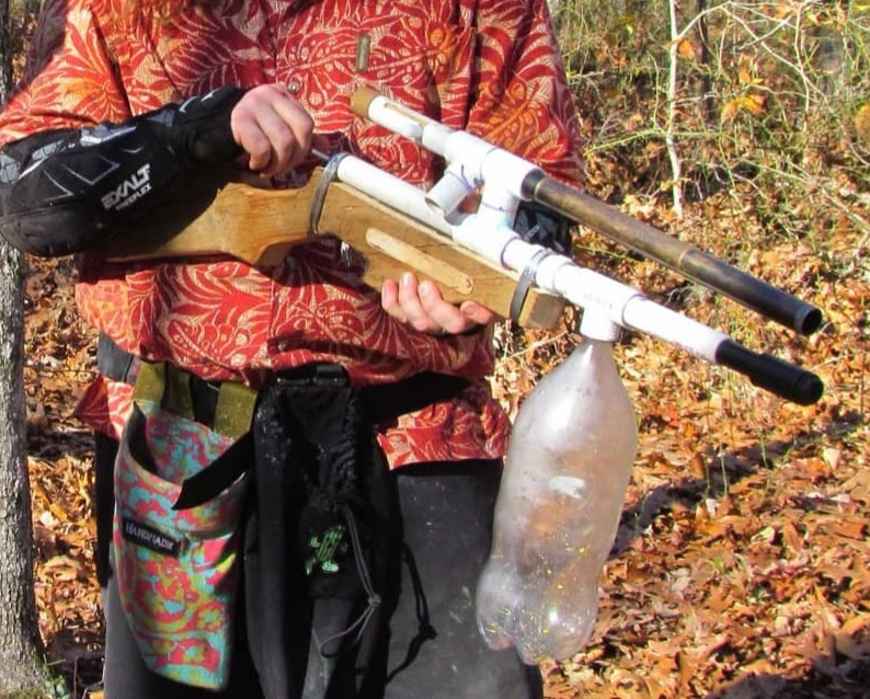

                I would definitely play this style of game. I love wacky ideas like this. And as impactfour mentioned, yes i did build a gun that used a bicycle pump and i got very similar velocities to you
