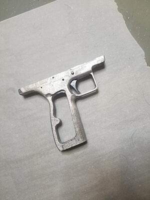

            Pencil and paper is cool, I did that type of thing to make an 86 spyder frame. Some people call that kitbashing. I made a replica ccm 86 frame cut it in half then cut up a spyder frame and mated the 2 then I made a mold of that shape and cast it out of aluminium. As for quantity and cost it really wouldn't be to make money just a fun project for me and maybe a few other people if they wanted it. I've found with things in life once you try making money off of something in takes the fun out of it.

              Fascinating. A cast aluminum frame. I haven't seen one of those in a while. How much does it cost to make something like that? And what's the surface finish like? Can you even anodize cast aluminum, or do you have to paint it?
                Maybe 20 bucks give or take. You can get excellent surface finish with ceramic investment casting, the frame in the photo was investment cast in a plaster silica mold so the surface finish isn't great but I polished it afterwards. You can anodize cast aluminum contrary to popular belief, it just has to be closer to the pure aluminum side of aluminum alloys. Alloys with alot of silicon wont anodize well if at all.
                  $20 is a great starting price point, although I would personally be willing to pay more for a better surface finish that can be anodized or cerakoted. If I wanted a frame like this for my old classic Automag, I wouldn't care much about the look, and a rough casting with black cerakote would be fine. But I wanted to add this frame to my nice ULE mag that's all gloss black, I would want the best surface finish possible.
                  What all are you comfortable doing? Can you do this ceramic investment casting, or were you just sharing information? If you're only comfortable with plaster silica molds, then that's what you should do and just tailor the frame for lower-end Automags.
                  Also, I like your idea of kit-bashing. I could maybe do something like that with a CZ75 frame and an Automag frame.

                      I just did the plaster for that cause its significantly cheaper. I have ceramics for shell casting. Message me if you wanna chat more about it .
                      Well, the more I think about it, the more I realize that you've already done 90% of the work. You could make a brand new frame based on a CZ75 grip, but it really wouldn't be that much different than the 86 Spyder frame you've already done. Would it? So, I think you should just adapt that frame to make it fit an Automag.
                      If you could make me a copy of that Spyder frame and send it to me, then I could toss it on my milling machine and make some modifications to make it AGD and SPAR valve compatible. I would only have to cut off the front part that sticks out, probably drill some new screw holes for mounting, hollow out the frame a little for the SPAR valve, and maybe do some work on the trigger. Then I could send that modified frame back to you, you could make a new ceramic casting, and then boom...you're done. This new frame wouldn't have a 1.5 trigger, but if you're just doing this for fun and you aren't planning on making a lot of them, there's no need to add that in if it isn't something you want.
