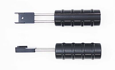

    I am looking for a pump kit for a mag I am curious if a CCI under cocking kit would be a good place to start
    it is fully self contained and it should be simple to add an arm for the bolt

    I'm working on modding a cocking pump kit onto mine. One thing to consider is the kit twisting. It might using that CCI unless the wings align perfectly with the rail or you install a second screw.

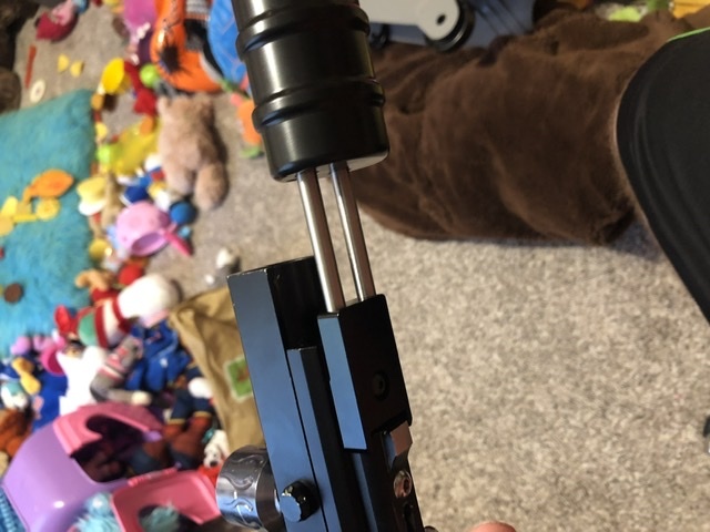

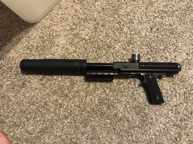

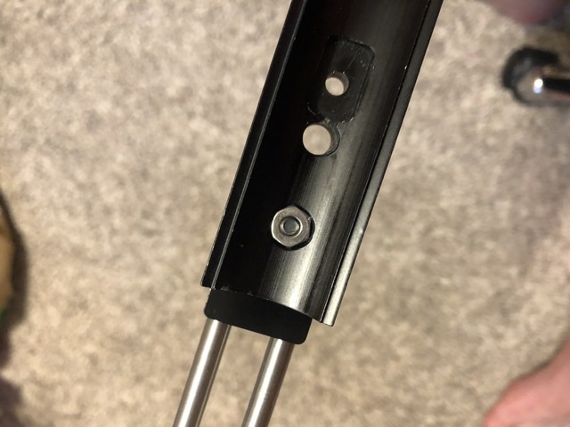

            It fits pretty good
            I pressed in a nut and add a 8/32 x 5/8 button head screw

                Is the barrel cover what's keeping the pump handle from coming off the front?
                • nobbie333
                  MCB Member for life
                  • 465
                  • Kansas City, Missouri
                  Right now yes but I plan to add a screw

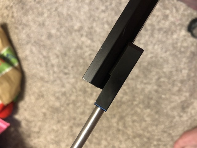

                    How well does the pump handle line up with the slot in the rail?
                    • nobbie333
                      MCB Member for life
                      • 465
                      Great and not so good
                      My rail is not cut for pump I need to take it to a buddy house so he so he can mill a channel after that it should be great🤞
                      or are you talking about the under side there is a little bit of play but can be fixed with Pledge and epoxy

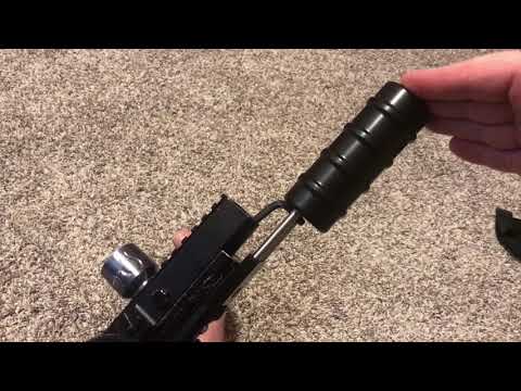

                          There one wave spring on the way
                          https://www.mcmaster.com/1561T46/
                          https://store.smalley.com/c100-m1-s17.html
                          McMaster is way easier to order from
                          • nobbie333
                            MCB Member for life
                            • 465
                            I got the wave spring today and had to test it out
