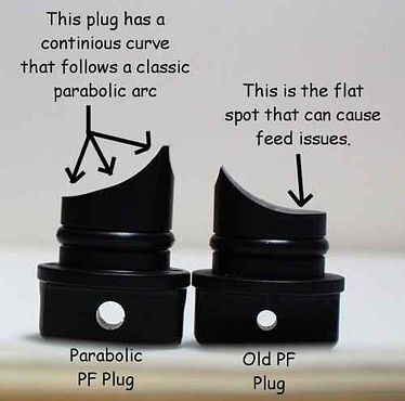

                      One other thing to note - you will absolutely need a parabolic feed plug on a PF Mag, so make sure it has been updated to that feed plug style.
                      I initially scoffed at this and then chopped every third ball in my RT with the old-style plug... it makes a difference.

                        I'll be sure to look for that. I have an eclipse one that looks pretty parabolic, but I don't know what the regular ones look like.
                          It's unlikely it will be parabolic if Eclipse... AGD didn't make them out of aluminum.

                          • pghp8ntballer
                            pghp8ntballer commented
                            Thank you for that pic. I always wondered what the difference was
