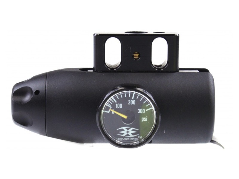

    Does anyone have experience using one of these? I imagine this would be a great pneumag regulator. I think it came out in 2010 so its very possible the ones in stock now will need rebuilding, just from sitting on a shelf.
  • Toestr
    • 2875
    • Poland, Onterrible
    Never done anything with these, but a cocker LPR off the top would be good. You'd need to figure out some sort of unregged output from the ASA though.
    • Olsson
      The Swedish Chef
      • 674
      • Gothenburg, Sweden
      The main reason you don't see this ASA in a pneumag build is that you don't have an outlet for the unregulated tank pressure. While it might be a clever solution to a hidden LPR build through the frame, if you look at the gauge, it only goes to 300 PSI. Not really suitable for an Automag valve.
        You can put a 1/2 inch ASA adapter on the back like https://palmerspursuit.com/collectio...tank-extension
        Granted people with longer arms would benefit over people with shorter arms.
          Nobody likes a smart ass, sonny Jim. That was way too clever for my liking. So clever that it may actually work, in fact.

            I've never seen on of these in person before. What does the passenger side look like? Is there enough meat on that side to add a second air port and tap that directly into where the tank threads in?
                  Unless they've changed something after the one I have, it has a overpressure vent on the opposite side. I modified one to use as a bottom line reg by plugging the output and drilling the hole out in the vent port. It's already 1/8npt threaded.
                          By any chance do you have pictures of this mod?
                          Being able to dual feed low and high pressure off the regulated ASA is ideal.
