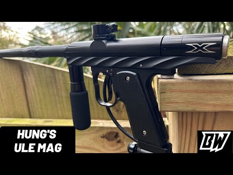

            Since we are talking about rting.....I took posted this yesterday...
