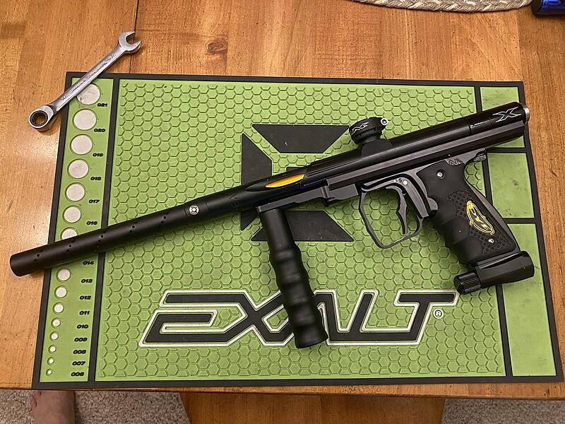

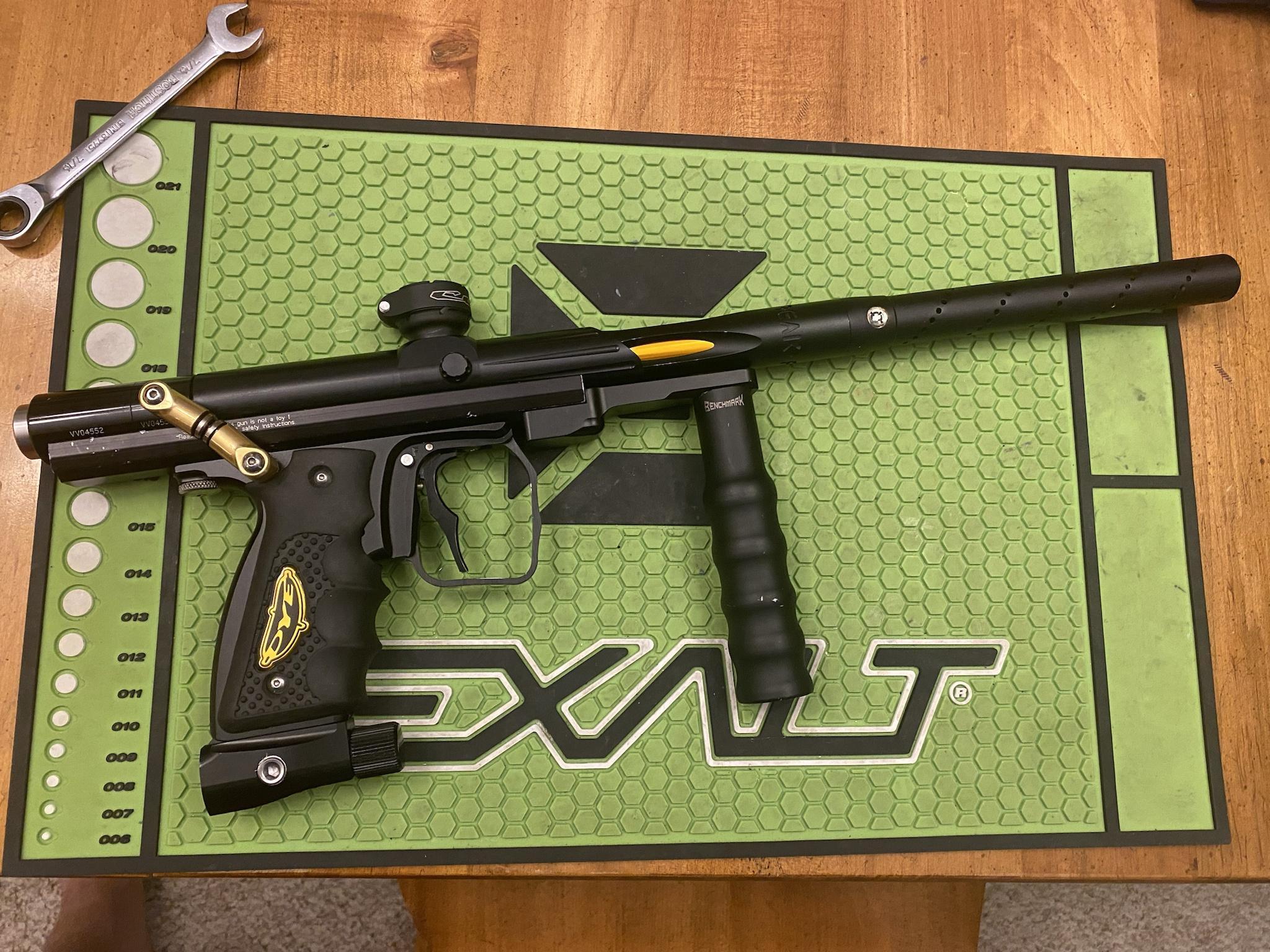

            ​I took the gun out back for testing, shot it over the chrono, and it's smooth and consistent as hell. In case anyone is wondering, here's the final result.
