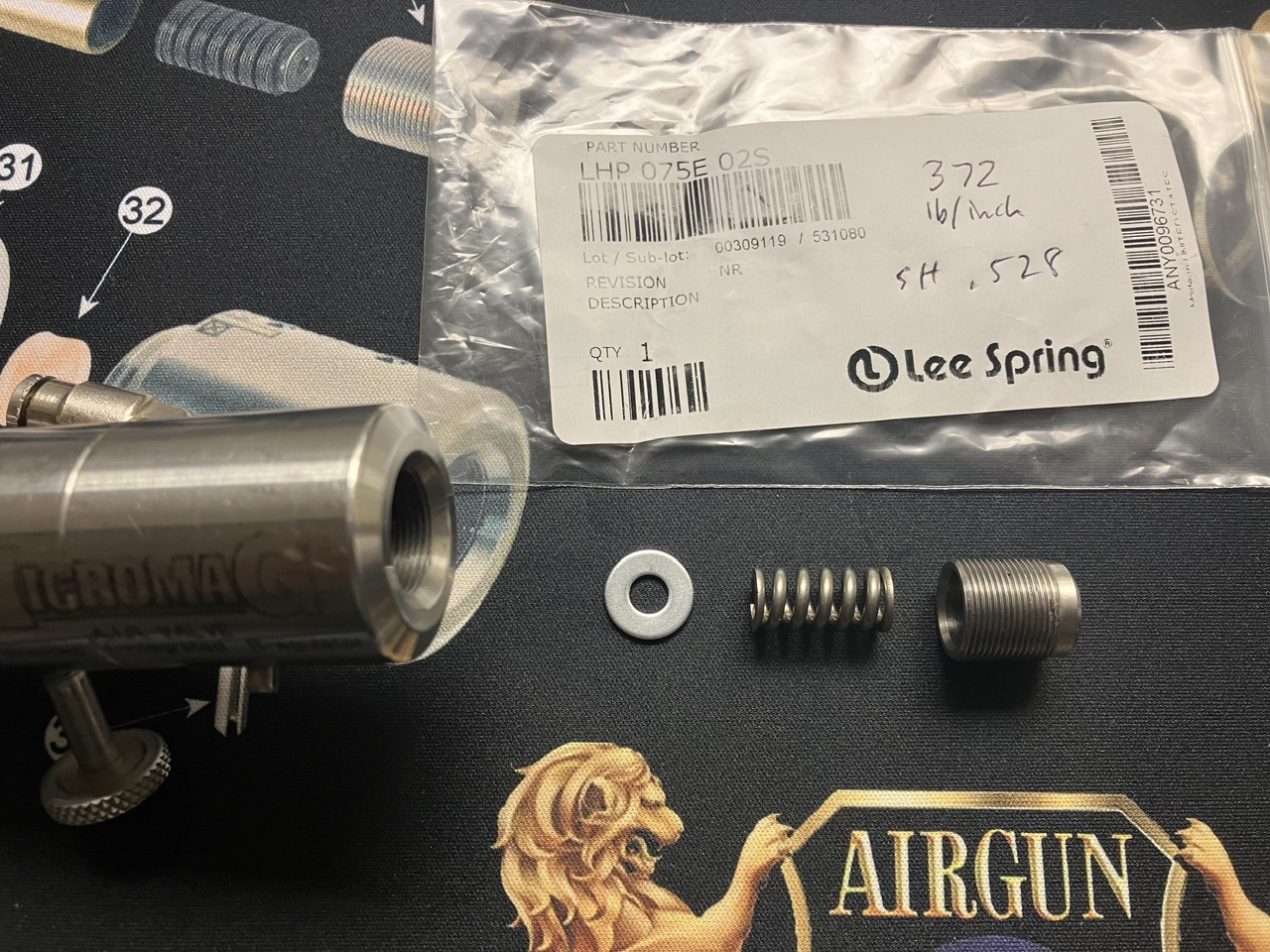

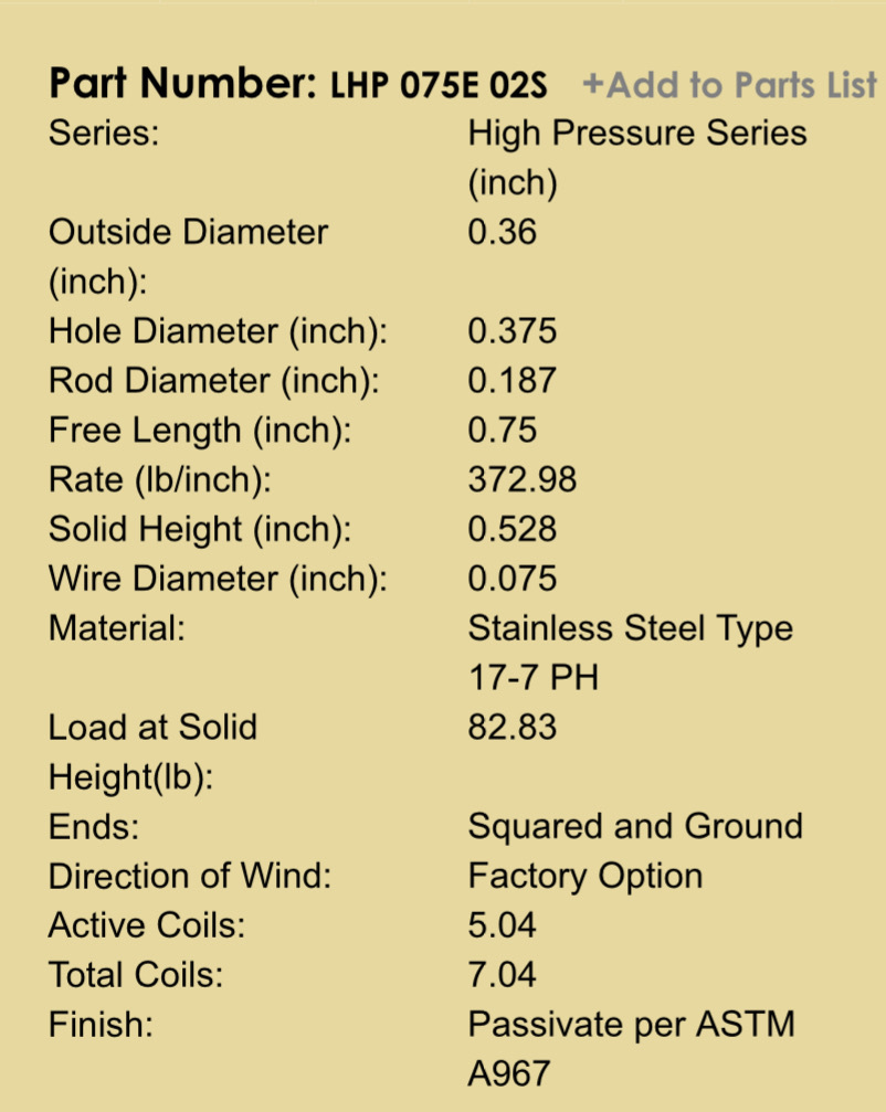

                  I was also messing around with this a little bit, but it got put on the back burner since I am currently moving. Nonetheless, I had purchased some stock compression springs from Lee Spring to try out. Here is what I learned.
                  A 1” inch spring is too long and makes it incredibly difficult to start threading the velocity adjuster back on. So I limited my search to springs that were about 3/4” long which is basically the length of a spring pack. I dropped a 1/2” fender washer on top of the piston to try and keep everything square.
                  The springs I bought all had a listed outside diameter of no more than .375”. There is a little wiggle room to allow for a very slightly bigger spring. Also, that comes out to about 9.5mm so finding a metric spring of about 10mm OD and about 20mm in length should work as well. You just have to convert the lbs/inch to N/mm.
                  Anyways, not knowing what the rate of the spring pack is, I just bought a selection of different springs ranging from just under 100 lbs/in up to 372 lbs/in. Almost none of them worked unless you bottomed them out basically making them useless. But, the spring rated at 372, I was able to get to work and still have a little bit of adjustment available. I was able to shoot and get velocities ranging from the 240s all the way up to 315 and still have just a small amount of adjustment left.
                  So I guess I spent a decent amount of money on a bunch of springs I can’t use, but at least learned that a spring of about 400 lbs/inch, might be a suitable replacement. I did find another spring on another sight that has a listed rate of over 530. I was considering picking one up.
                  The testing I was able to do was very limited. I am currently living in a hotel for the next six weeks so my ability to have access to my normal tools and equipment is limited as well as having a normal space to just shoot a few hundred rounds. I literally shot just a few rounds into a box in my hotel room to try this out, because I really wanted to know if it would work. I would be curious to know if one of these springs would hold up to thousands of shots.
                  Here are some pics of the spring I found if anyone else wanted to try it out. Also, the last pic is the spring I haven’t tried yet, but should fit. Not sure if it makes a difference, but I was using a lvl10 bolt.

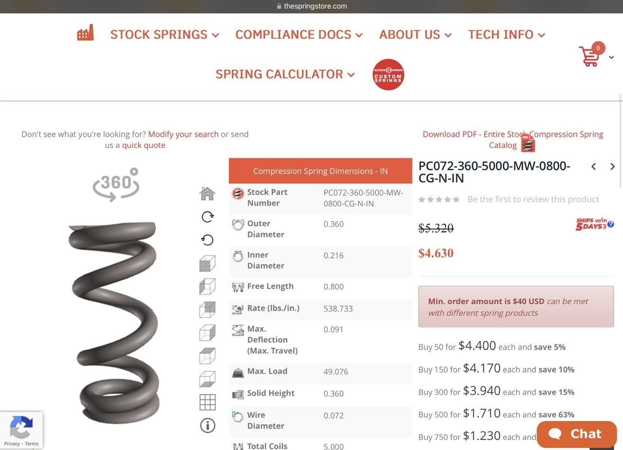

                    reporting back, I ordered the PC072-360-5000-MW-0800-CG-N-IN from thespringstore.com I was having issues getting it to shoot. I pretty much had to bury the adjuster to get it to shoot and even then it wasn't playing nice. I didn't even bother with paint. I am using a level 10 with rt on/off in the mag i tested.
                    so it looks like we need a heavier spring.

                  • rawbutter
                    trophy husband
                    • 562
                    • Fredericksburg, VA
                    I'm genuinely confused why the PC072-whatever spring didn't work when the LHP 075E 02S did, especially since the PC072 has a higher pound/inch rating. Maybe that's not as important as some of the other specs?
                    • wthomas333
                      wthomas333 commented
                      I also noticed the max load or load at solid numbers. The spring I used was about 82, whereas the other one was 49. That might be part of it.
                    • superman
                      superman commented
                      I agree, i think the load rating is the important part, not the spring rate.
