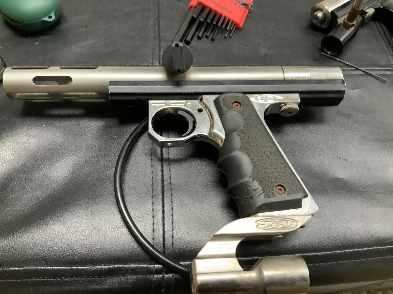

    Also sent this to AGD, but since it isn’t their frame I figured I’d ask here as well.
    Picked this up on Craigslist a few weeks ago and am finally getting to it. I know I’ll need a $25 parts kit to replace the seals, wire detents, and rusty spring, and a pack of foamies.
    This 32* (DYE?) frame doesn’t have a safety switch. Anyone know if one of the standard AGD safety rebuild kits will work with this grip frame? Or if not, where a safety switch kit could be found?

      I tried moving the safety over from my classic direct feed mag, but the fit was so tight I couldn’t operate the safety.

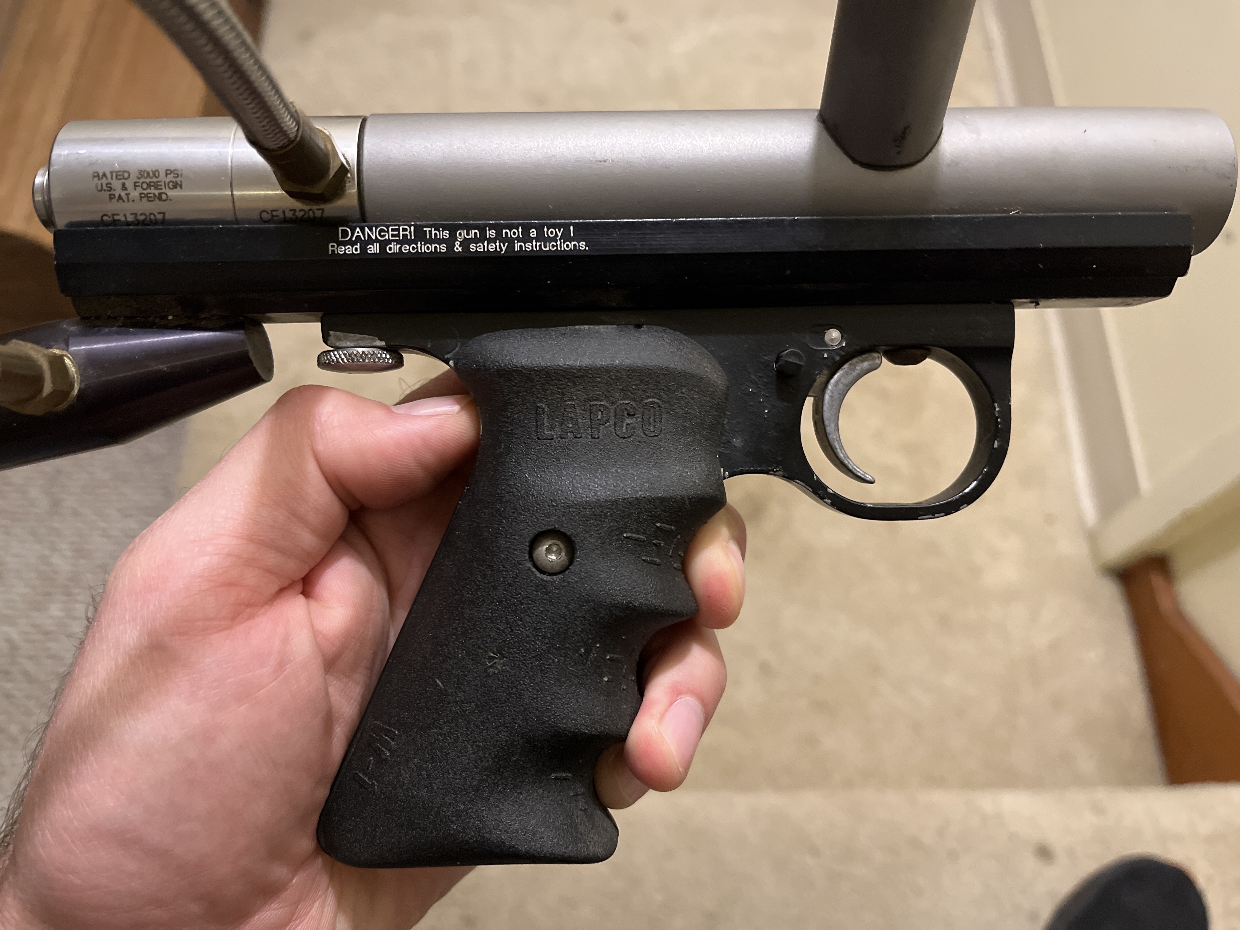

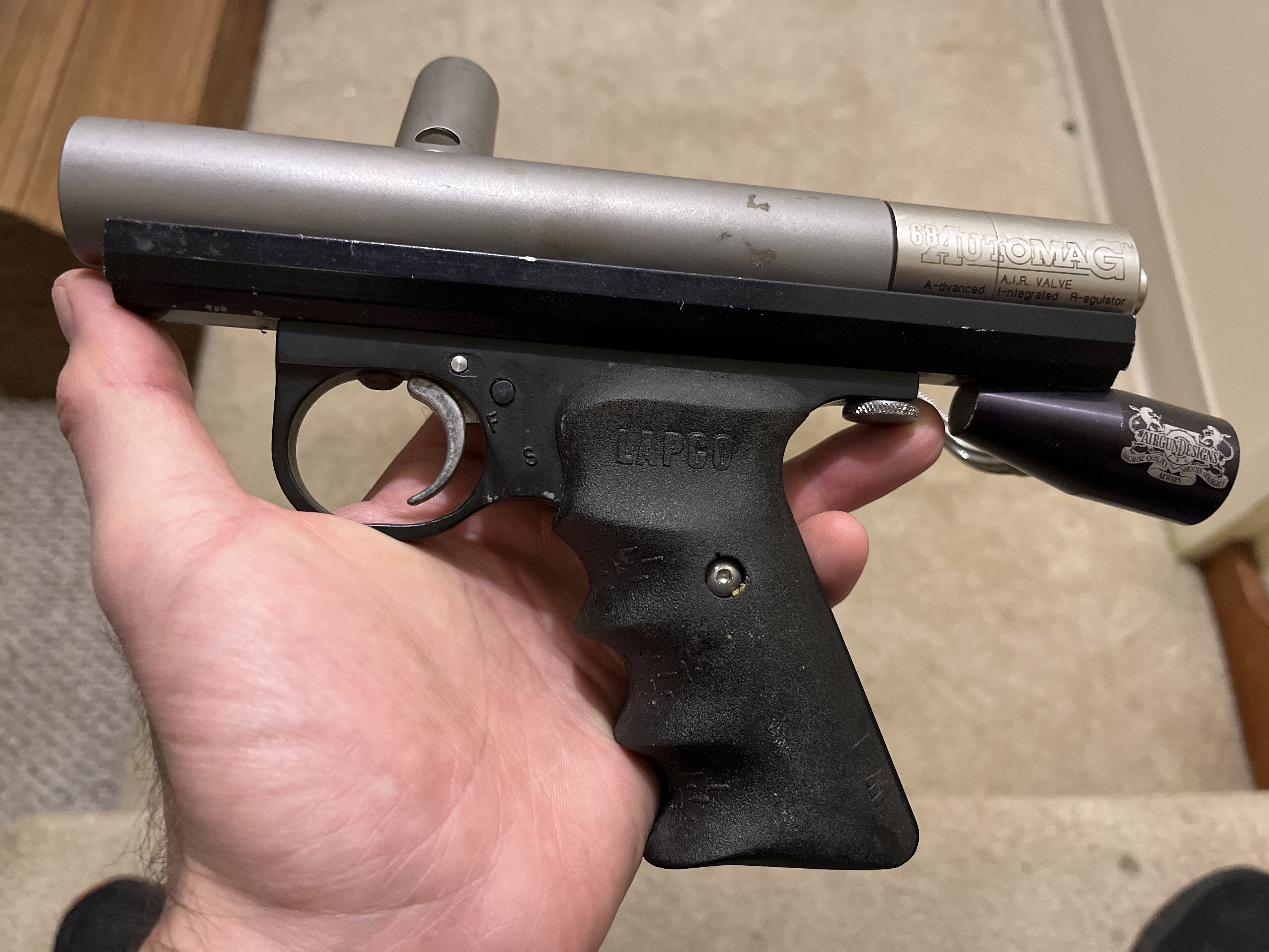

          Are the Intelli safeties made for the OG aluminum frames?​ Here’s the other mag I have. These are my first mags, so I’m not we’ll steeped in the lore, history, and part compatibility.

              I did think of one last line of attack on this - swapping the trigger itself. The 32* frame has a plastic trigger with a different shape. Maybe a stock metal trigger would work with the stock safety on the 32* frame. Will report back when I have time to swap things out.

            The safeties are all the same in the Dye, 32 degrees, and AGD frames. Some aftermarket frames were so poorly out of spec that they couldnt get the safety to work, or the sear hitting the frame was a problem too. Most needed some milling or hogging out to get them to work.
            • lhamilton1807
              lhamilton1807 commented
              Seemed like that was the issue. I could get the safety to click back & forth without the trigger installed but once I had everything installed it would jam up. Glad I’m not alone I guess
