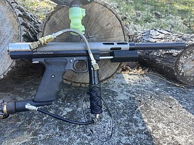

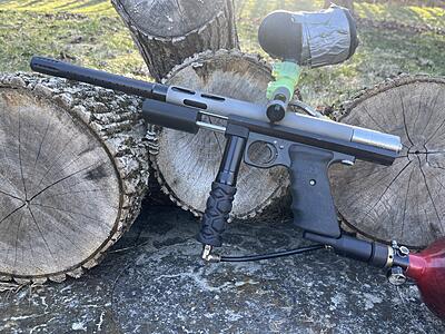

    Decided to try pump milling a classic rail this weekend and happy to say i did it right and got the pump mag shooting

        Always been curious about those! How hard is it to mill the rail?

          Wasn't too bad, really just comes down to having the right tooling to get the result you want. I used an old manual knee mill to make the cut. you have to angle the rail at 30 degrees for making the cut and a little over 3 inches into the cut you have to cut 2 angled ramps for the pump rod to hit and angle up onto the bolt to recock the mag. Cutting the straight channel isnt too hard, that ramp though was a pain, I found it easier to just use a dremel than trying to manipulate my mill/vise angles to try and cut it
