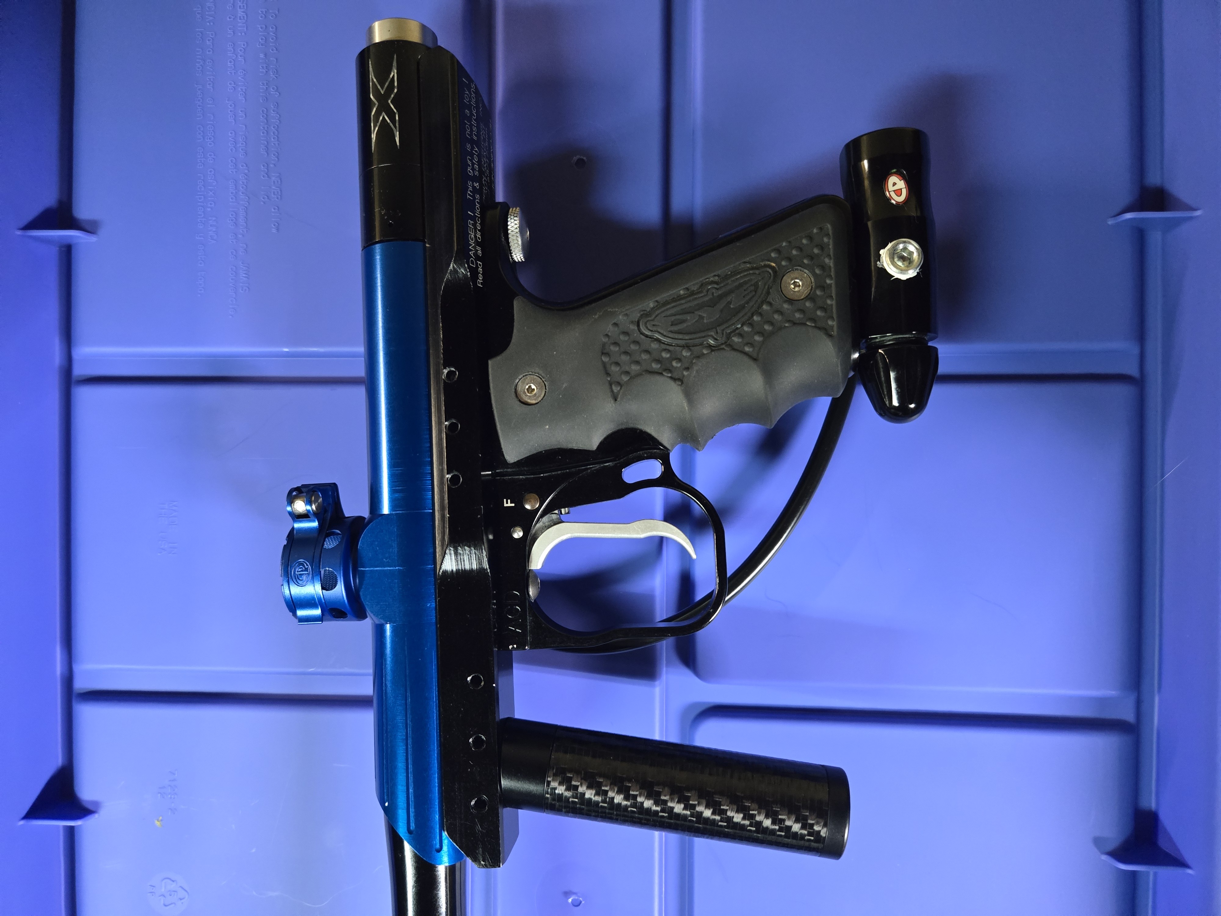

    I pulled my automag out of storage (15ish years) last summer and replaced all the orings. I have not been able to get it running right. How do you break in the orings. It has an RT on/off and level 10 bolt.

      Not shooting right.

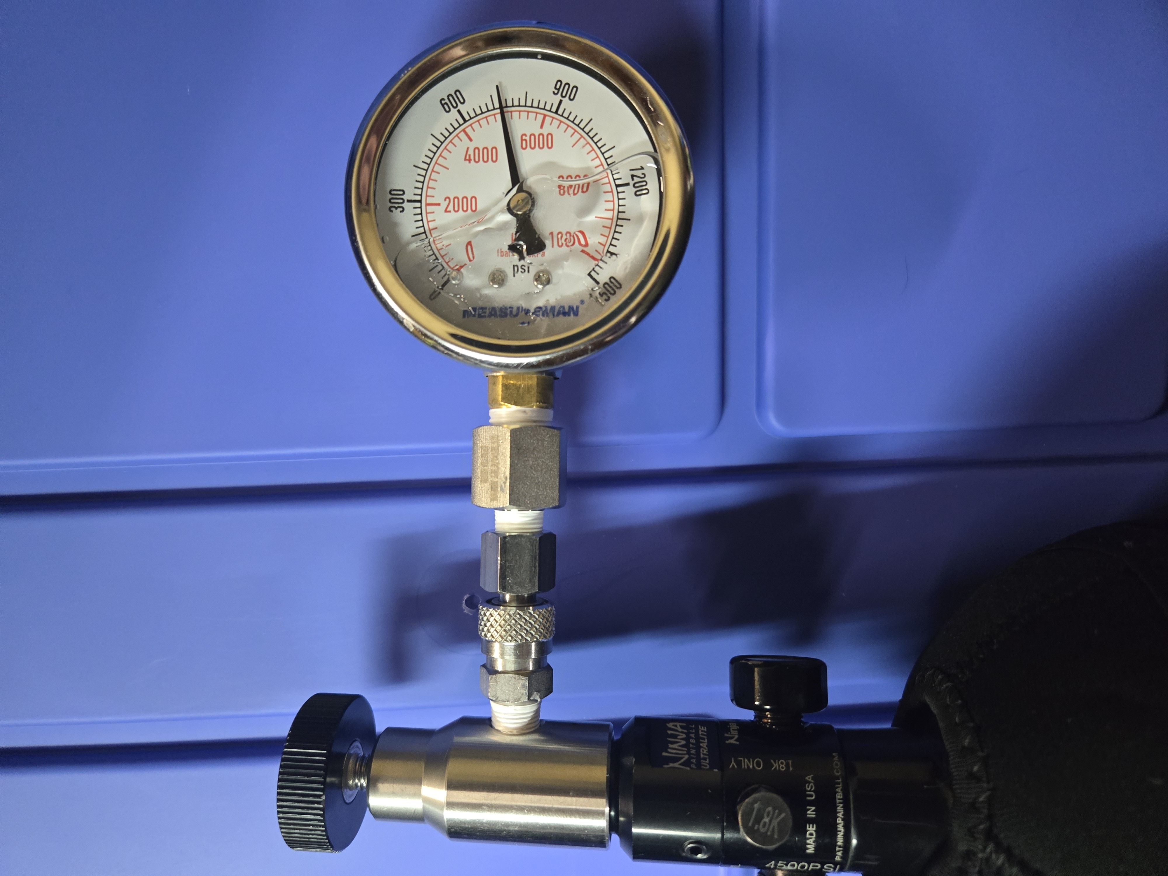

      This style gun obviously needs higher output tank pressure to run right, you need 700 minimum tank pressure, I run mine on 850 which is the usual stock output pressure on a 68/4500 air tank. Do not use a CO2 tank, you will freeze the valve and it will not work right.

          I used the Hyper Flow 420 in the mid 2000s. I am using the Ninja right now. I have a regulator that is supposed to have an 1100PSI output but don't have access to an air compressor. Gun originally came with the ULT on/off and I am trying to get it to work with a new RT on/off. I have Luke's customs pneumag stuff I want to use when I get it working and have access to air. The trigger pin does not seem to be fully extending and I have to take it apart and push the on/off pin to get the valve out. It is telling me I can't upload an MP4 video.

            That's getting toward the low end of recommended tank output pressure, especially for new o-rings.

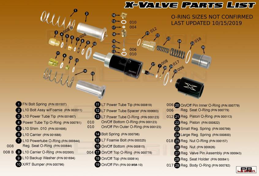

              On/off pin (not sure if this is what you're calling trigger pin). Decades ago, all my pins were .750" length. My more recent RT/X-Valve Mags were .740" and .745". You can sand the smaller diameter end to achieve the length you desire. However, this is NOT something I suggest you do until other things are tried. It effects trigger reactivity. I never cared about RT effect, but it can affect recharge rate if you've got issues with that. My opinion is the older stuff is better. The newer X-Valves just seem more finicky than RT and older X-Valves. You've got an old X-Valve but a new RT on/off, so a mix of old and new parts. When I was having trouble with recharge rate on a newer X-Valve, Tim at AGD told me the RT on/off body is supposed to be .627-.633" long/tall, so that's something you could check to make sure it's in spec.

              I took the valve back apart to look for issues and I replaced the #7 O-ring with the next size up and it seems to be working good now. Thank you to everyone who helped.
