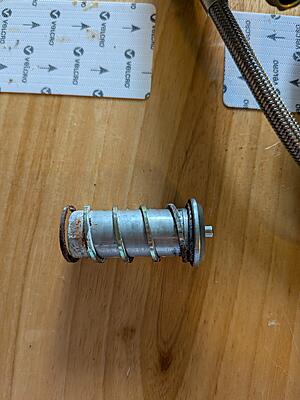

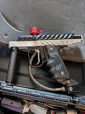

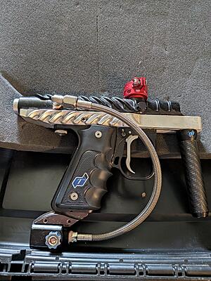

    My brother gave me a bunch of random paintball parts and in with it was this. What exactly do I have and what would it take to get up and running? There is some obvious rust on the bolt

    a few hour soak in Vinegar, and some 0000 steel wool, a good rinse, ( dunk in 99% ISO to removal all water, and air dry) then a polish, and some oiling will clean that bolt up for you, Also your brother is Awesome, That is a SWEEET Mag

      As far as what it is, looks like a custom automag with X valve and a deadlywind body and rail. Definitely a big come up, those are worth some $$$ now.

        XMT Ripper body and rail

            XMT Ripper body and rail, deadly winds carbon fiber foregrip, "xvalve" lasered xvalve with level 10 bolt, Intelliframe trigger frame, looks like a cp feedneck and a smart parts on off Asa and smartparts drop. The rail looks to be raw, I'd recommend you getting it anodized, your brother had good taste. Prolly around 1000-1500$ in parts. To get it running you can clean the bolt up and drop some oil in the Asa and see if it seals and or fires, more than likely an oring kit will get it up and running

            Probably around but not 100% on body and rail
            250 x-valve
            80 Deadlywinds foregrip
            125 Inteliframe
            4-500 XMT Ripper body and rail

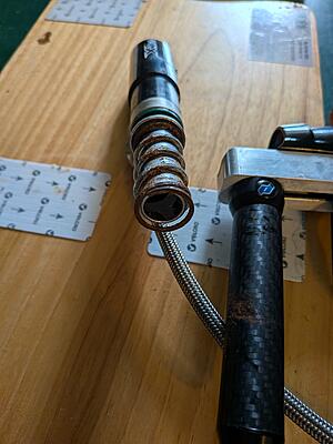

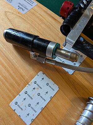

                          I have it broken down. It's in rough shape. Not sure what has happened to it but the firing chamber has something all in it. Where the bolt spring sits looks corroded. There is a washer and some sort of retaining ring where the spring sits too. I think I can replace that.
                          The orings in the valve look okay. The valve at the bottom feels a bit "gritty" but I'm think it just needs cleaned.
                          The shaft the bolt rides on has some pretty deep scratches. I don't think that will effect how it works.
                          I'm going to get a soft bottle brush and see what I can scrub out of the body. It might just be old paint.

                        Yes, inside the body (because it's aluminum) you'll see a retaining clip that holds a stainless steel cup. It keeps the spring from destroying the aluminum body. Those are replaceable but it might be fine.
