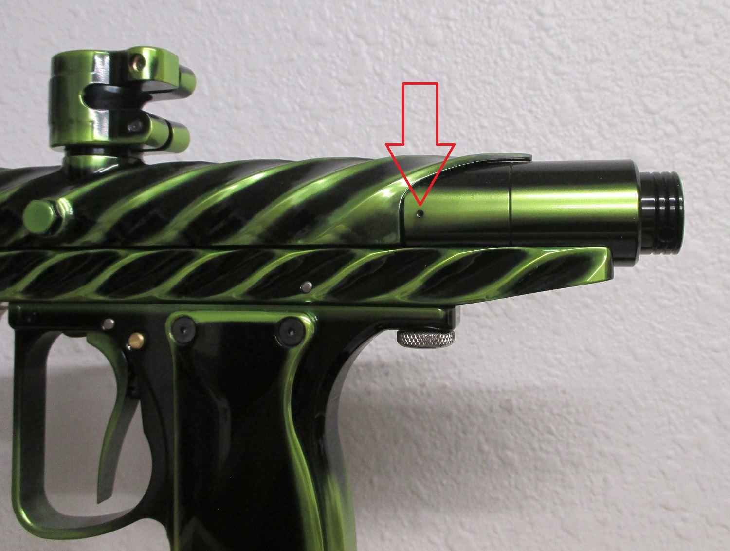

              Originally posted by William the Third
              With no air on the marker, hold the trigger back and air it up. Does it full-auto fire as soon as it's aired up? If so replace these two o-rings.
              If the regulator pin orings are bad it will vent air out the side hole
              IMG_8012.jpg >>
              • William the Third
                I do cocaine!
                • 1140
                • WNC
                IMG_8012.jpg >>
                I can confirm that it did not in fact leak from this hole. I couldn't tell you why in this one particular situation.

                • LukeAO
                  LukeAO commented
                  "it appeared that this particular marker was getting unregulated air from the tank (excluding the tank's reg, obviously)"
                  The X valve regulation isn't what you think, meaning the air feed to the valve is not regulated down as it enters the X valve. The chamber fills at the output pressure you're running from your tank, then the X valve regulator closes the air coming from your tank when it reaches operating pressure. Hope that makes sense.
                • William the Third
                  William the Third commented
                  LukeAO I hope this doesn't come off as sounding arrogant, but you would be incorrect in your assumption that I don't understand how regulation works on RT family valves. While I may have not realized that there was a vent hole between those two o-ring, for lack of ever needing to realize it (the though never even crossed my mind about where or why that hole went), or encountering a leak from there, and it not being shown in any diagrams I've looked at before. Like I stated, knowing that now, the reason there are two o-rings with a spacer fully makes sense.
                  Anyway, I do fully understand how regulation of input pressure differs between Classic family valves (and the majority of regulated markers) and RT family valves, and how that is used to create the RT effect (in extremely short, Classic: input goes reg, on/off, dump chamber, RT: input goes on/off, and then simultaneously reg/dump chamber). After all, it's pretty clear in the animation that I stole the frame from in the above picture how regulation works on RT family valves. Now I will admit I tend to be very verbose and detail oriented, often writing more than people are willing to read. I also tend to be poor at transferring my consciousness into a logical message. So I would understand if you started to drone out and didn't continue reading my previous message. The key points were that the first shot was crazy hot, and that any attempts to make adjustments of regulation, even to the point of basically backing out the adjustment screw to the point that input pressure should have been completely cut off, made no difference in the first shot velocity. The only way for all of these conditions to have been met would be if the dump chamber was being filled with unregulated input pressure. The most logical path, based on the diagram above, and not being aware of the vent hole, was those two o-rings. Knowing now about the vent hole, that obviously wasn't possible without an obvious leak (unless the vent hole was obstructed, incomplete, etc, which I confirmed that it wasn't). Now knowing this, it's obvious that the o-ring immediately to the left of the yellow circle, the one used as the reg seat, had obviously failed. If it hadn't, the first shot wouldn't have been crazy hot, and regulation adjustment would have made a difference in the first shot velocity, or even allowed the input pressure to be cutoff. After all, there are only two paths for input air to flow, and I now know one has a vent for this very reason. Anyway, as I stated, I'm not trying to come off as arrogant, and realize you're one of the foremost experts on AutoMags. I fully admit to not having a bunch of experience and knowledge with AutoMags. I actually appreciate the opportunity to learn something new, even if it was about a measly hole.
                • LukeAO
                  LukeAO commented
                  okay
