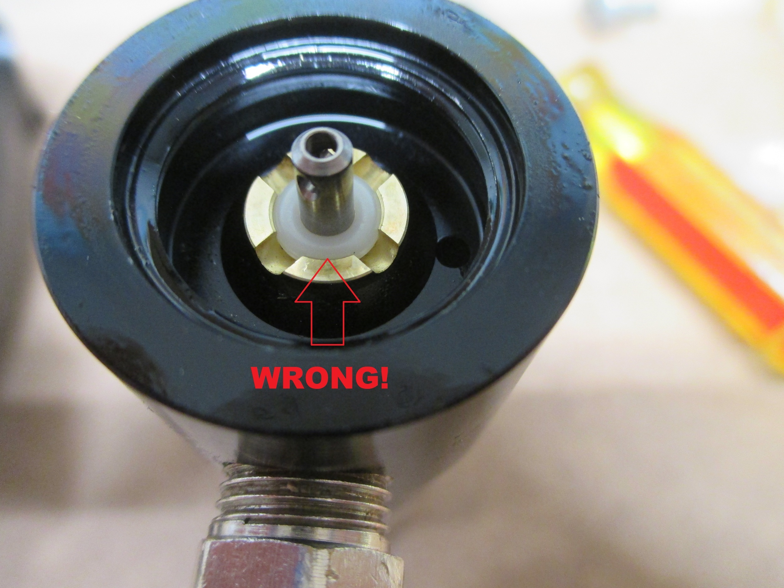

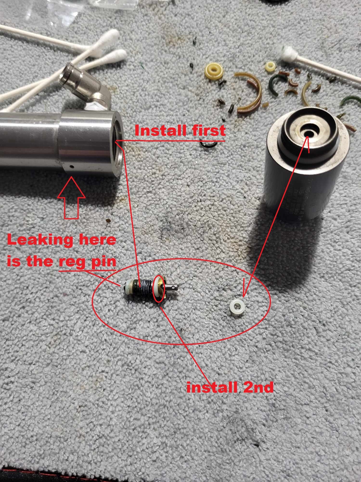

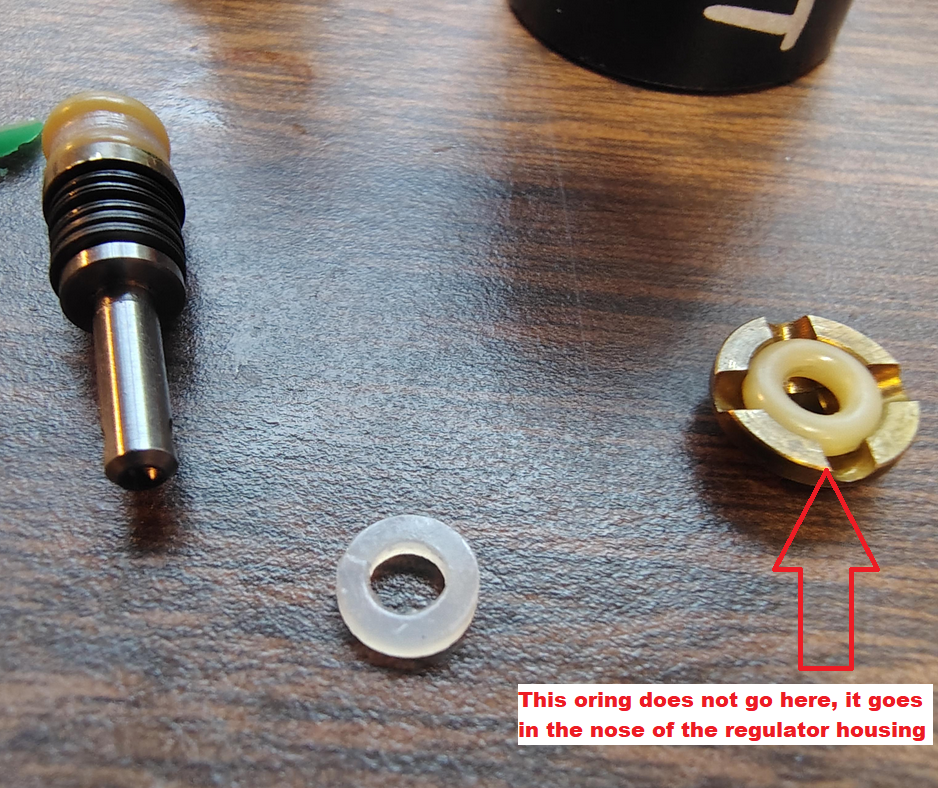

        This may help on reassembly
          • 6182
          Hmm, maybe I have an extra o ring in there then. I have that one you pointed out Luke in the brass there but then another in the regulator body.
          It's shooting, but it's shooting 375 with reball in a twist lock barrel and adjusting does nothing.
          Which way is that brass piece supposed to face?
