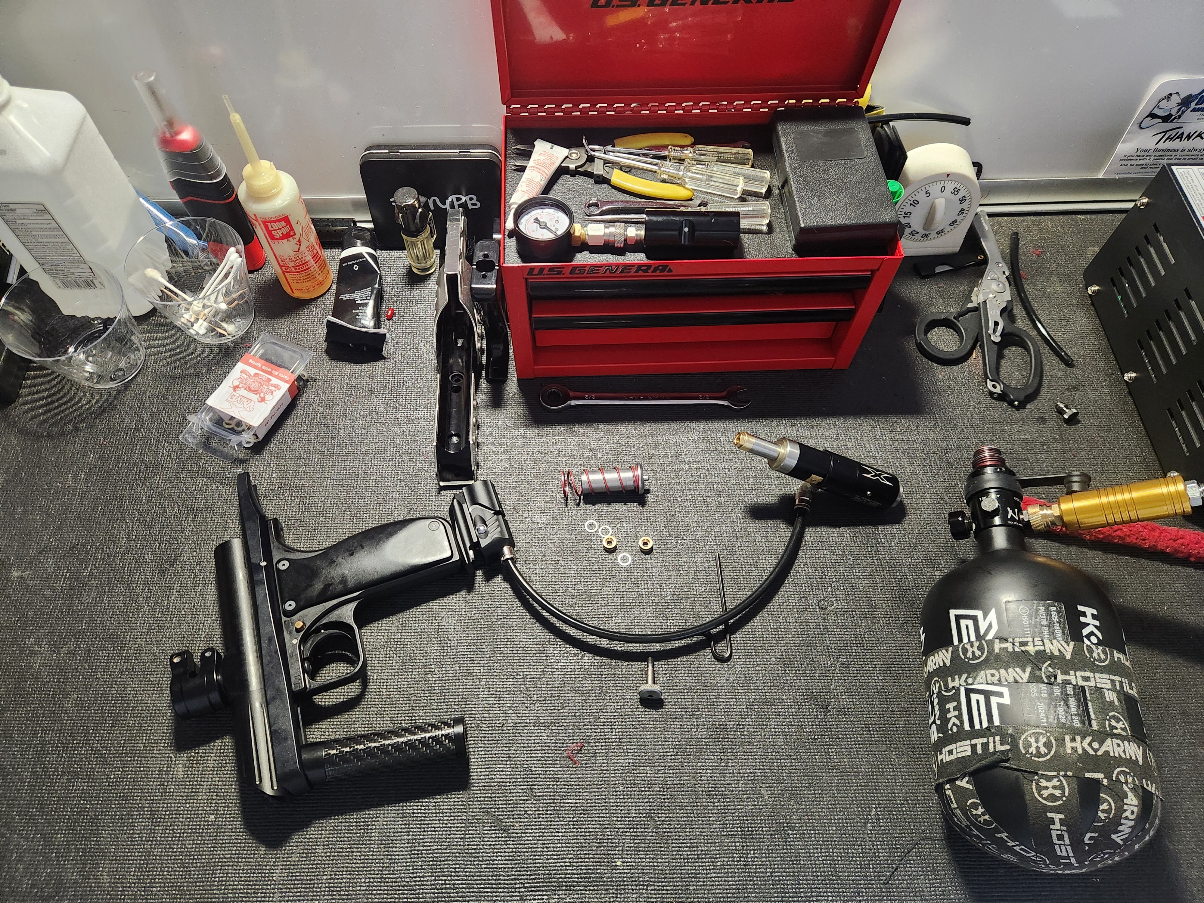

    Hello Everyone,
    Reaching out to you all because I cant fix this and maybe the frustration has gotten me...maybe its the the frustrations beers.
    I just tuned and played a few games 2 weeks ago with this all new, no used parts build. Was shooting 285, inconsistant but it was brand new.
    Went to use it today and it is firing once on air up, level 10 will not reset it just locks up or with the power of 1000 suns completes the cycle. Third issue is I have to be very gentle and delibrate with the trigger or she goes full auto, if I hold the trigger its auto .
    I have been cycling carriers. Inspected and replaced all orings on this new valve with less than a case of paint through it, have filled my tank 4 times now working my way through shims and carriers.
    Why the full auto tendancy? It is ULT.
    Why wont this bolt reset ot stop on paint?
    Why is it firing on air up?

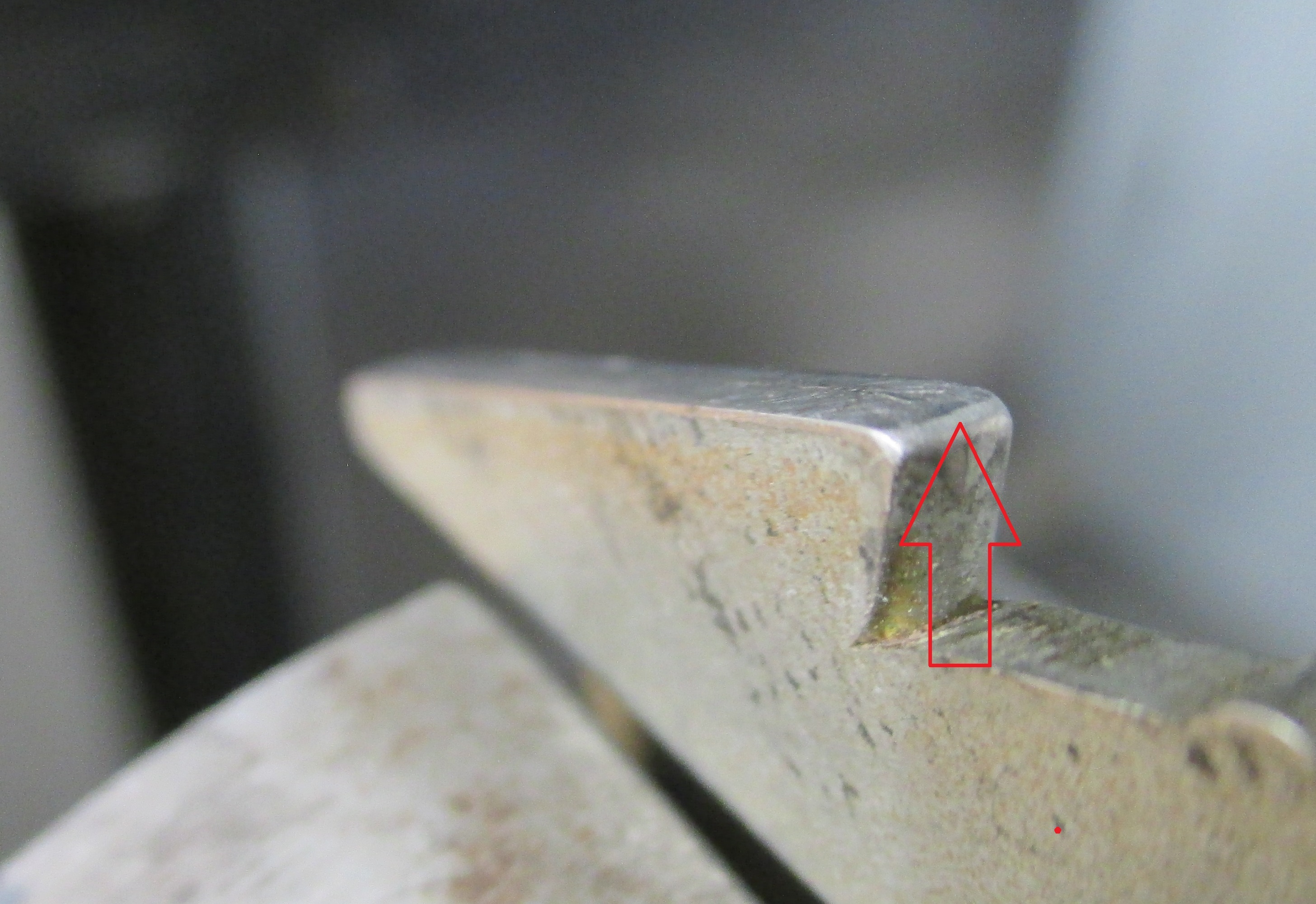

            I suggest you inspect your sear and bolt edge under magnification. The leading edge on the sear that catches the bolt should be sharp, not cut your finger sharp, but rather not smoothed over or chipped. Verify the same on the leading edge of the bolt. Here's a picture of a heavily worn sear. Click image for larger version
