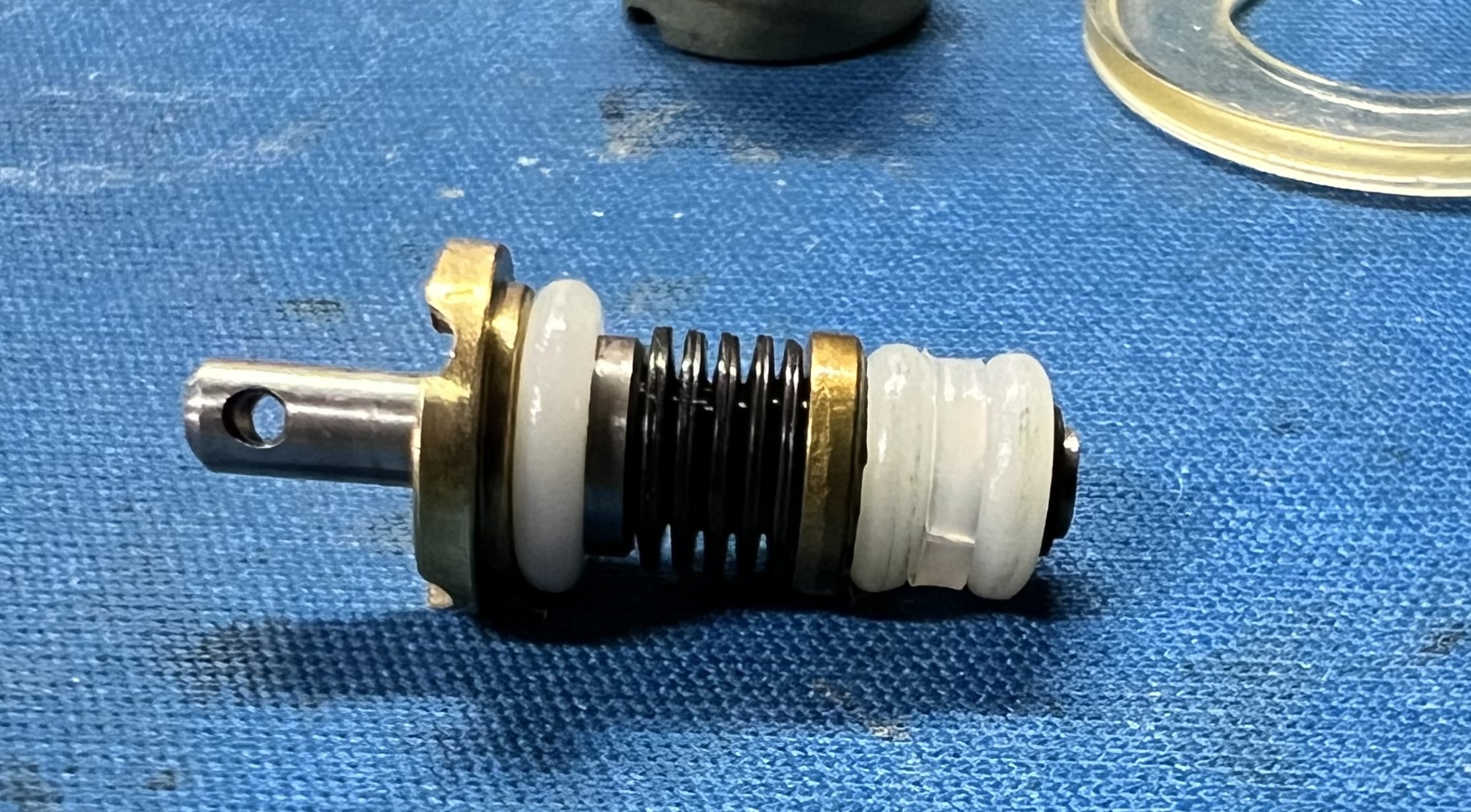

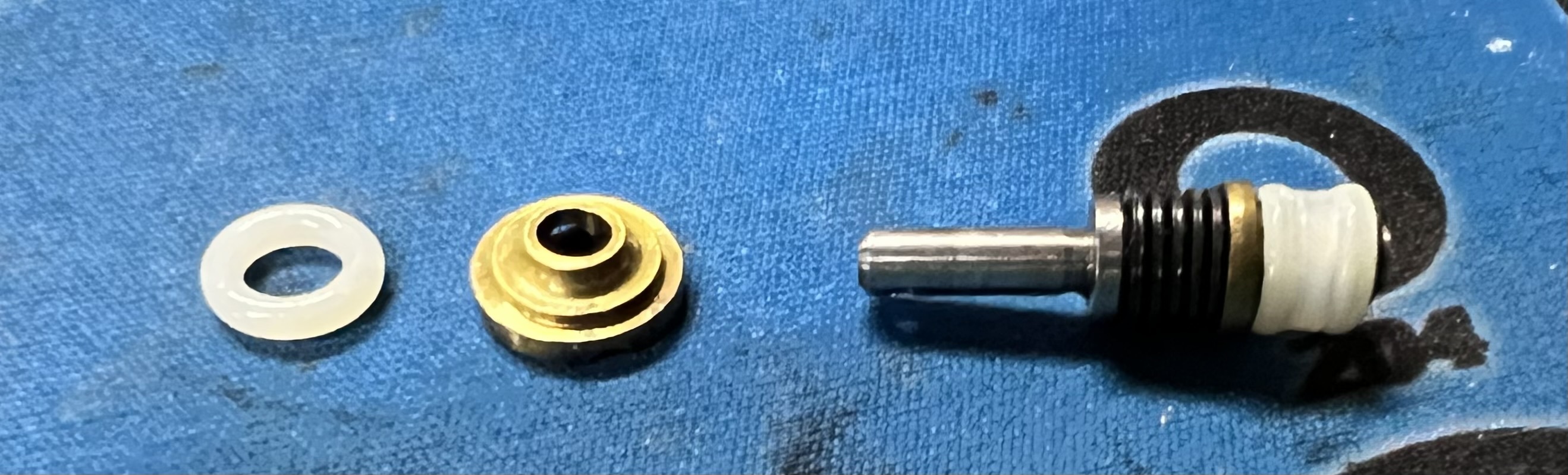

    Make sure the oring to the left in your reg pin pic actually fits over that brass piece. If it does not it is the wrong oring.

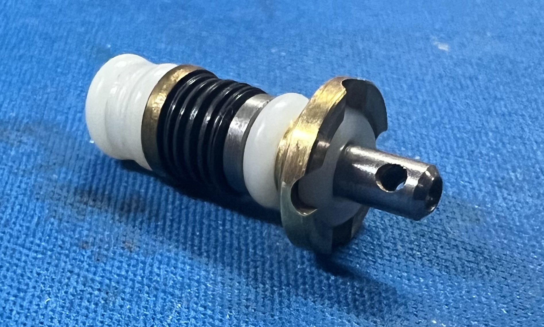

      Regulator valve pin is now placed and looks significantly better.
      I’ve also swapped the blue bumper from the Classic valve rebuilt kit with and clear one for the RT kit and replaced the spring.

        #18
          Cdn_Cuda commented
          Thank you, I will correct that!
        • 4472
        #19
        Alrighty, I’m continuing to blindly stumble along this mag rebuild, so thank you to those providing helpful tips! I’ve removed the oring and placed in what I believe is the nose of the reg housing. I really should learn what each piece is actually called….
        • LukeAO
          LukeAO commented
          That's it, you got it

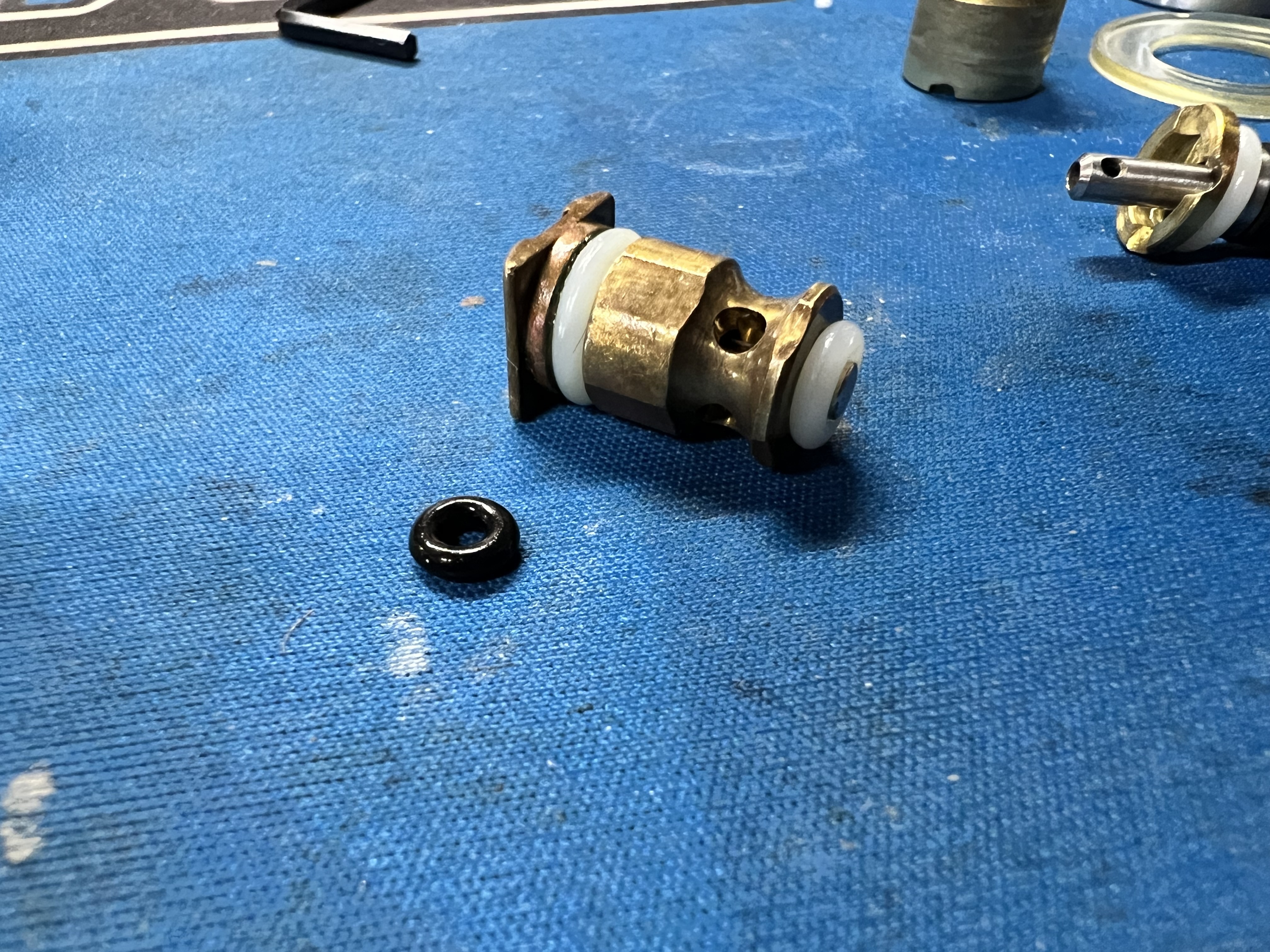

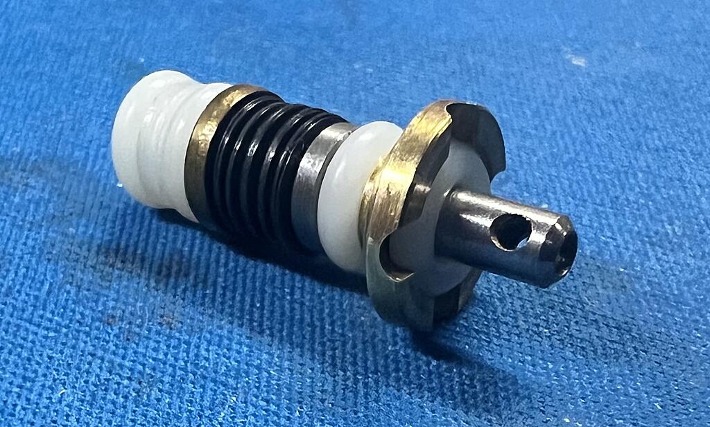

        Aired it up and…. Still leaks. Mostly out the rear of the reg but after pulling the trigger leaks worse. I believe I had not properly headed @superman’s suggestion and switched an oring that will fit around the bottom of the crown piece on the valve stem.
          • 4472
          #21
          One one more little o-ring swap:
          Moving the wrong o-ring on the valve pin and replacing it with the black o-ring on my on off.
          And success! Well mostly success. Still have a slight leak from the valve but marker seems to fire without issue. Thanks for all the help and hopefully my blind fumbling helps someone else in the future.

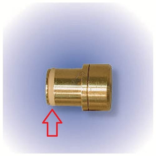

              You'll probably need a new reg piston too, I had to replace mine after rebuilding everything else in the valve. They like to cause leaks out the back of the adjuster.
              https://airgundesigns.shop/product/r...yle/#iLightbox[]/0
                Cdn_Cuda commented
                Nuts another cheap part that will cost me $100 by the time I get it. I assume it is the same part used in a classic mag? So I might be able to steal it from another mag?

              The valve is designed to leak from various areas to indicate where there's a problem, so where exactly is the air leaking from?
              No, the reg piston is not the same as a Classic.
              The reg piston is made to vent air out the back velocity adjuster when when the valve is over pressurized. The only reason you would need to replace it is if you are chronoed correctly and air is still venting out the adjuster.
              But dont forget that there is an oring that needs serviced on the reg piston, if its bad it will also leak.reg piston oring.jpg
