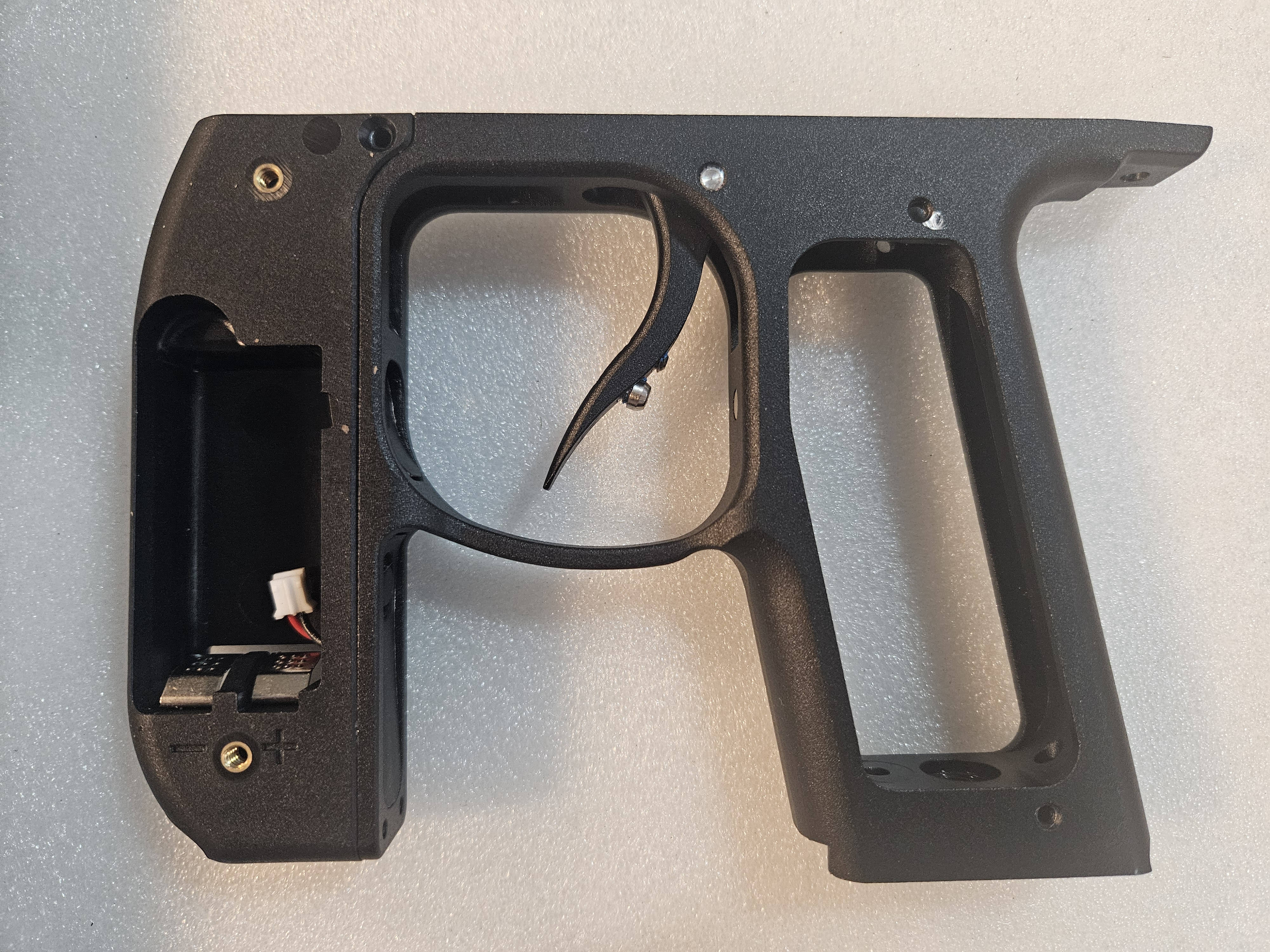

STEP 1: Strip the mini GS down to frame
Below is all we need from the GS, other than grips.
I was able to sell the rest off and offset much of my purchase cost - the ASA's are in demand for original MINI retrofit.

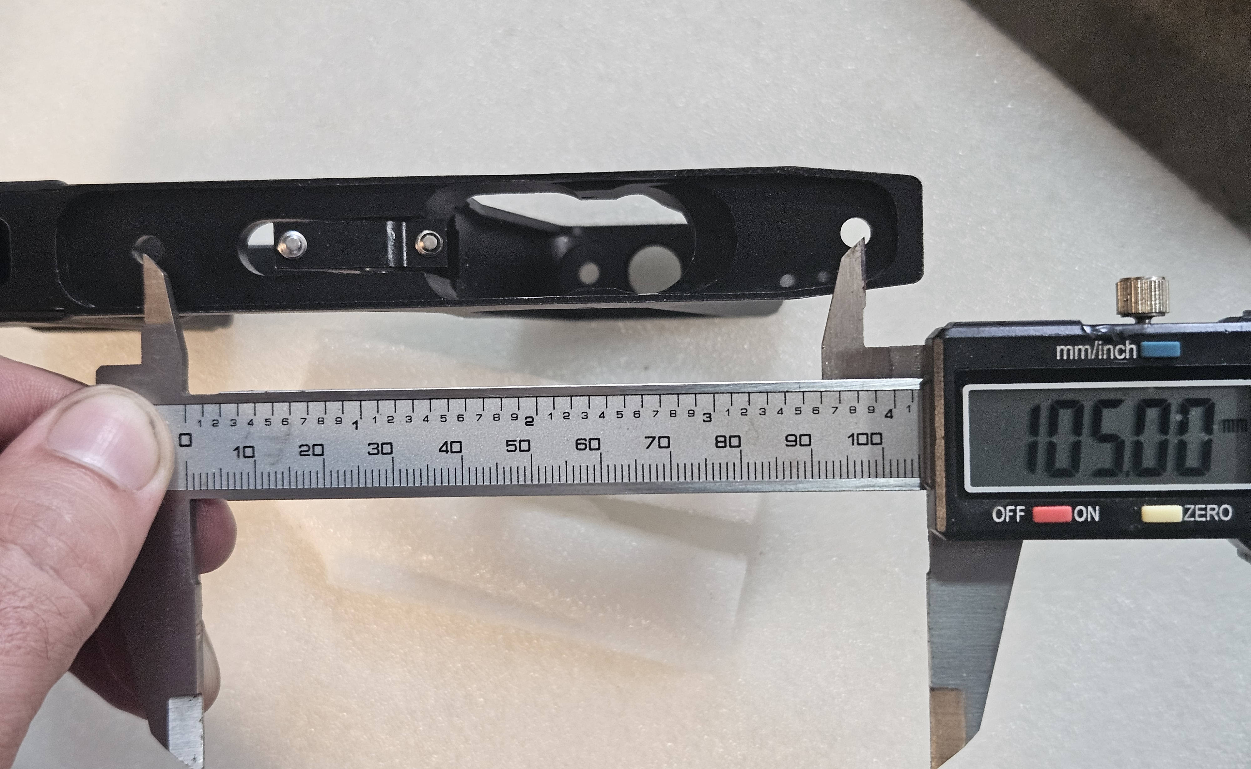

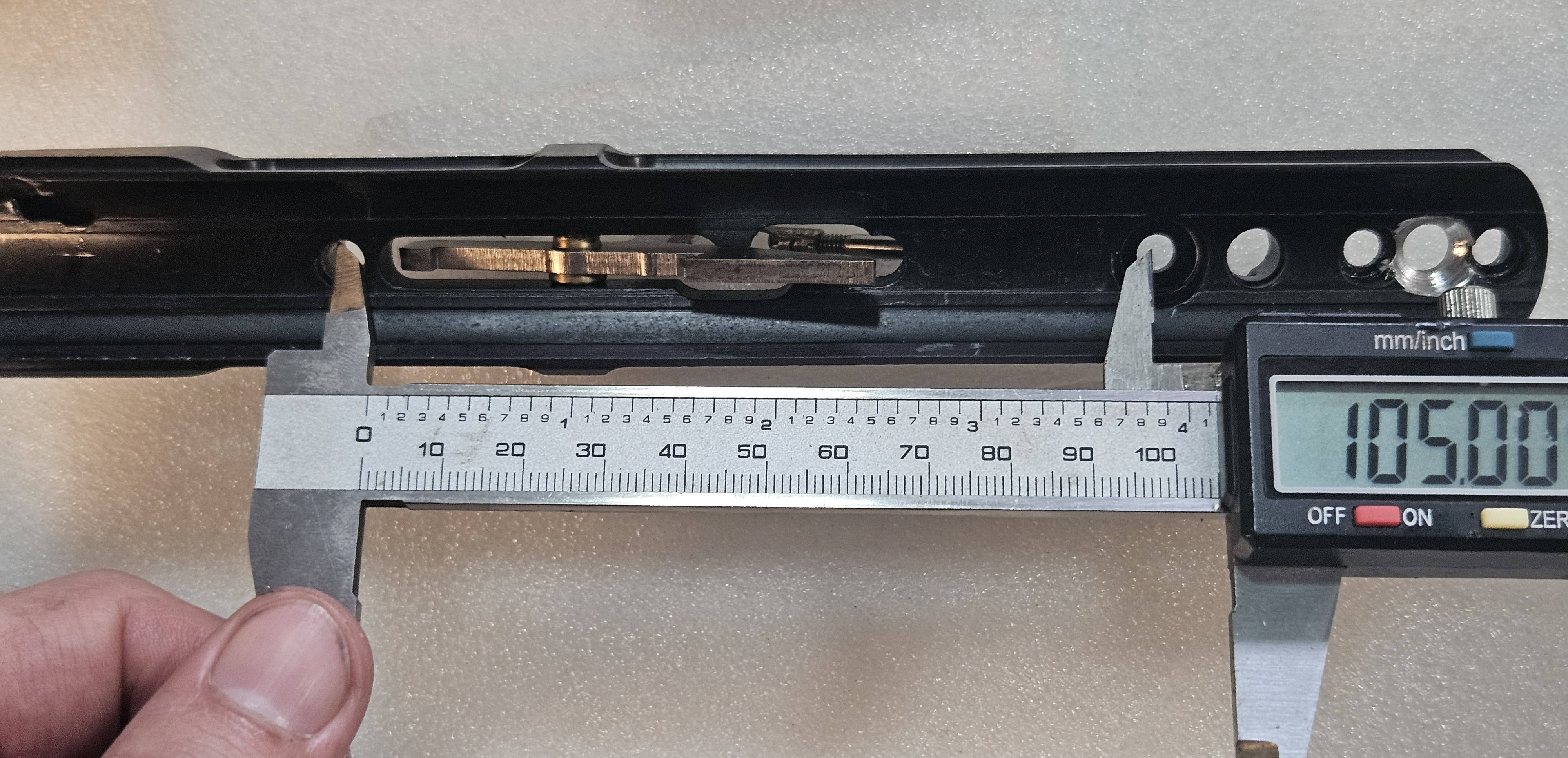

STEP 2: Open up the GS frame holes to accommodate AGD frame screw and rail bushing
The Mini GS screw holes are a match for AGD rail at 105MM spacing!
• The GS front screw hole will need to be opened slightly (3/16?) to accept a slightly larger screw for AGD body
• The GS rear screw hole will need to be opened up as well - if you're retaining the copper rail bushing it'll need to be a bit larger (1/4?)
Don't quote my drill bit sizes but I think those were right. Any sizeable bit set should have what you need. Take your time on this step - a loose frame fit can cause more problems than you might think for automag firing.

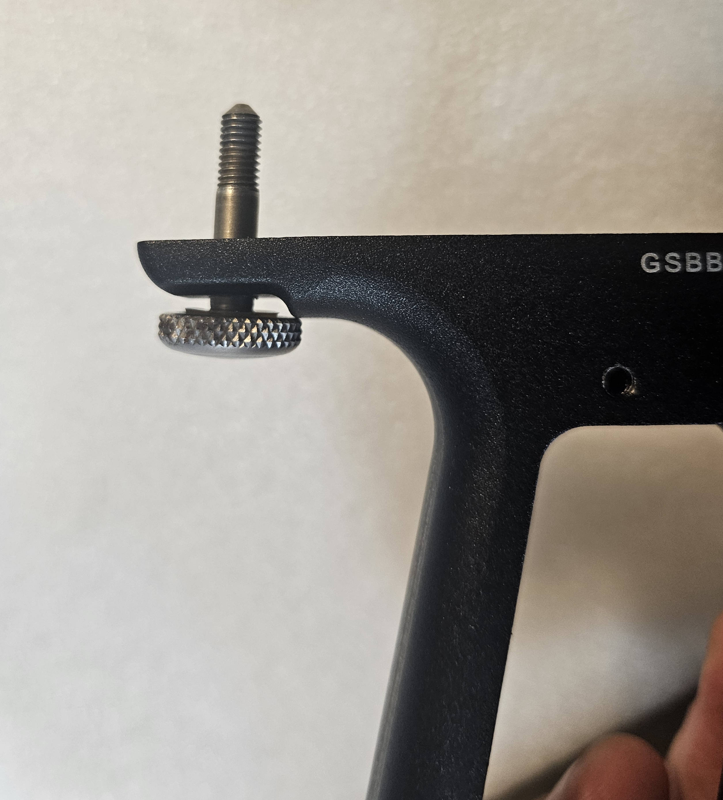

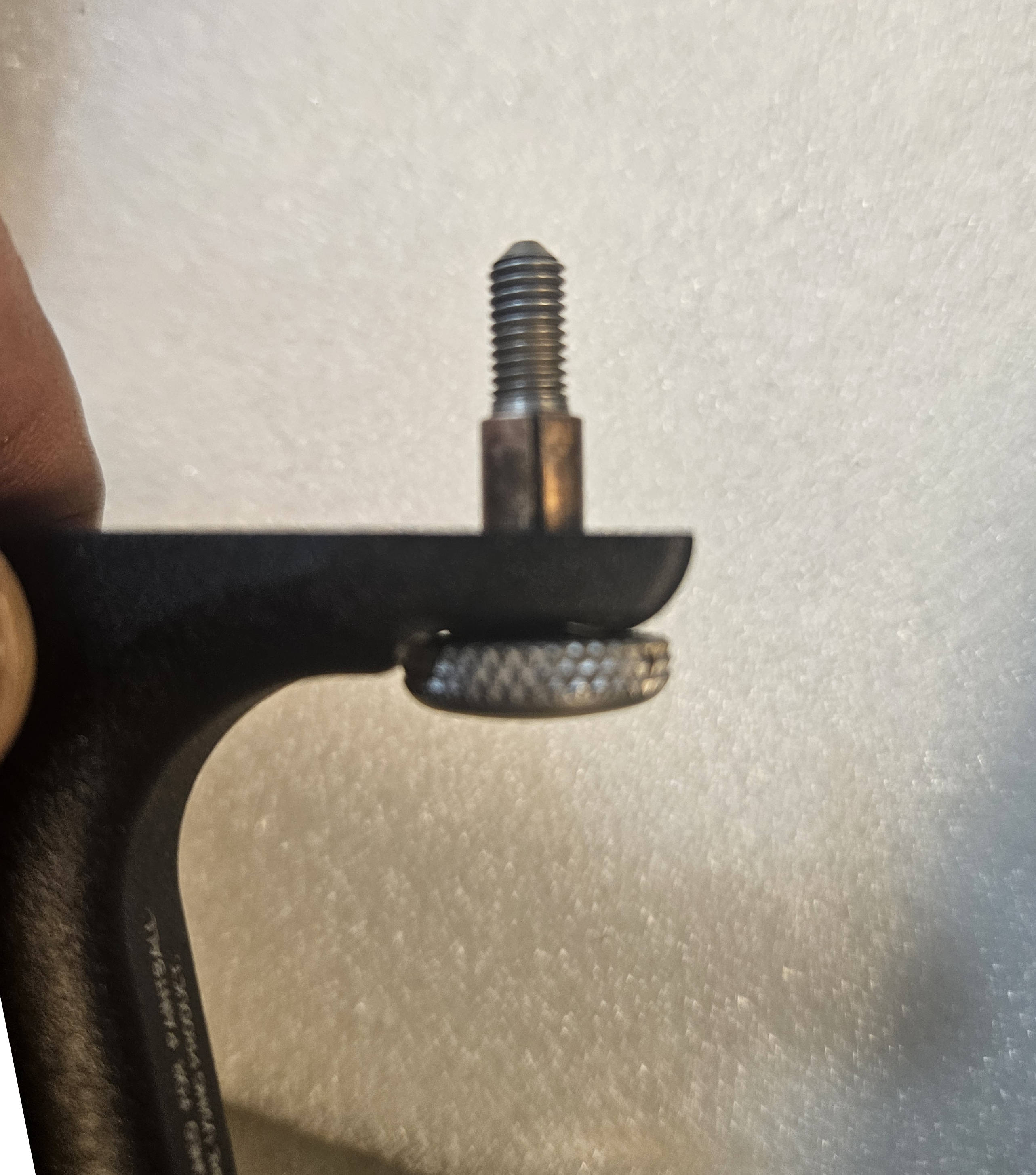

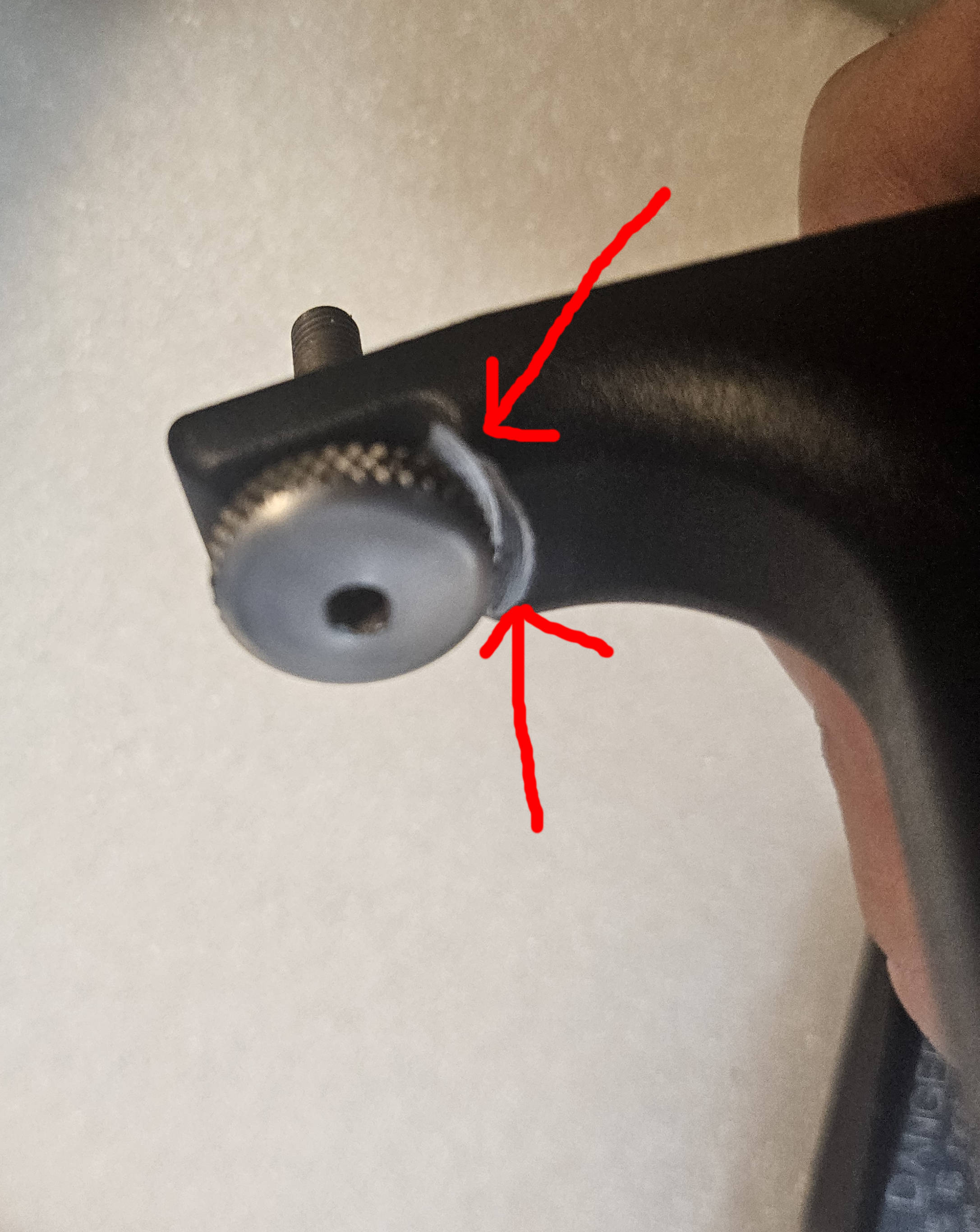

STEP 3: Radius cut the underside of GS rear screw frame to flatten, so as to accommodate field strip screw
This part is optional depending on your approach but is recommended - the field strip screw is designed to retain the valve and hardened to not to shear off inside from firing pressure.
I laid my frame flat and hogged it out a bit with a large wood boring bit (aluminum is fairly soft after all) Not work I'd brag about but it's passable.
Here you see "before" and "after"

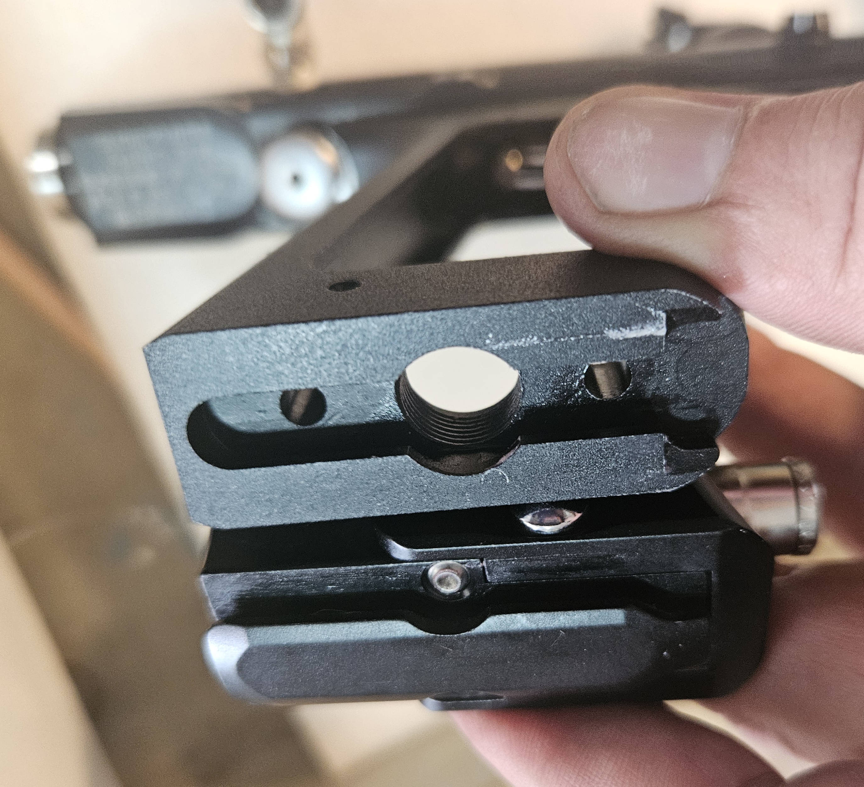

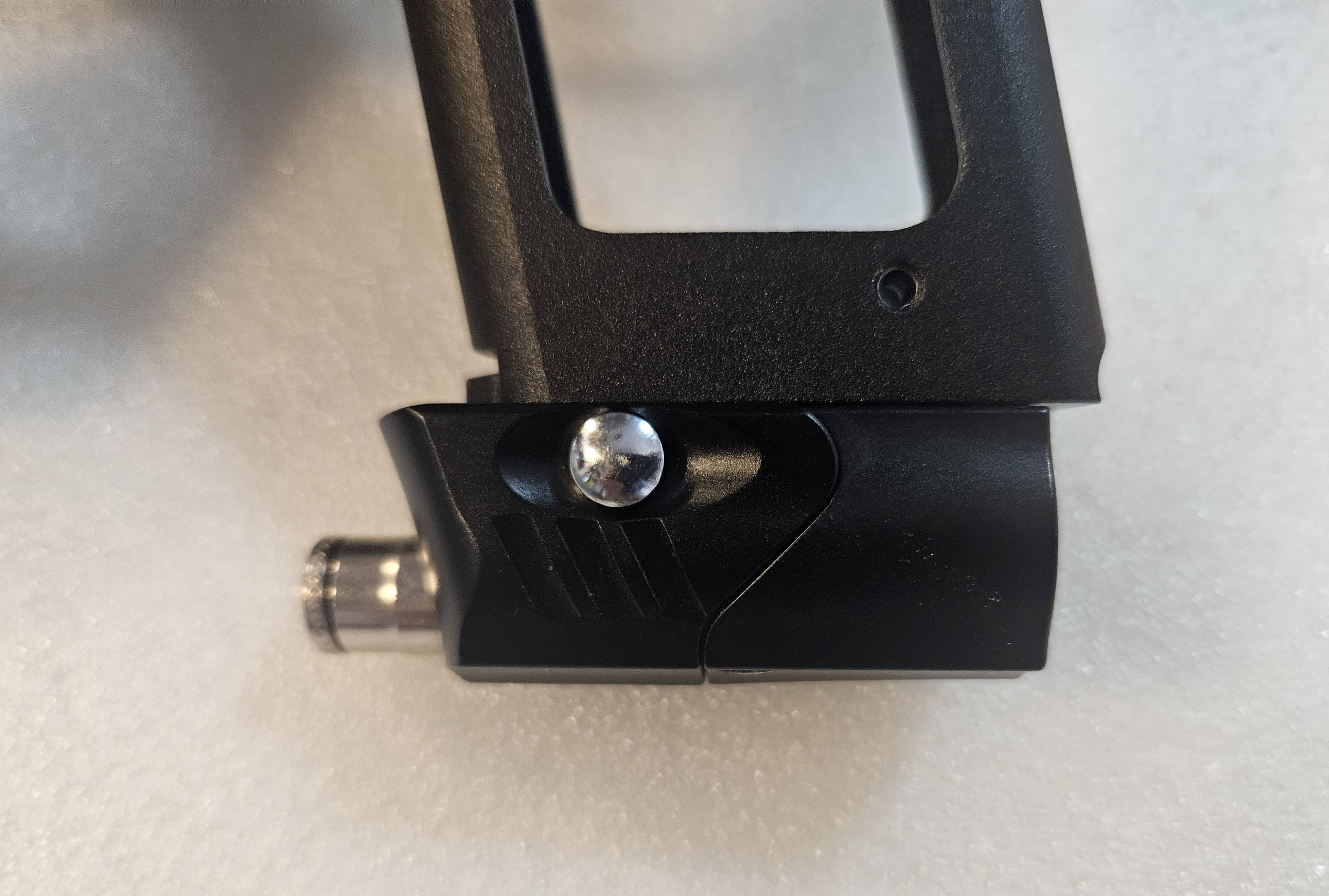

STEP 4: Fit an ASA
Mini GS is T-slotted and accepts Eclipse ASAs! It is however not a full-through slot. The simple solution if that bothers you is to cut 1/4 of t-rail off the back of your ASA. Optional, but nice for alignment. Here's the ASA before I cut the back for better fit.

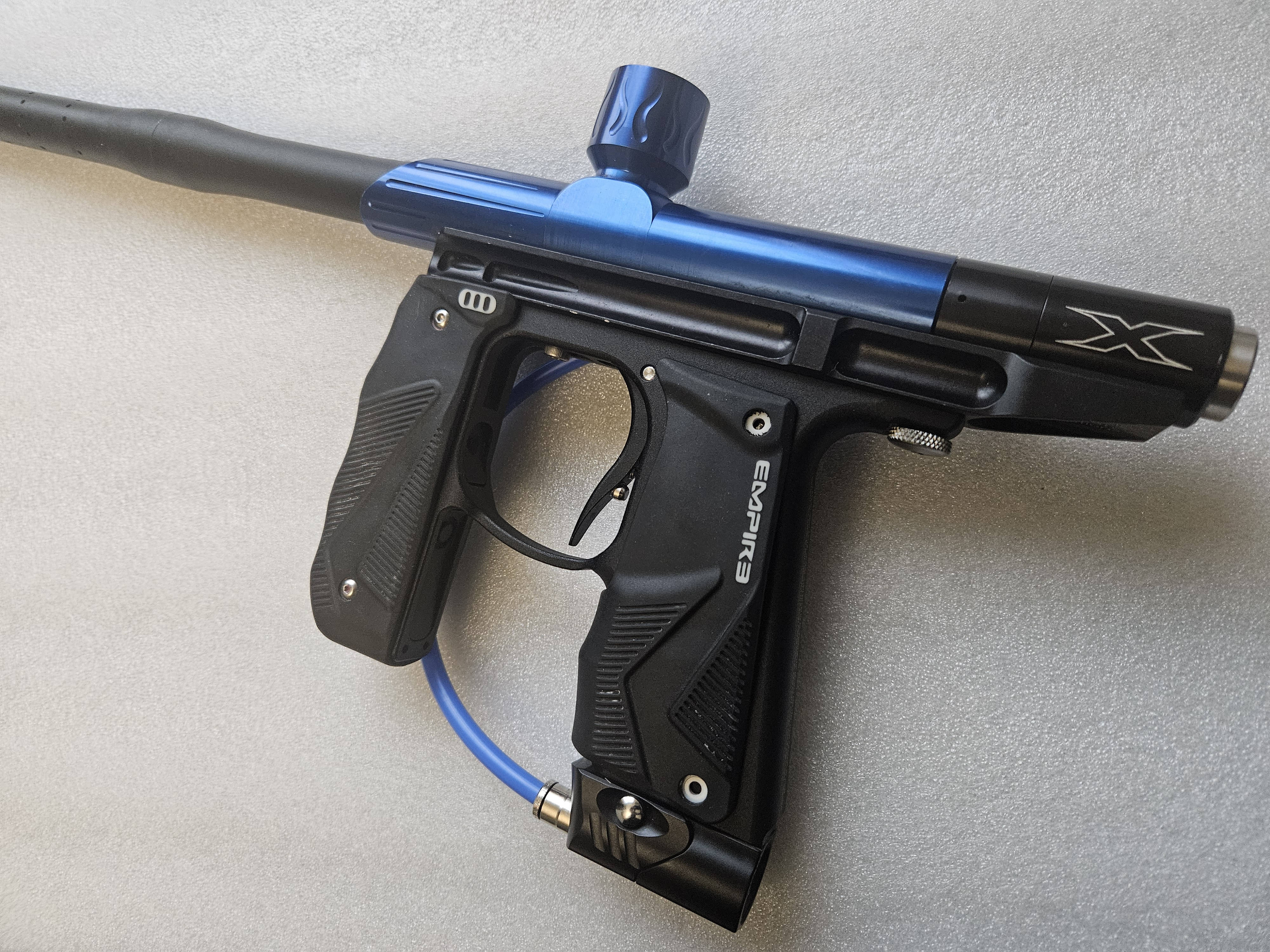

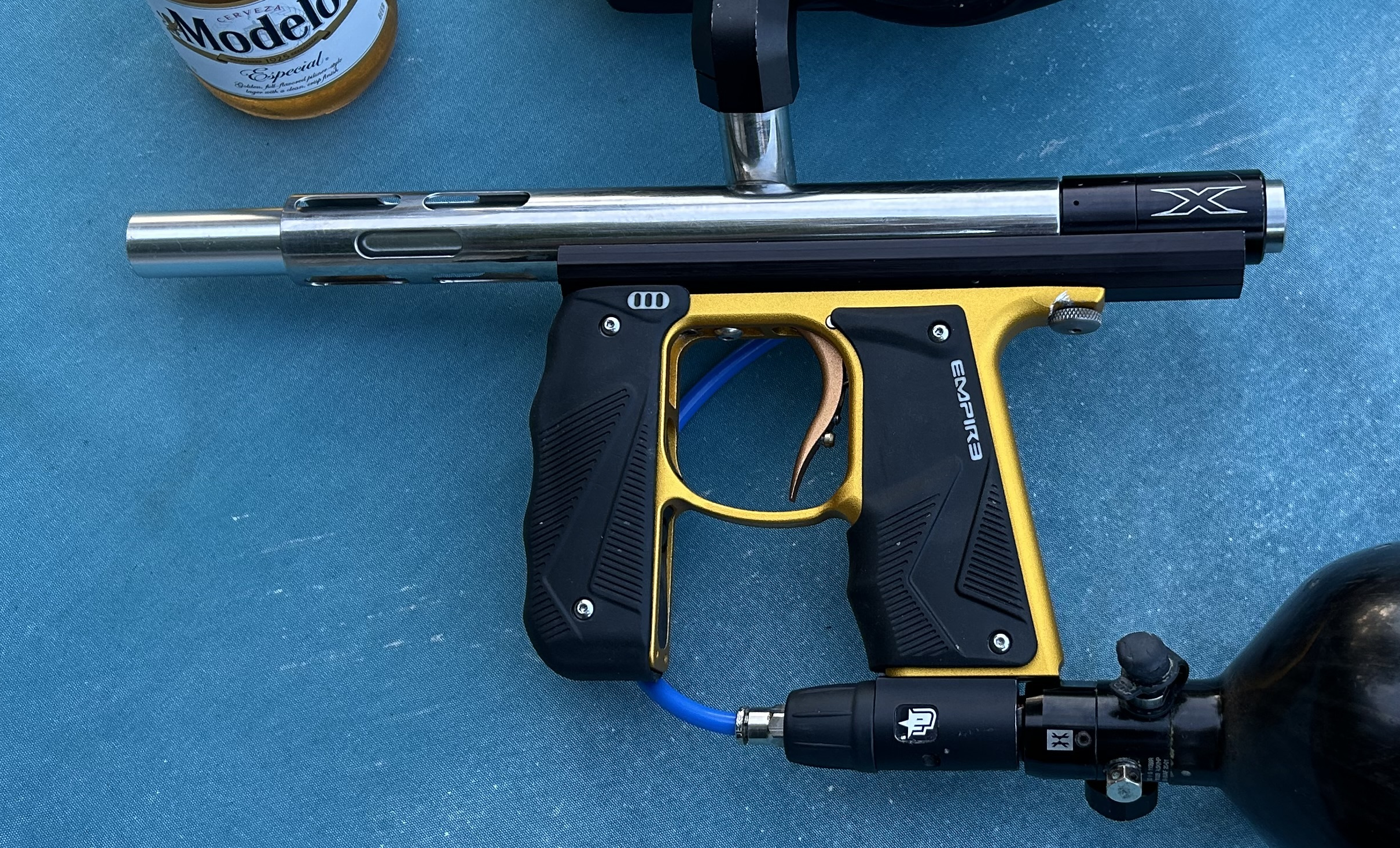

STEP 6: Final assembly
Get it assembled and get the GS trigger adjusted to suit, if you didn't in step6.
Here's my tester as she sits --- works, needs a bit of dialing as I'm getting bounce / "RT like" effect. Also Sliggity's in yellow
You may have noticed my cuts weren't showing bare aluminum --- I use a blackener, "chemical anodizing" more commonly seen in the 2A crowd. It's neat stuff but TOXIC. Do not take it lightly and use PPE if you try it.
