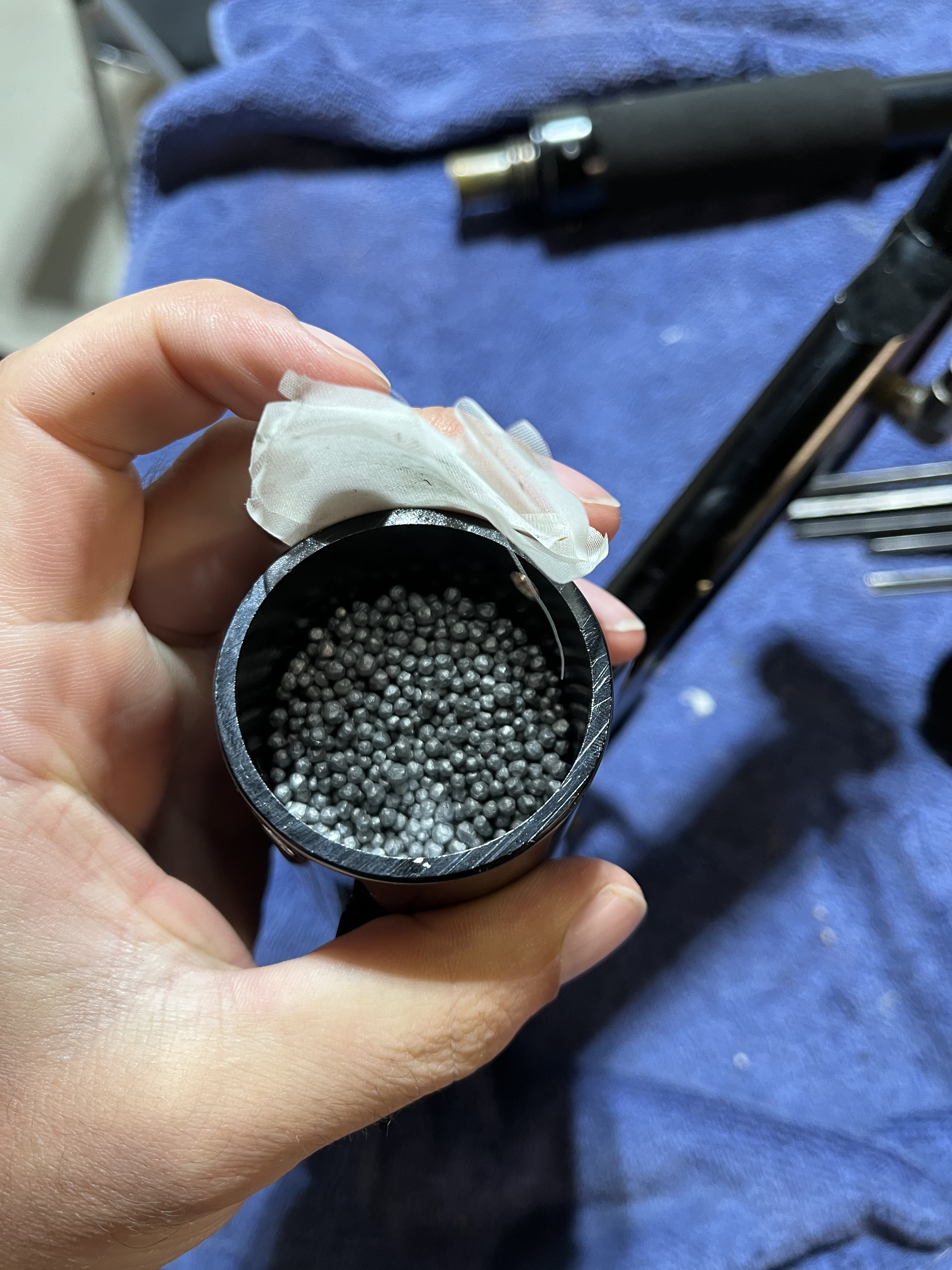

    Is the Supernova supposed to be full of BBs?
    I was about to list this as-is and noticed a rattling noise. I figured I should check it out and I’m more confused than when I started. What is this? Some sort of home brew devolumizer? Portable rain stick? Attack maraca?

      What do you think made the SuperNova so Super?
      Just joking.. the correct answer seem to be below this. Who knew???

        I’m gonna save a fistful for problematic cockers.

      It provides more surface area for liquid CO2 to turn gaseous.
      • autococker04
        autococker04 commented
        Ahhhh that makes a lot of sense. Very old school
        That’s fascinating

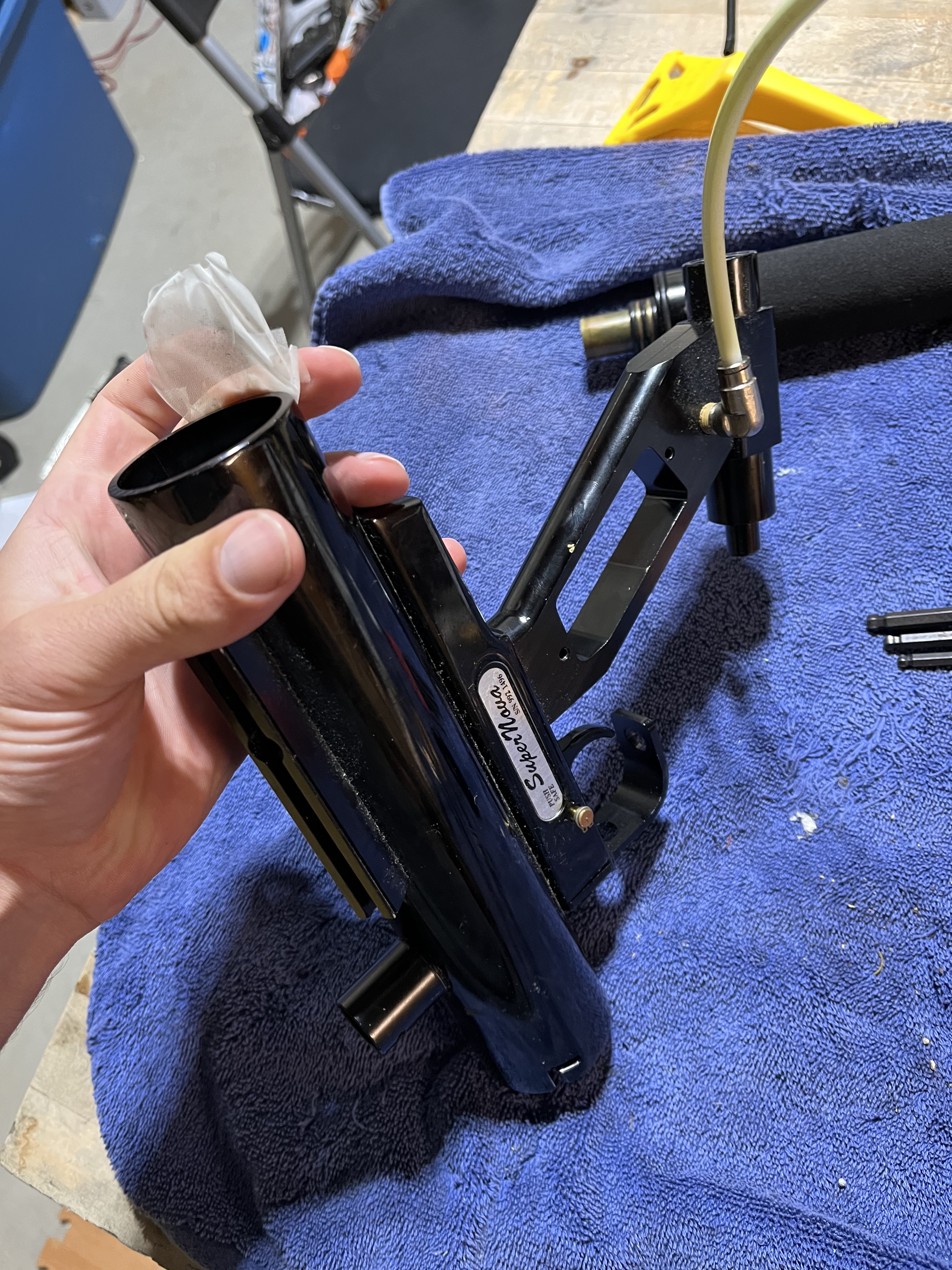

      Just aired it up and by some miracle, it cycles while leaking between the body and the trigger frame.

        They're called de-icer beads in Nova parlance. .. like Araphel said, meant to help control liquid.

          I completely forgot about the beads when I got mine in and popped the back off and they went everywhere!!!

                Never knew they had this, but I honestly might incorporate it into my 12g powered pump autococker somehow. If you turn a PPS 12gram Cart regulator upside down, you can end up filling the body with liquid co2 which makes it super hard to fire. Maybe this could help.

                The leak is likely from the over pressure piston oring. They can be a nightmare to get leak free sometimes.
