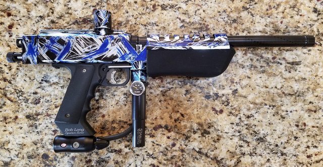

              This is the gun as it sits today. Under the shroud is a standard brass WGP ram & 3-way as well as a rock LPR.
              Click image for larger version  Name:	0O6cVZxl.jpg Views:	44 Size:	82.7 KB ID:	102336
              As for the valve, I already snagged one from you on eBay today - not so much as a performance upgrade, but as a maintenance item. The old one has been giving me trouble over the past few years, so I figured now would be as good a time as any and they're cheap.
              The spring kit is certainly on my radar too. At the rate I'm going here, the body, frame, and a few other things are going to be the only original parts left when I'm done.
