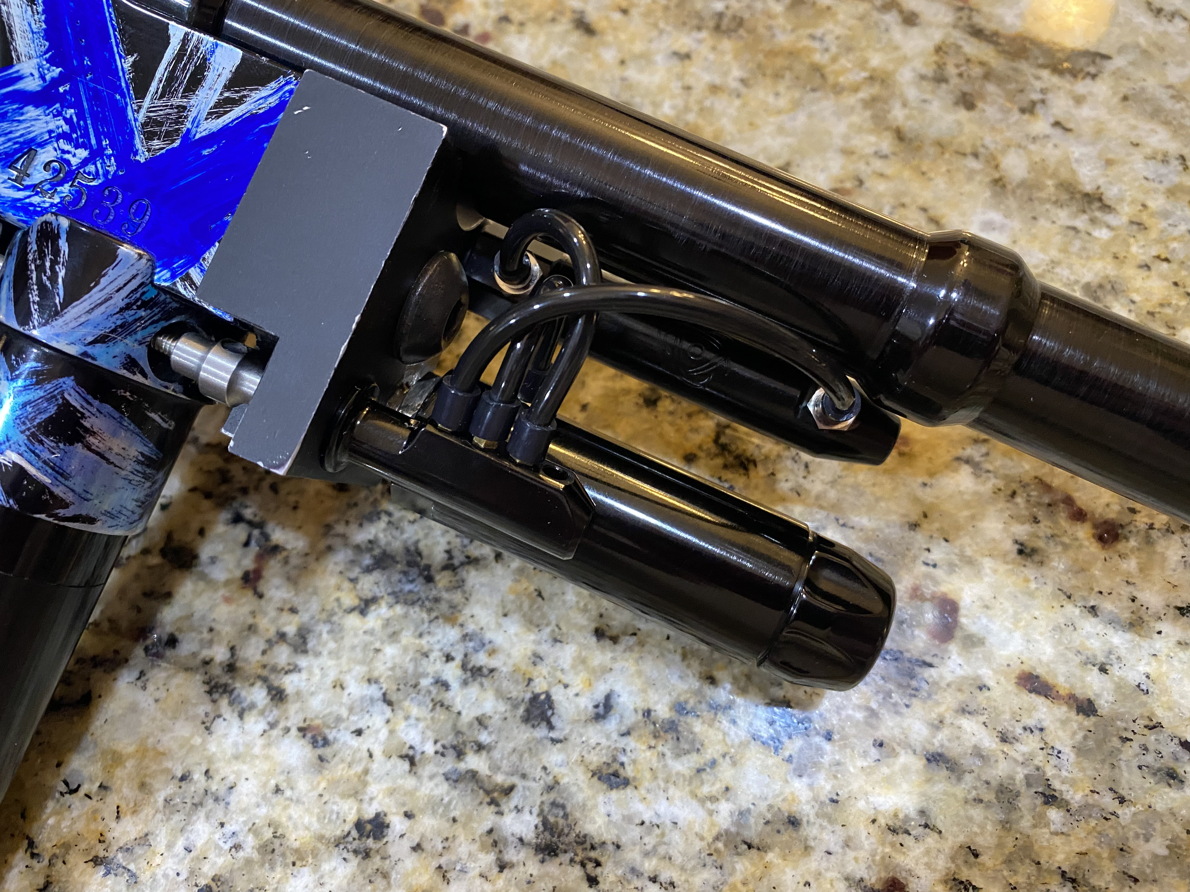

            The HPR arrived today and I got that installed. All I need now to complete the build is the new ASA. I’m glad I decided to take your advice and pick up a new duckbill. The position of the 45 fitting from the HPR would have made for an odd angle to the inline on/off I had used. The drop forward frame just made it weird. In the meantime, I installed an old side tapped duckbill and the angle for the macroline is perfect for the new ASA on the way (they still haven’t shipped it yet). I’ll hold off on the big reveal until everything is done. I think you guys are going to be surprised by the end result.

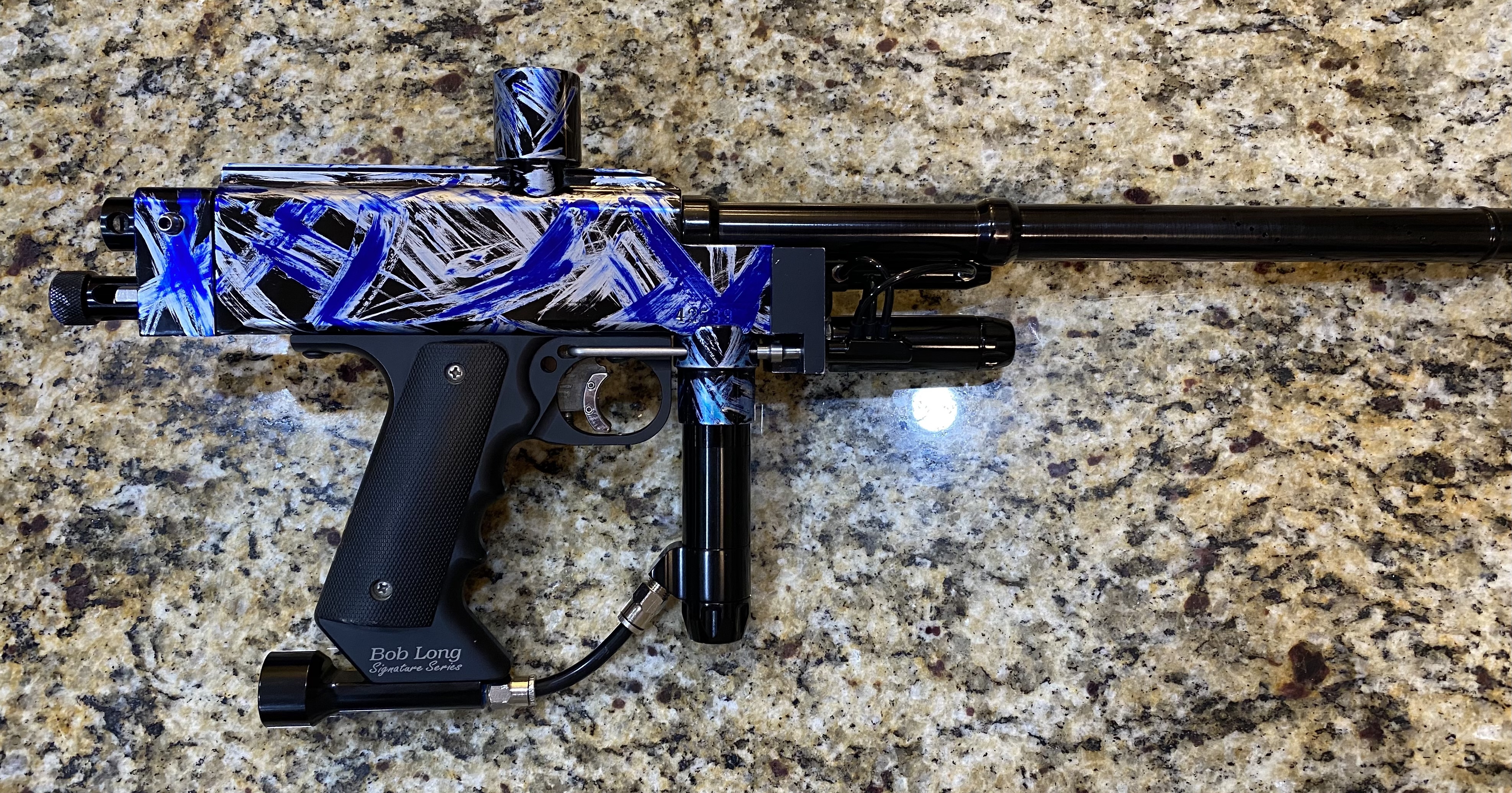

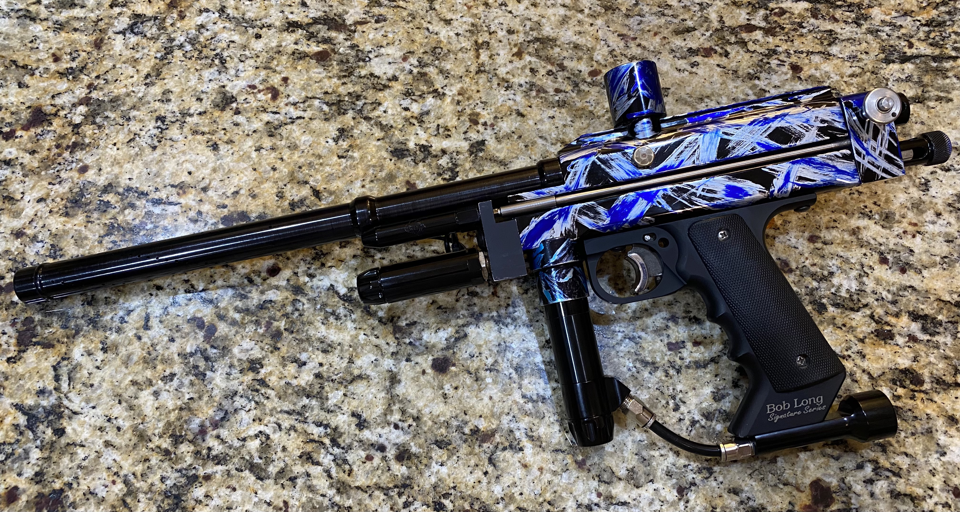

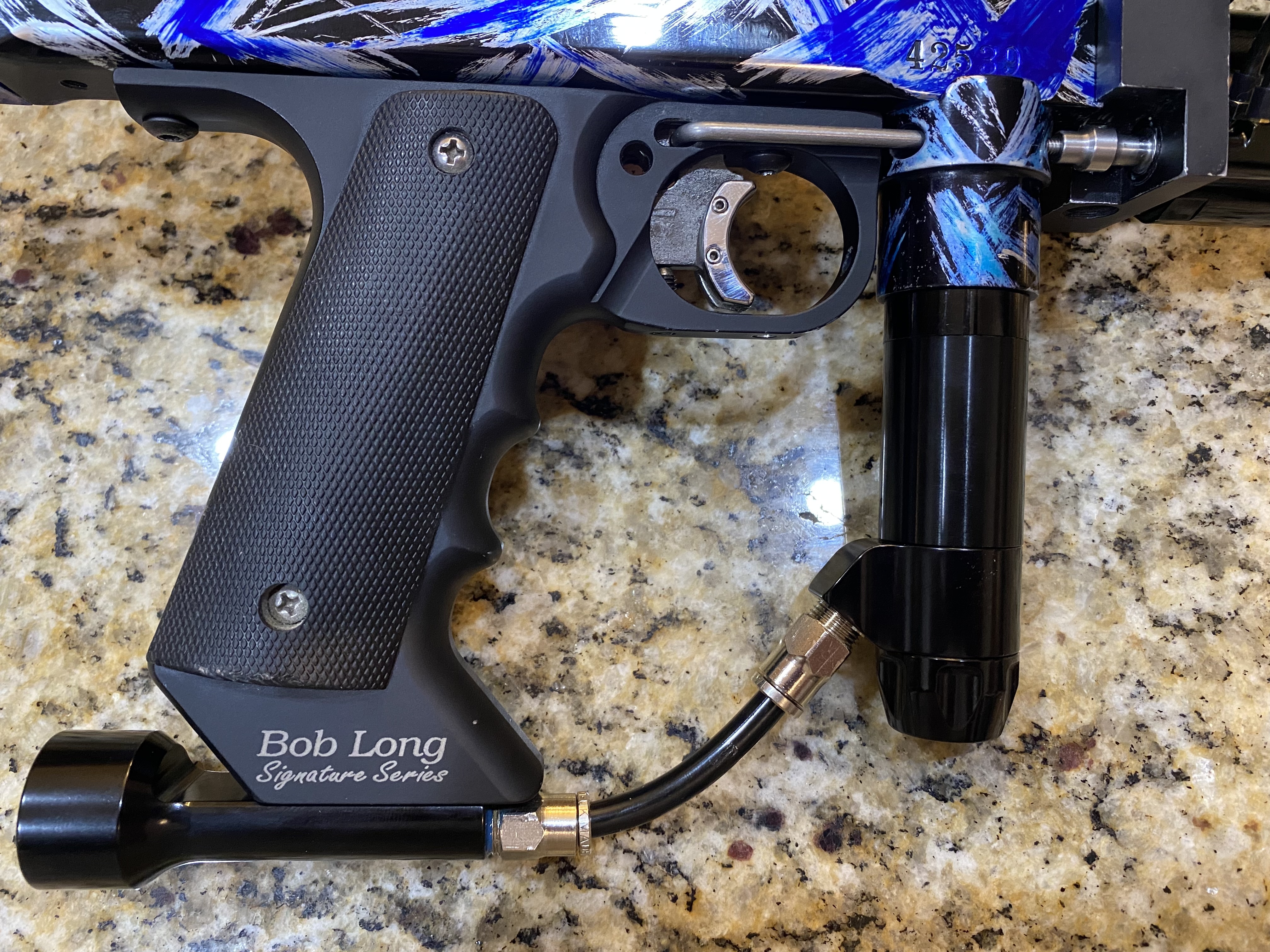

              The last piece of the puzzle arrived today. The gun has been tuned, timed, and it’s absolutely ripping. It actually feels thinner now and I feel like I have greater control over the gun without the gauge and fitting coming out of the HPR. I opted to not install the gauge in the front block simply because I could get a better grip on the HPR without it. In my opinion, this thing looks clean and handles so well. Anyway, enough of my rambling. Here is the end result.

              • Knuckle Dragger
                Knuckle Dragger commented
                That turned out really nice!
              • OpusX
                OpusX commented
                Very clean and unassuming. Well done restomod that will keep this thing ripping with the best of them.
